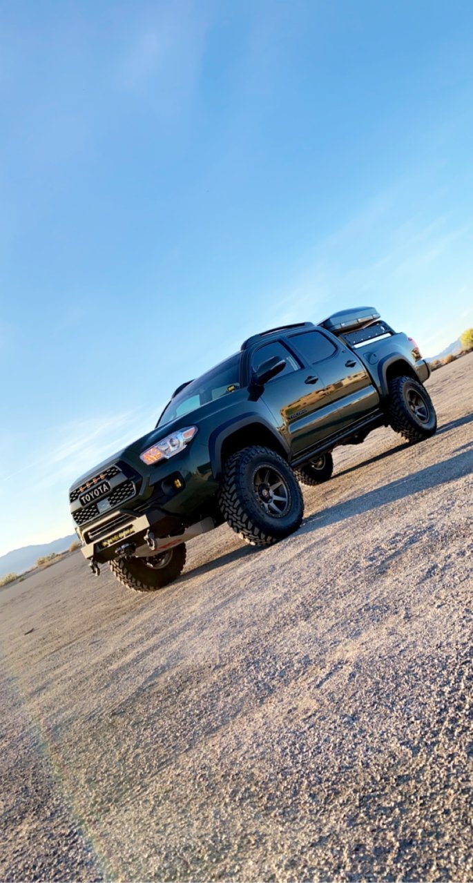

    i don't unfortunately, but the dealer did give me a stock one to drive and that one did not do what my truck was doing so now they gave me their demo truck to drive as a loaner which is similar to mine and it also doesn't act like mine does on the highway, i will attach picture of demo truck they are having me drive in mean time
