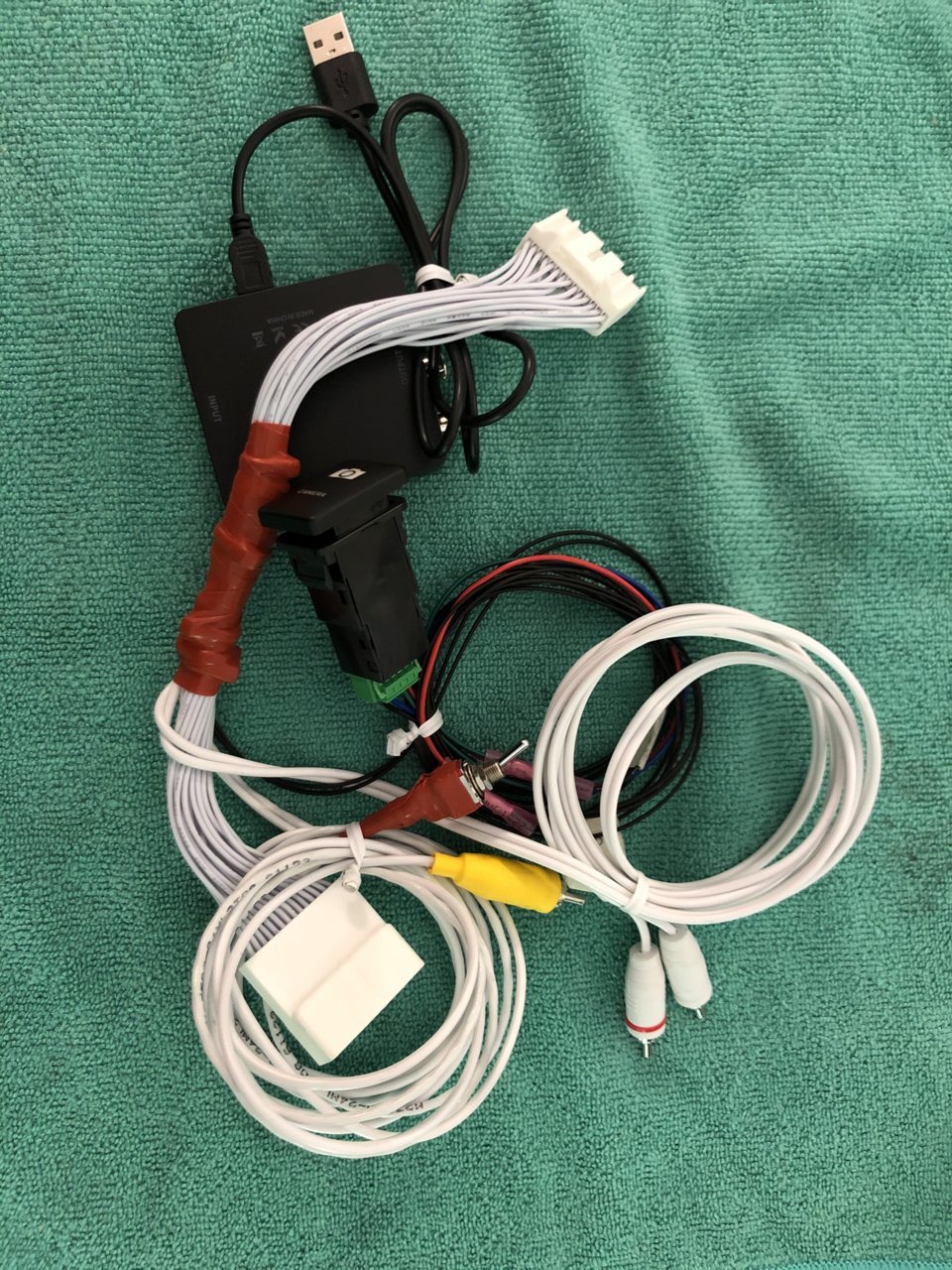

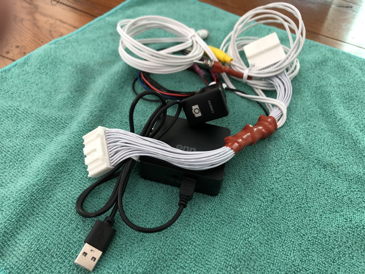

    I have a harness for sale for 16-19 model Tacoma’s!
    HAI’s cable Assy. This harness is a complete plug and play, no need to cut, splice etc. The harness will allow you to mirror your phone to the head unit. I’m including a camera switch and a HDMI to AV adapter which is compatible with Amazon Firestick, Roku, Chromecast and plays while in motion. For further information click the link below. *Please note, that this will only work for year 16-19 Tacoma’s. This cable is no longer available for sale. Asking $150 and free shipping!
    https://www.tacomaworld.com/threads...e-navigation-override-smartphone-mirr.501617/
    If any questions, please ask!

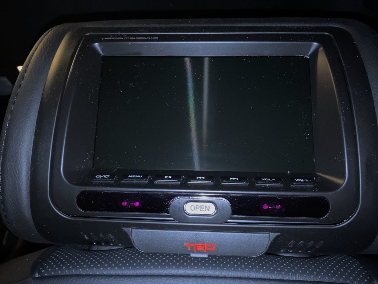

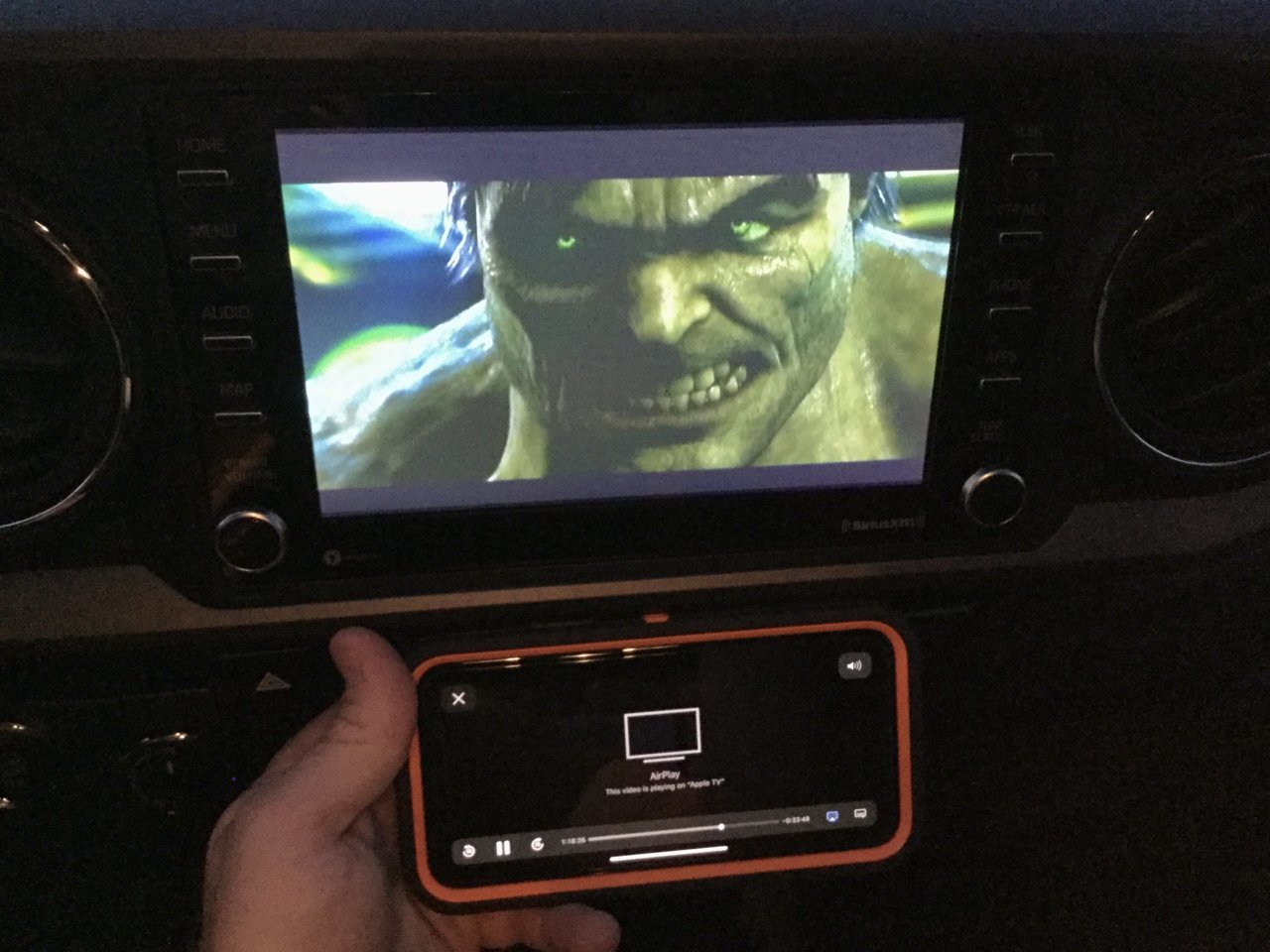

    I actually did this a week or so ago using an AppleTV, a power inverter, FM transmitter, and a Germes camera controller with a 2 way AV switcher. Worked out pretty well. Just sucks that Apple limits what you can airplay to an AppleTV using the offline peer to peer connection method. Still worth the effort though as I can airplay any of my Apple iTunes movies that are downloaded to my phone and I can stream crackle movies without issue.
    I’ve also been debating on splitting the signal going from the dvd headrests so I can play DVDs to the head unit as well, but don’t know if it’s worth the effort.2C0BB4AF-C1B8-4C9B-85CC-7C2EA7461970.jpg
