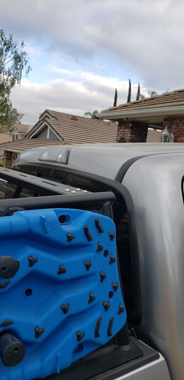

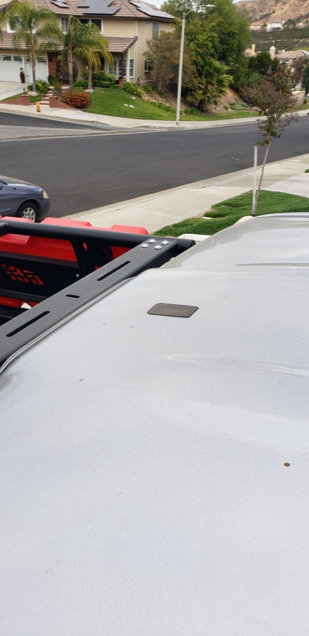

    relocate the antenna inside put roof tape on the hole and install whatever roof rack you want.

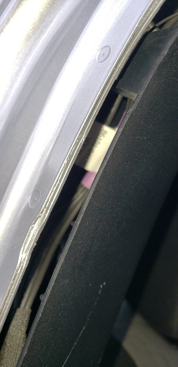

    Tucked the shark fin in the pillar, fits without the plastic shell.

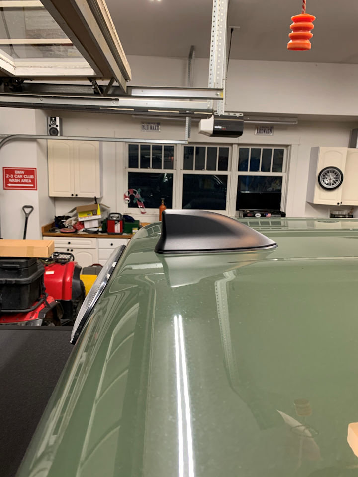

    Toyota never modified the rack - they changed the antenna position in 2020 so it depends on when your 2020 was built. Somewhere around the first week of February, they moved the shark fin back a bit to accommodate the rack. But, I believe it was moved back to the original position in 2021 - can someone else confirm that?
    Mine was built on January 17 2020 the rack will not fit my truck.

    Happen to have any photos from the interior? What material did you use on the roof?
