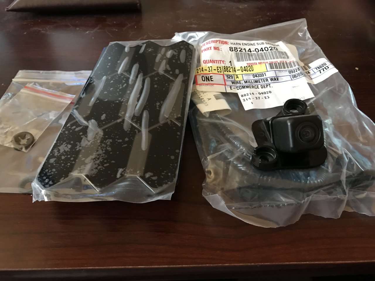

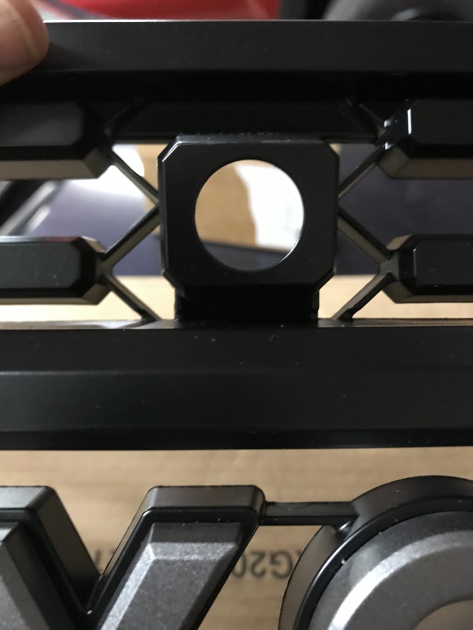

    I have a 2020 TRD OEM Grill, OEM Garnish, and Wire Harness - Toyota (88214-04020) along with an OEM Camera if anyone is interested?IMG-2678.jpg
