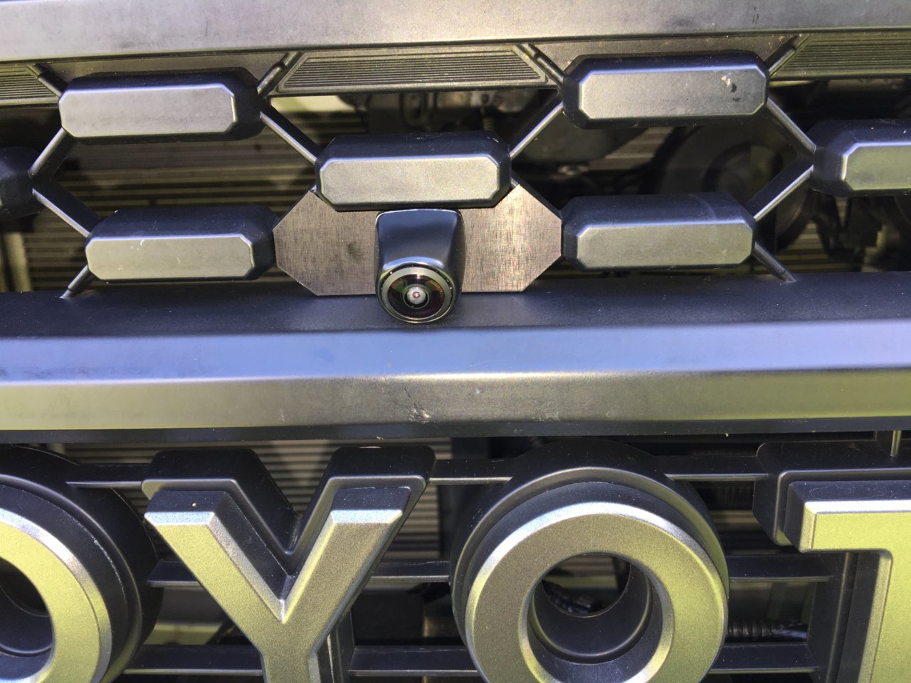

    2FA26C7C-4233-4E4A-8D75-82295D4B74CF.jpg F6E65D5C-7CF5-406C-83C7-8655EC89C4C0.jpg
    Here is my setup
    2018 TRD pro grille with the BeatSonic camera.

    I went with Beatsonic brand and wired to the shifter knob

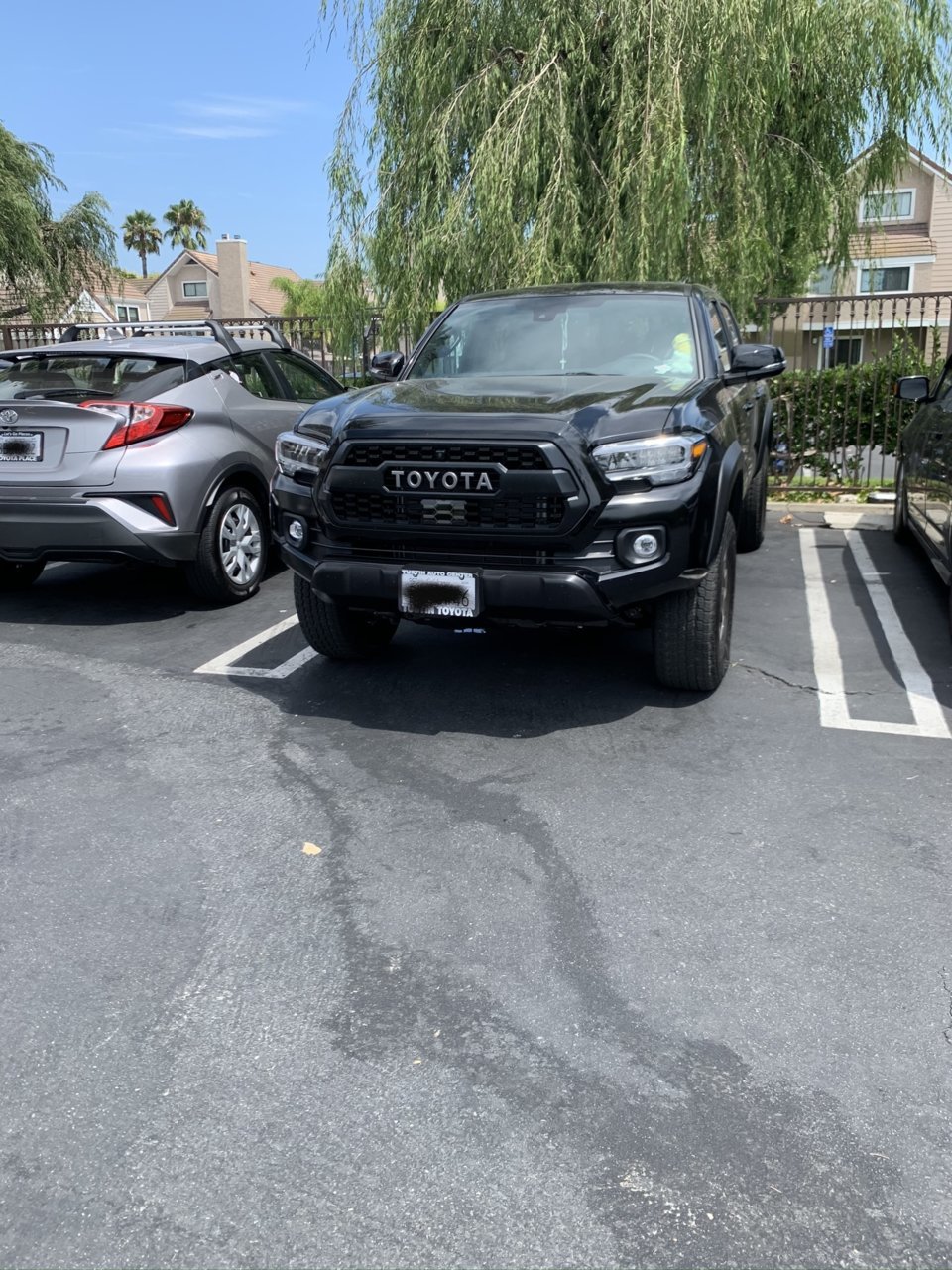

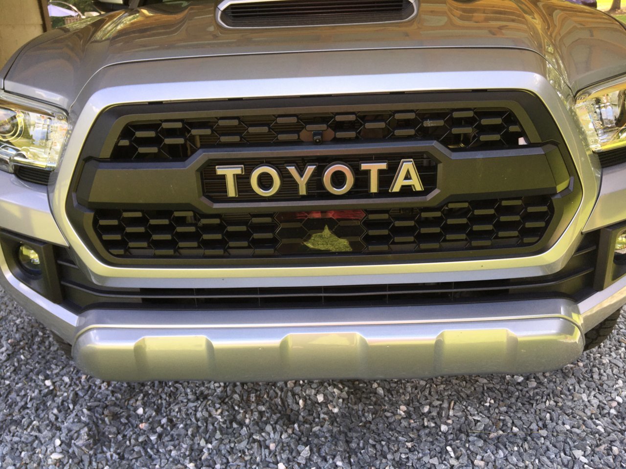

    2020 Black Tacoma Off Road
    So far no sensor issues and this is what my front camera looks like now
    Also shout out to Grant for the mount it fit perfectly
