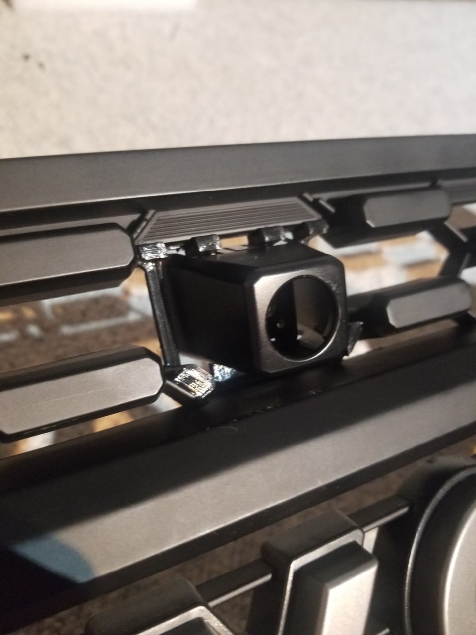

    Would you be willing to make another bracket and sell it? If so, how much shipped? Thanks!

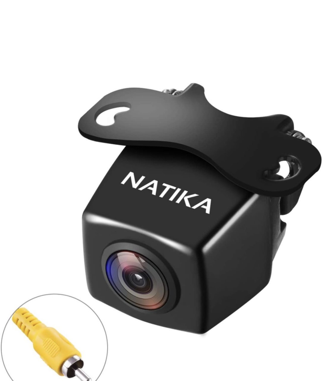

    To be honest, its kind of an overly complicated design and would be hella expensive, since it was printed on an industrial HP Multijet printer that does low volume production parts for aerospace. I do CAD favors for the guy that owns it. I'm a degreed engineer that does contract work from home (with occasional travel as needed).
    The Natika WD-012 camera comes with a screw on flange with panel mount clips, so you can just carefully enlarge the hole on the Pro grille with a round file (about 0.050 on the radius) and pop it in. Use some clear windshield Permatex on the back to keep it from rotating as the camera has an UP mark on it.
    Also, the Anytime camera kit comes with a different Natika camera. The WD-012 has the same connector and I assume it works, but havent had time to install the Anytime relay and switch on my infotainment system yet. So be advised.......

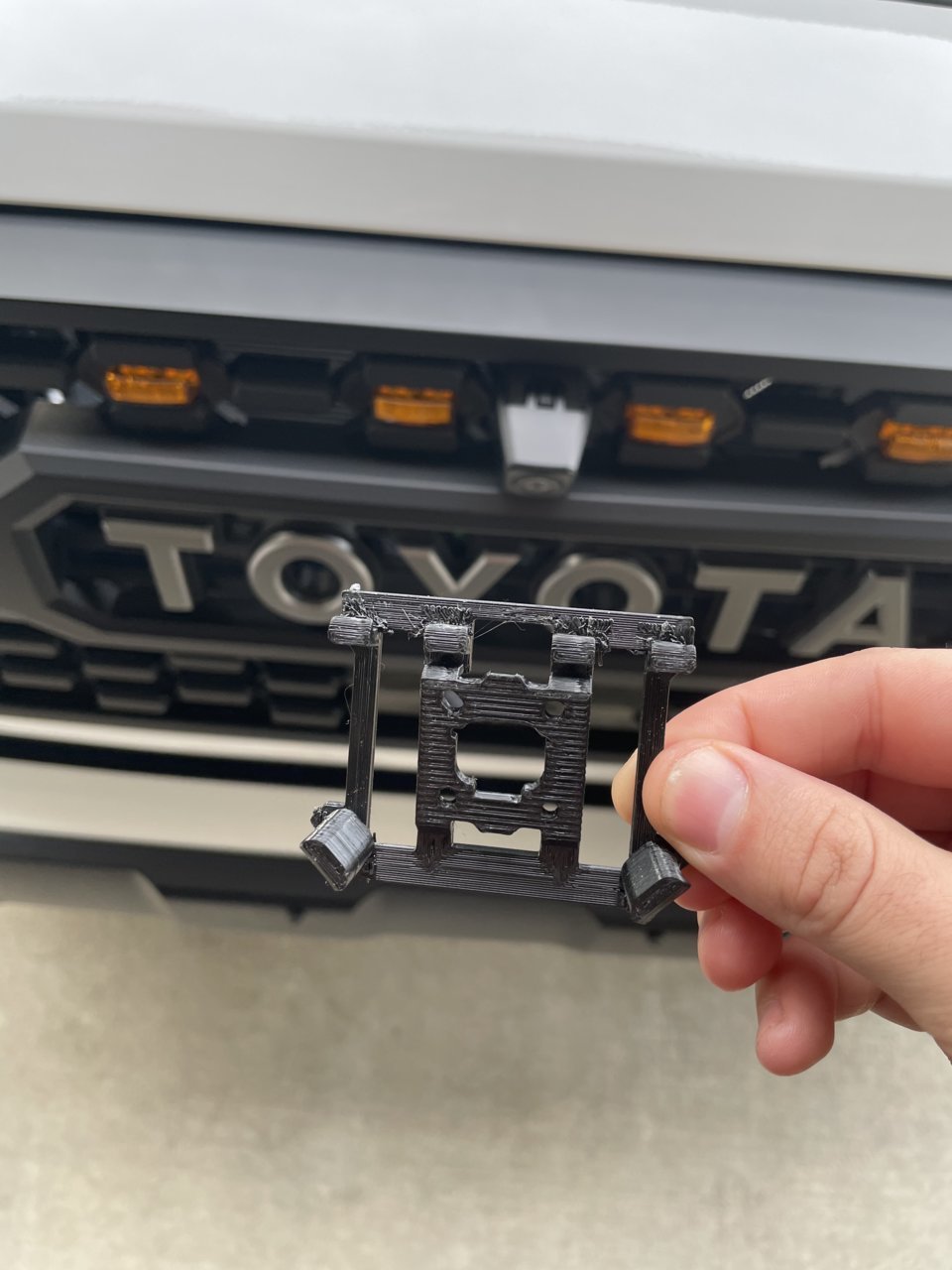

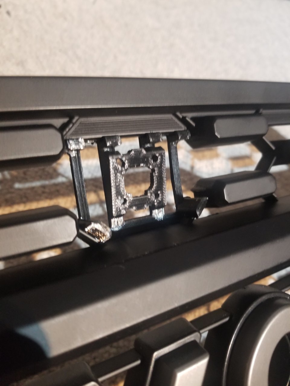

    Hey Tacoma World,
    First I must say thank you for all the support over the last 7 months with my camera brackets for the PRO GRILL.
    I have had several requests to make a bracket for the aftermarket 2019 and below PRO GRILLS as the cost far less than the OEM counterpart.
    After a couple weeks of tinkering I have came up with a solution that will make this option a reality.
    I have designed a camera mount bracket that will snap into place on the aftermarket grill once a small section is cut out for the bracket to fit.
    the design also incorporates the use of the stock camera cover which snaps into place and locks onto the braket.
    I am currently printing out the first batch of test models for end users to review.
    no more finding vin numbers and paying way more for the same grill.
    Im looking for a couple more forum members interested in test the new brackets that are willing to leave a review for other members to see.
    I will discount these members for their troubles.
    Email me if interested
    grantschoenit@gmail.com

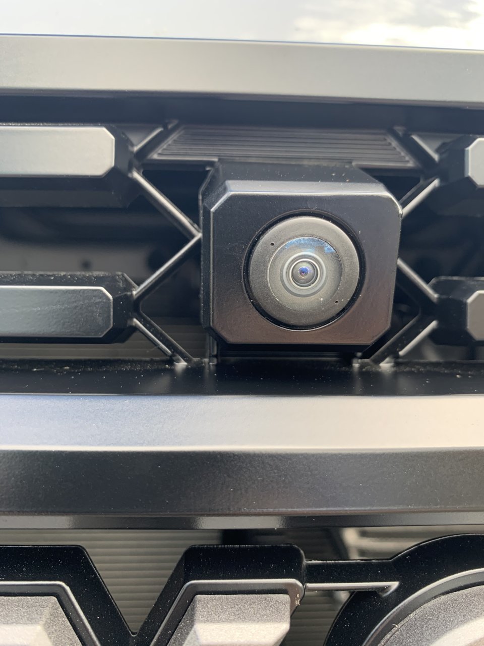

    I had to come on here and leave a review..
    First of all, Hello Tacoma World! New user/new Taco owner here. I wanted to give a huge shout out to Grant. I got myself a pro grille for my 2021 Tacoma TRD OR, and immediately started shopping around for best ways to mount my OEM camera to it. I saw Grant’s name floating around on the forums so I thought I’d give it a shot after some of the mounts he made.
    Grant is awesome, quick to reply, super helpful and helped me get a new mount made for my pro grille. (Extra points, fast shipping sent to the USA from Canada within less than a week!) For starters, anyone looking for a good way to mount your OEM camera, look no further. Grant designed this mount to snap perfectly in the pro grille as well as allowing the OEM camera housing to attach. I was actually blown away by how well it fit and how good it looks on the truck.
    10/10 stars. Great product, great service. Hopefully this solves the problem for a lot of you out there. You won’t be disappointed!
    Thanks Grant!
    Give him an email for inquiries:
    (Note* You can hardly see it but at the top of the mount I had to existing holes from my previous mount, so I just added 2 small zip ties for extra security. This is not required to install this mount)
