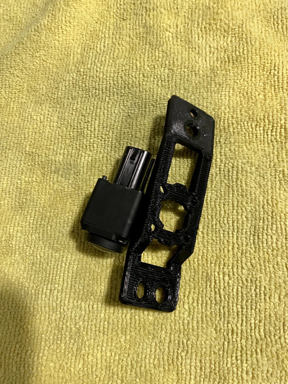

    I have a Aftermarket Pro Grill with Camera bracket installed for sale if anyone is looking for the full package in one go. Shoot me an email if interested or if you need any brackets.

    If you ship them to me I could design the bracket for you

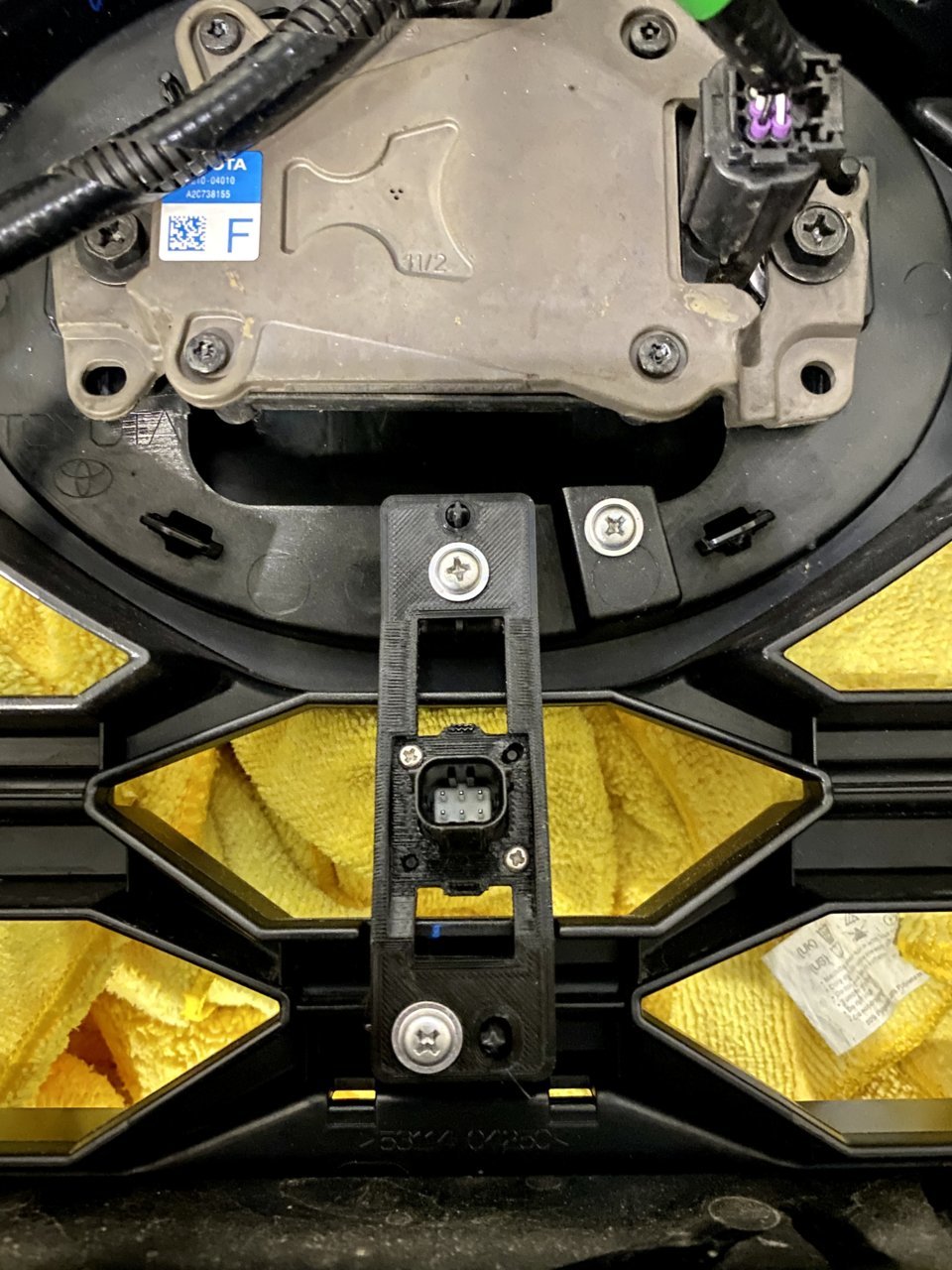

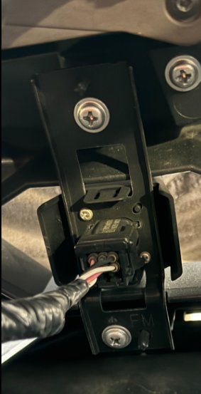

    Quick review and feedback on Grant’s bracket here: In short, I had the bracket within a week of ordering it. He shipped right away and no problems with payment.
    In my case, I have a Limited trim model and wanted to go with the TRD Off-Road style grille.
    So I was looking for a bracket that would go on a used TRD off-road grille. The bracket, I think, is interchangeable with the TRD Pro grille but is different than the ones used on the Limited grille, which mount horizontally rather than vertically.
    So, for anyone wondering, Grant’s bracket works great on TRD off-road grilles - please see the pictures below.
    Grant, awesome work and thanks for helping us all out!

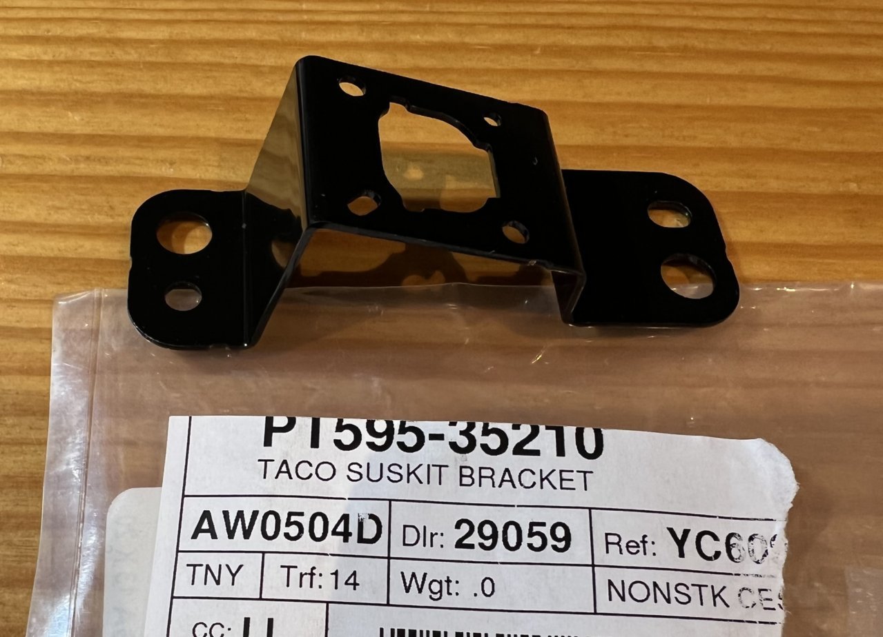

    The bracket you need is a little different than that one. The exact part number to order is PT595-35210. It listed as 'Taco Suskit Bracket' but it is the correct bracket. Its inexpensive

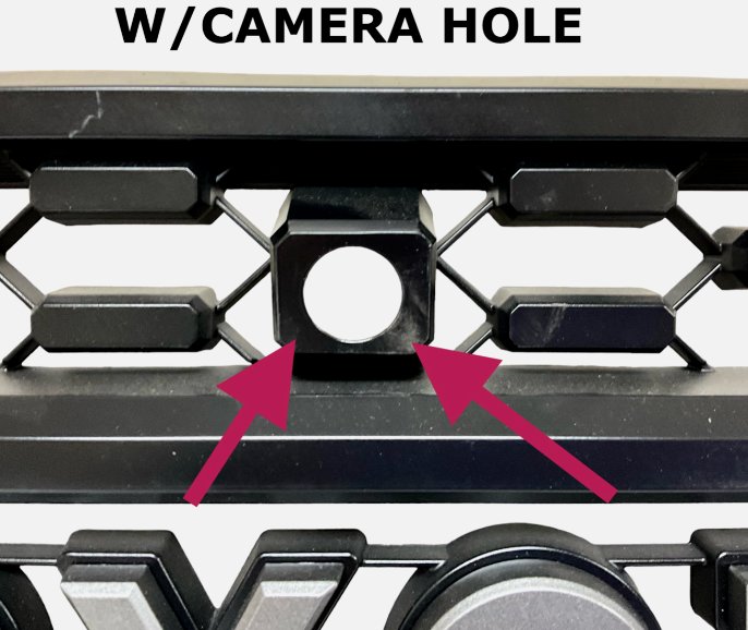

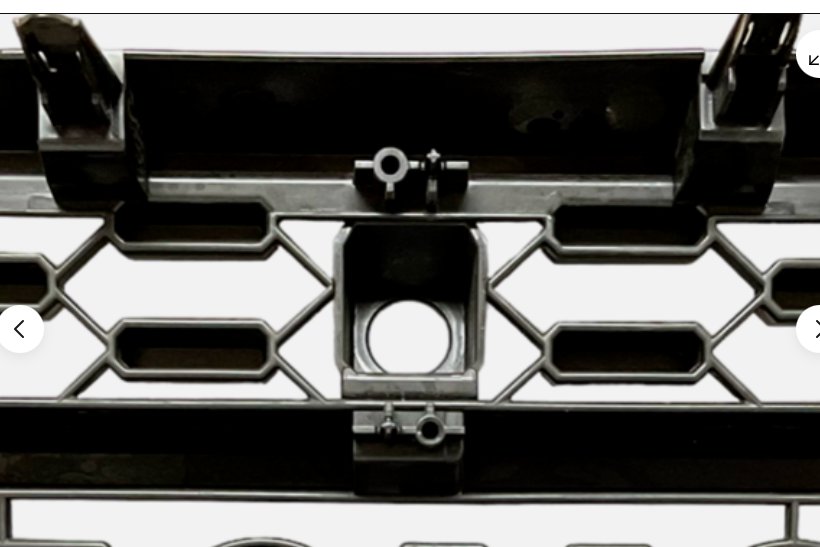

    HI Guys
    I want to ask for your help. I bought the TRD pro grill ( still don't know if they will request a vin since I bought it from toyotapartsdeals.com) and I see that it already has the camera hole. My 2021 TRD off road comes with the camera but in looking at the back of the grill i see the positions on the holes are different from the OEM bracket on mine.
    my bracket looks like the below
    This is the grill i bought
    looks from behind where the bracket goes
    Will the OEM bracket from my TRD OFFROAD fit the TRD PRO OEM grill?
    What is throwing me off is where to screw my bracket on the new TRD Pro grill
    I would appreciate your thoughts on this

    You want the following…
    86799 - 04020 (this is the harness from the suspension kit, it’s optional but the wiring is gorgeous like OEM. If you reuse your stock harness it’s screwy and will be pulled in a way the wires are visible from the front…gross. It costs about $40-45 and worth every penny to do the job right.
    PT595-35210 (this is the bracket, you will remove your camera from the original bracket and put it on this. It legit costs all of like $3-4 and you’ll be golden)
    here’s the camera bracket $1.78, call a dealer about the harness, I bought and installed it works perfect just like the bracket.
    https://parts.reliabletoyotamo.com/oem-parts/toyota-taco-suskit-bracket-pt59535210
