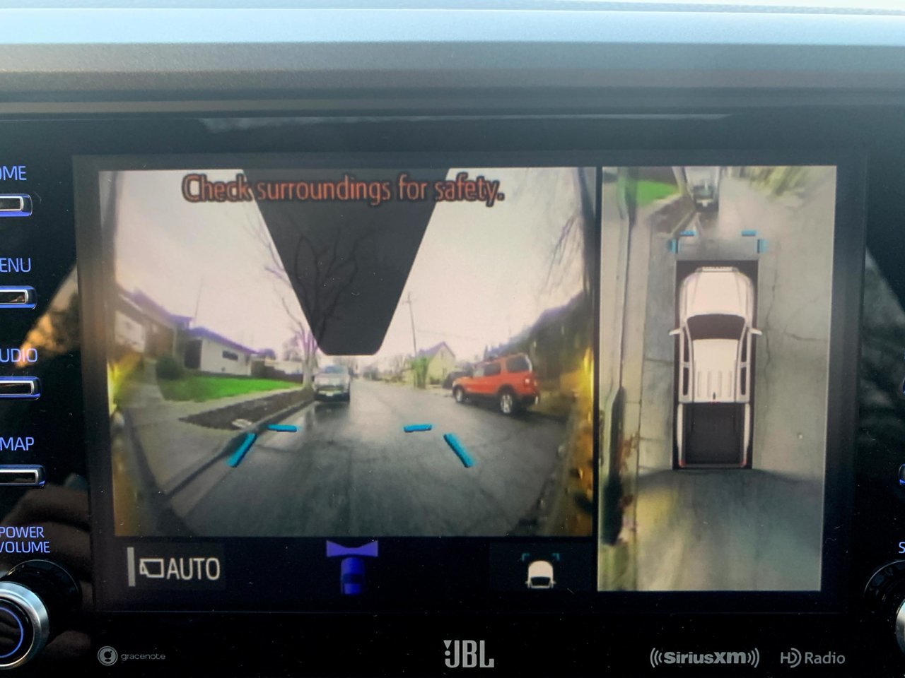

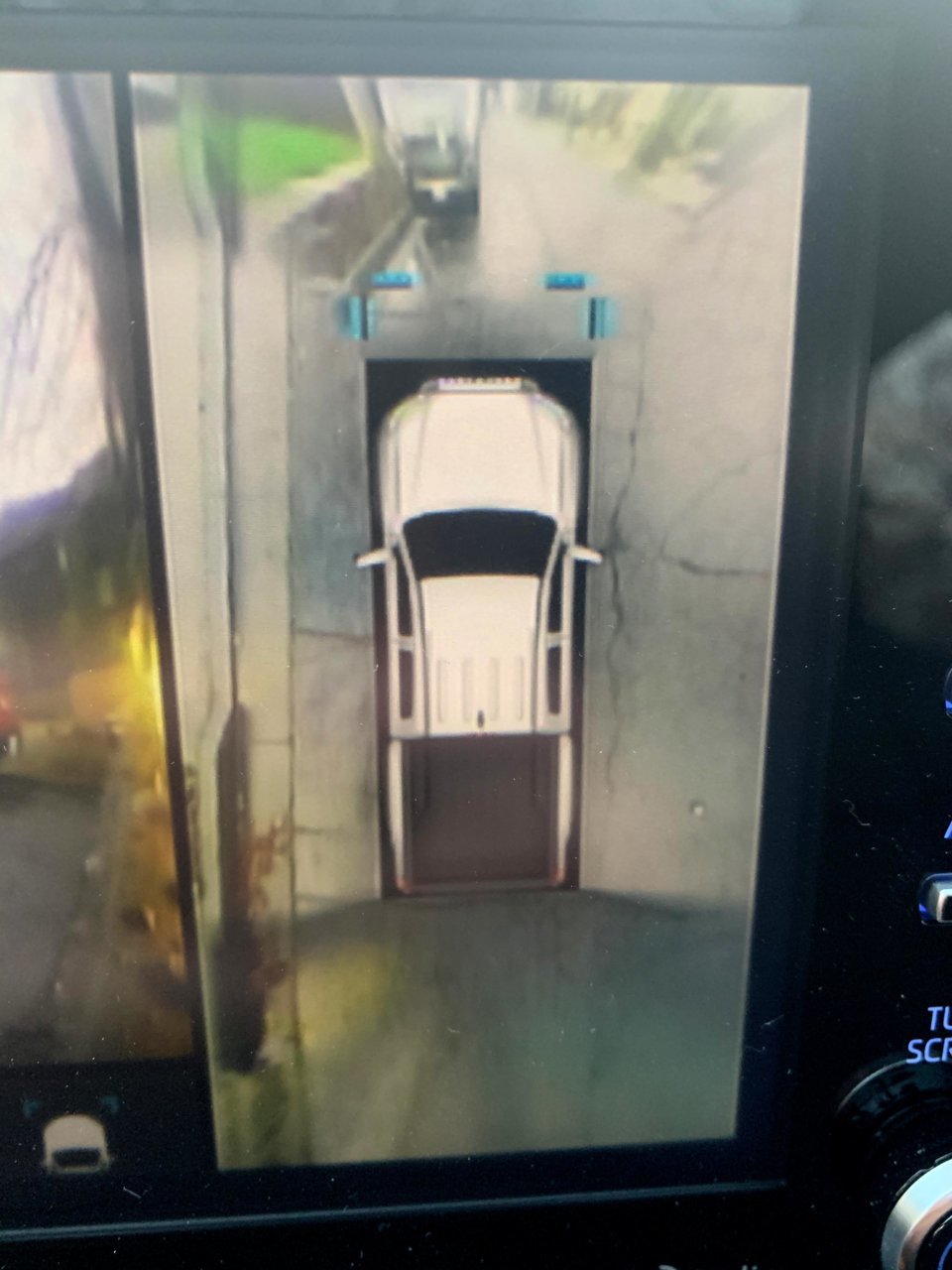

    Same. Looks great. Would also like to see 360° veiw....

    King 2.5 remote adjust front/rear Total Chaos UCAs 285/70/17 Falken Wildpeak AT3s w/Fuel Torque -12, CMC MBRP 3in T409 catback exhaust TRD Pro grille w front cam relo, smoke quad raptor lights
    Sure here it is. The front cam angle is obviously higher causing the blend to look far more abrupt. But still functional in the 360 view. Once on the trail, I imagine I'd prefer to extend the cam out a bit more and angle it slightly forward more to track the immediate foreground more.

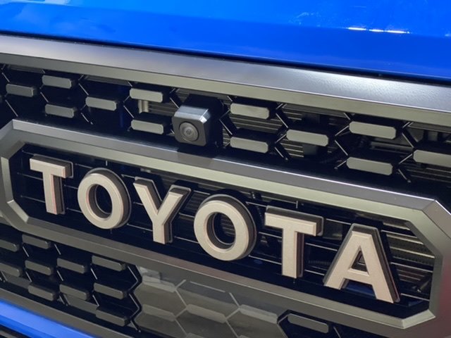

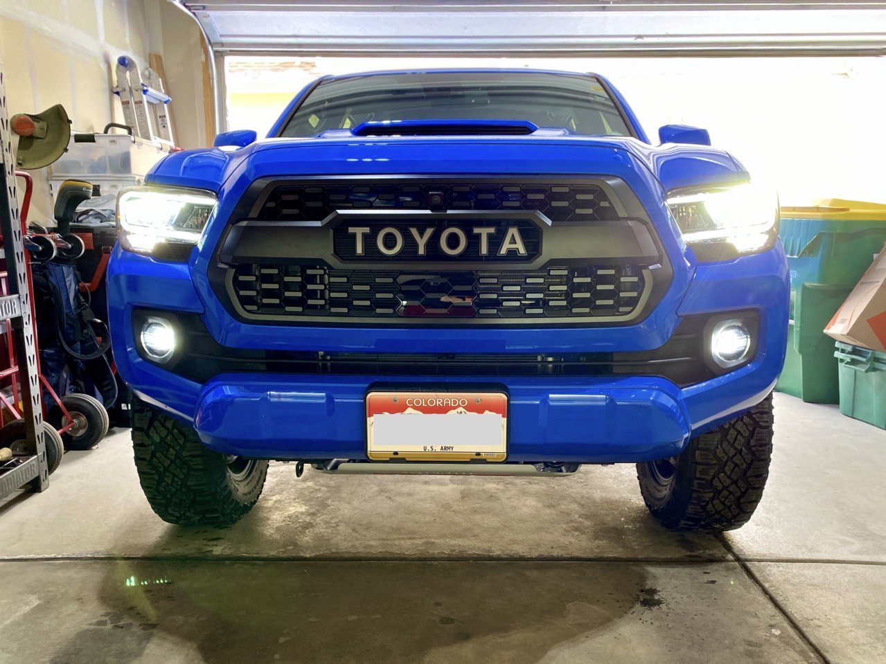

    2020 MGM TRD Pro
    The part # is 867B0-04030 for the front camera that includes the Pro grille mounting bracket. I just finished upgrading my 2020 Sport to a 2020 Pro grille and I also ordered that camera. The mounting bracket is key as it allows the camera to mount into the pre-molded camera shroud on the 2020 Pro grille. But as the earlier poster demonstrated, there are other ways to accomplish the upgrade. The OEM path for this upgrade looks great, but it leaves a crater in your bank account (grille+garnish+camera/bracket). :frusty:

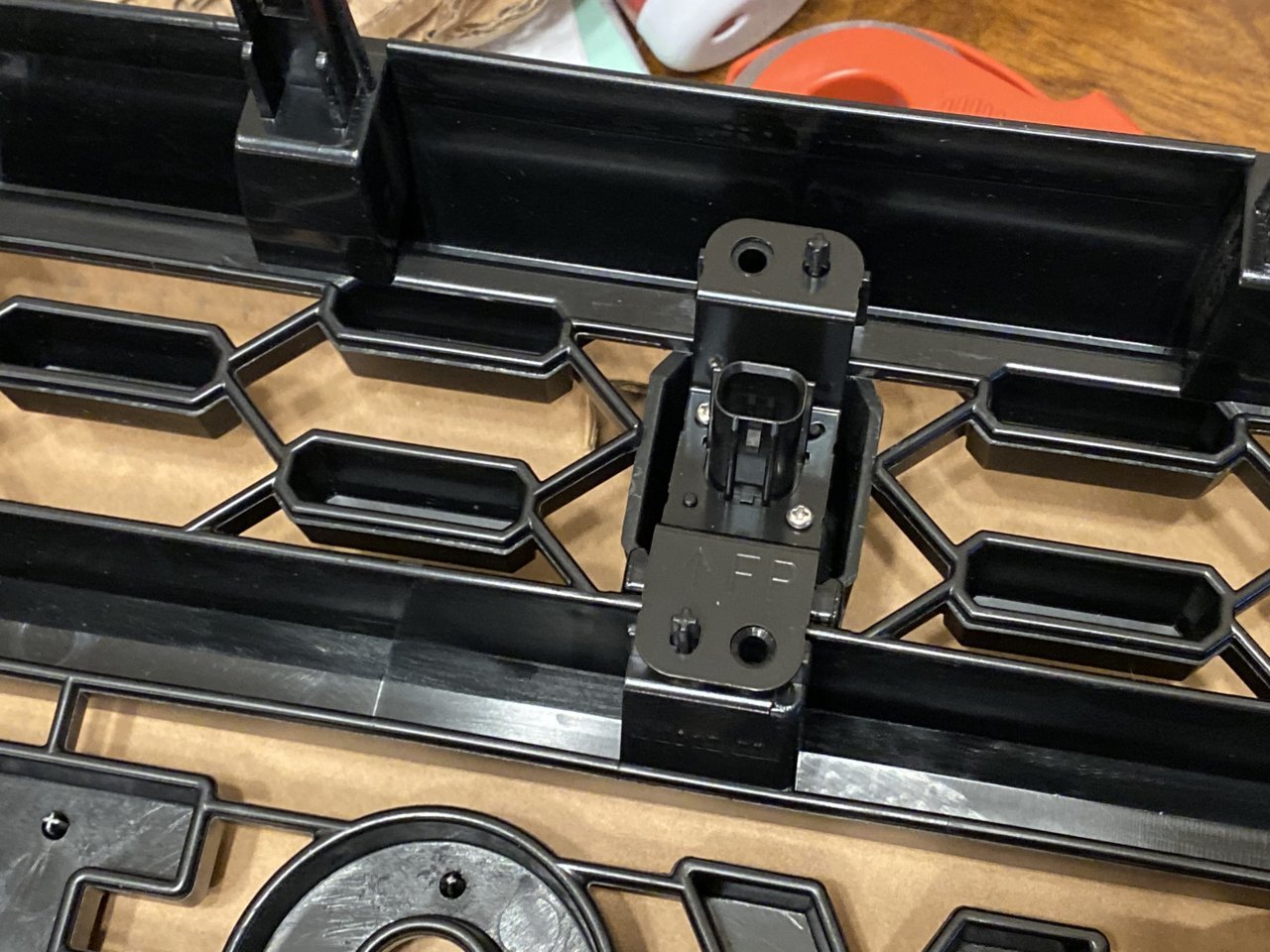

    alexthesparky
    alexthesparky [OP] Well-Known Member
    Sep 24, 2019
    #306160
    55
    Alex
    2020 DCSB TRD OR
    Would it be possible for you to take a picture of just the backside of the grill with the camera mounted? Kind of like I have in the original post.
    I could machine a bracket fairly easily but I’m not sure if an aftermarket grille would have the same mounting points for the bracket.

    2020 MGM TRD Pro
    Unfortunately, the aftermarket Pro grilles do not have those pieces. At least none that I have seen. Perhaps someone will make one at some point. I heard runnin4tacos was looking into it but currently they have a disclaimer posted that their pro grilles are simply incompatible with the 2020 front camera system.
    This was taken before it was mounted...
