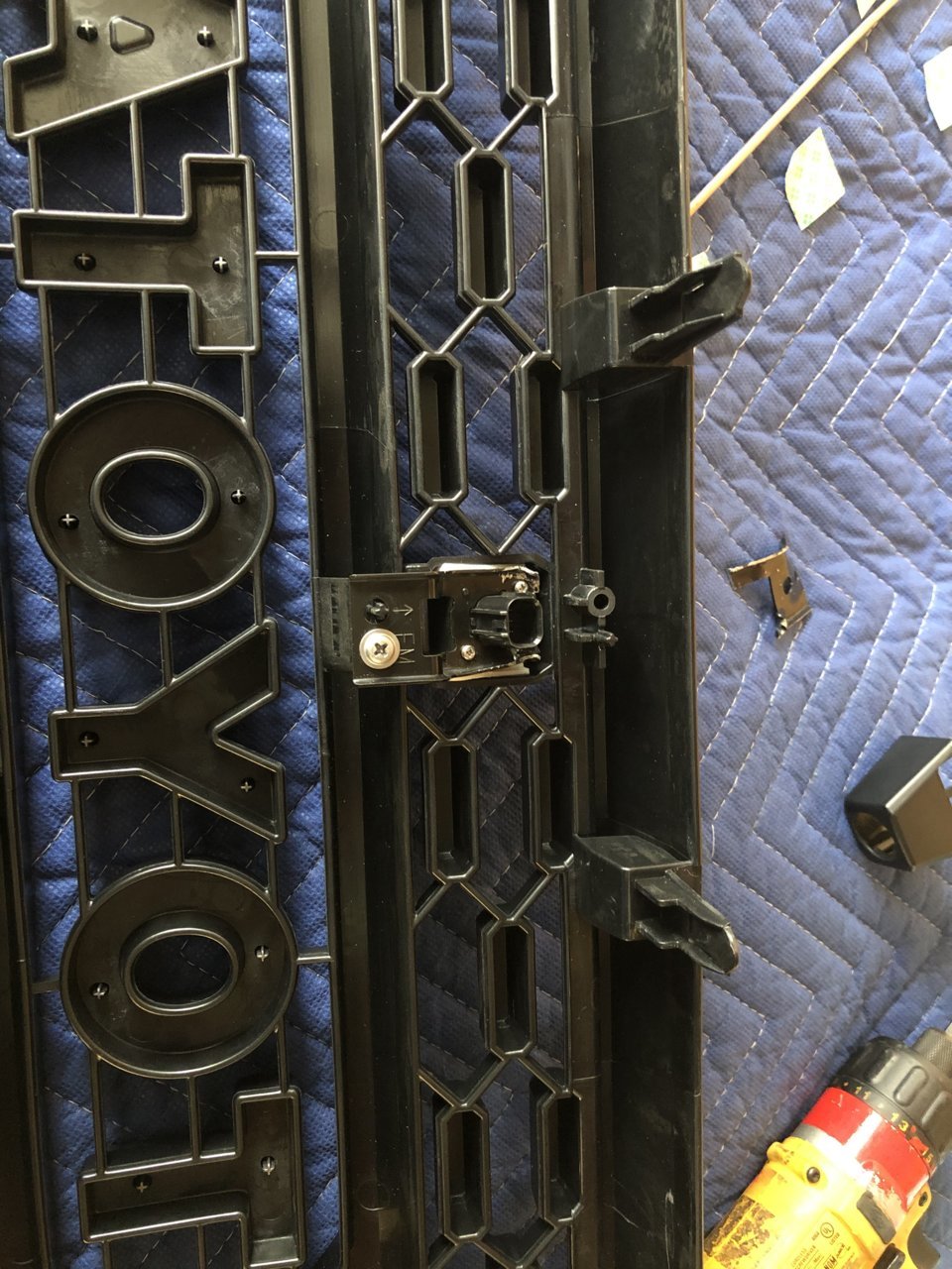

    Here is the bracket, I’ll try to get a better image of the back later today
    Keep in mind this was the first bracket we made so it’s a little rough :D

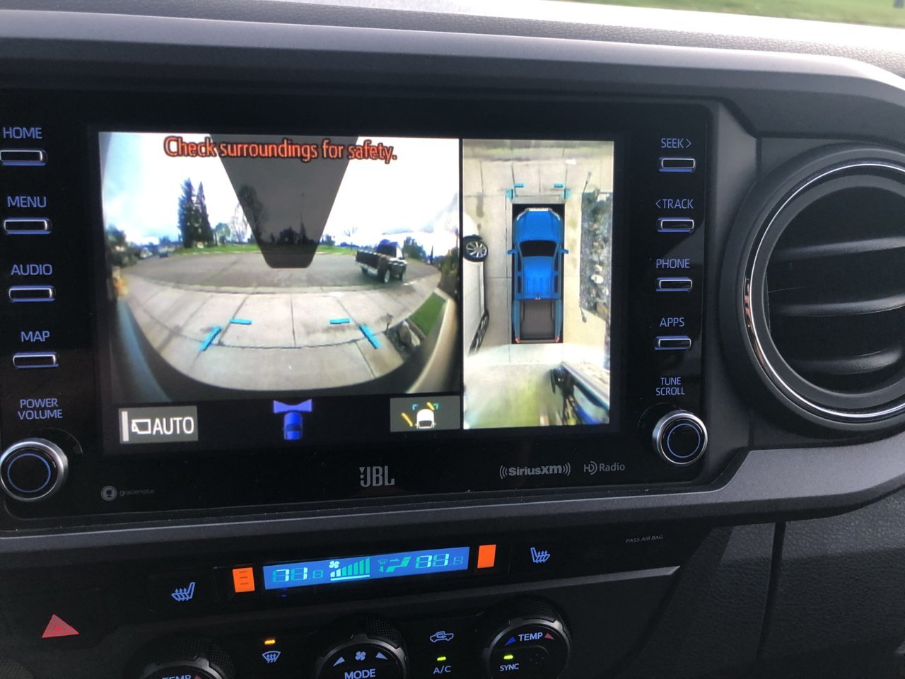

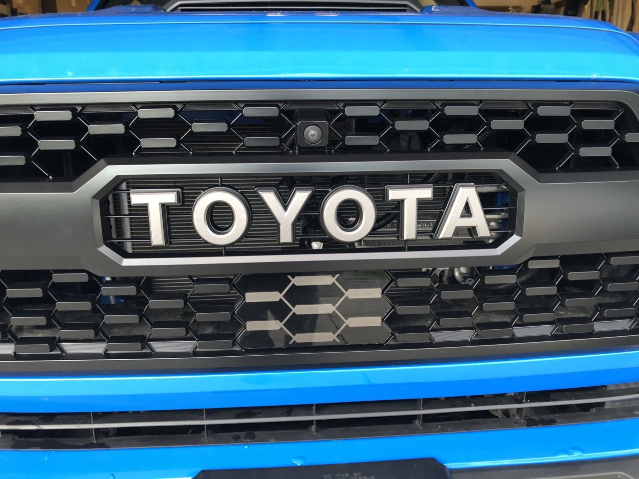

    I was able to make my 2020 Tacoma sport work with the oem 2020 pro grill. I’ll I had to do was cut the top piece of the original camera bracket. This will give it enough space to allow the camera to slide into the correct position on the grill. Also I added double sided tape on the inside cavity where the camera goes so it will be more secure. Like I said before you do need the oem 2020 pro grill to make it work. It cost me $223 plus $43 for an aftermarket tss sensor cover. After install I got no tss sensor issue at all. I was surprised. upload_2020-4-6_23-16-31.jpgupload_2020-4-6_23-17-16.jpgupload_2020-4-6_23-17-54.jpgupload_2020-4-6_23-17-33.jpg

    The Pirate

    i had no issues with the camera or the tss system. No lights at all. I did buy the tss sensor cover from Amazon. If you look at my post earlier in the thread I posted pics of how I was able to accomplish adding the camera to the grill. The grill I bought was the oem 2020 pro grill. You could use your camera braket that you have now. All you have to do is cut a portion of it in order to make it align with screw hold at the bottom.
    OEM TRD Pro Grille - #PT228-35200
