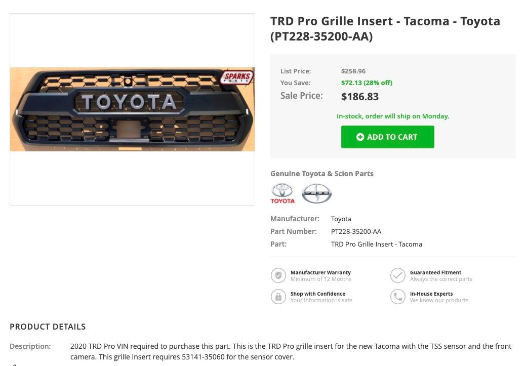

    Just found this on Sparkparts.com. Is this what some of us have been looking for?
  3. May 23, 2020 at 1:20 PM
    #123
    yearlaw
    yearlaw Well-Known Member
    Oct 12, 2015
    #166533
    59
    2020 Cement 4x4 TRD Sport DB LB
    yes but you have to provide a pro VIN number

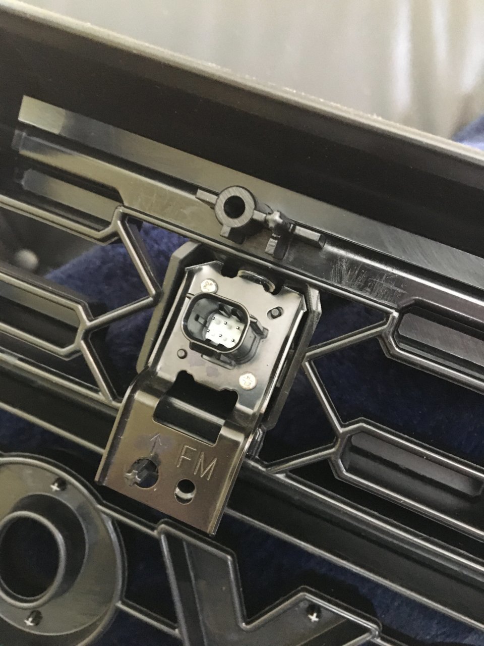

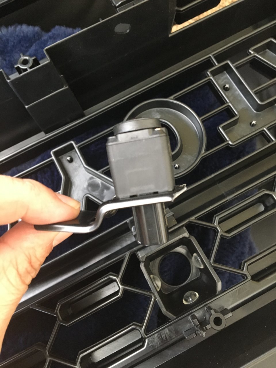

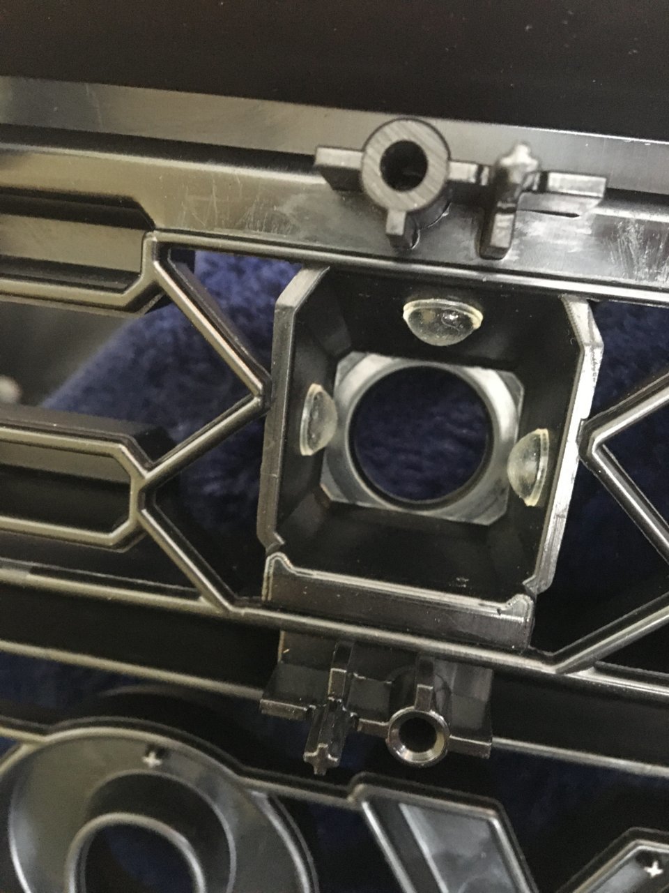

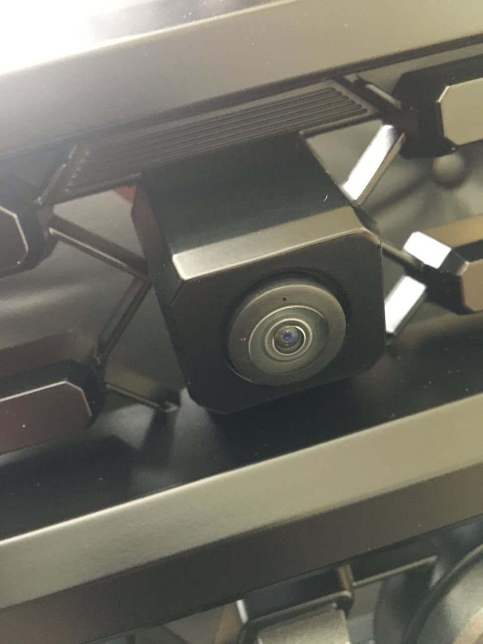

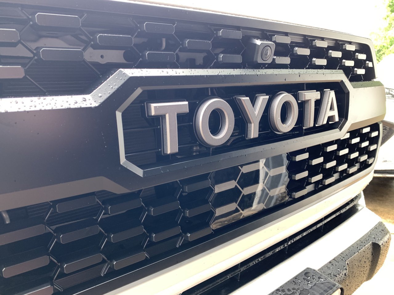

    Been sitting on my OEM TRD Pro Grill for about 2 weeks and can't wait on someone coming out with a camera bracket.
    Just took the leap and cut the bracket on the camera hoping for a tight fit. I was surprised that it aligned really well and flush. I thought it would be loose since not alot of people seem to be doing it, but def. was flush. Added some rubber stops in there just incase. Didn't take pictures of the truck since everyone knows what it looks like. Just the key pieces ...
    I think the only reason the top part of the bracket is there for the non-pro is so the Camera housing can snap onto it. Since the Pro has the camera housing built in, its not needed and the camera mount feels pretty secure.

    Hey Crafte,
    I'm definitely on the verge of purchasing the 2020 Pro Grille insert and doing the hack you did to make the TRD OF camera fit. Have you experience any issues with the camera coming loss from vibration? Also, what garnish did you purchase for the TSS?
    Also, from my understanding, just trim the top of the bracket so it sits flush with the camera and then it should fit fine with the help of a few rubber stops.
    Thanks again!

    Pretty much ... I saw a few guys that did the same thing and Lopez86 also has some pics on Pg 5 of this thread as well. I also had the same concern around the camera "rattling" but once i took apart the camera and the original housing, I realized that the the housing was just a cover and didn't provide any support. The camera is really supported by just the bracket. I honestly don't even think you need the rubber stops. I put it in there because it seemed lose before I committed to cutting the bracket, but once I cut the bracket it sat flush and secure. I just left the rubber stops in and started to tighten everything up.
    I just put it on by haven't noticed any issues so far. As for the garnish, I went with the one from Amazon. Again no issues with warning indicators so far.

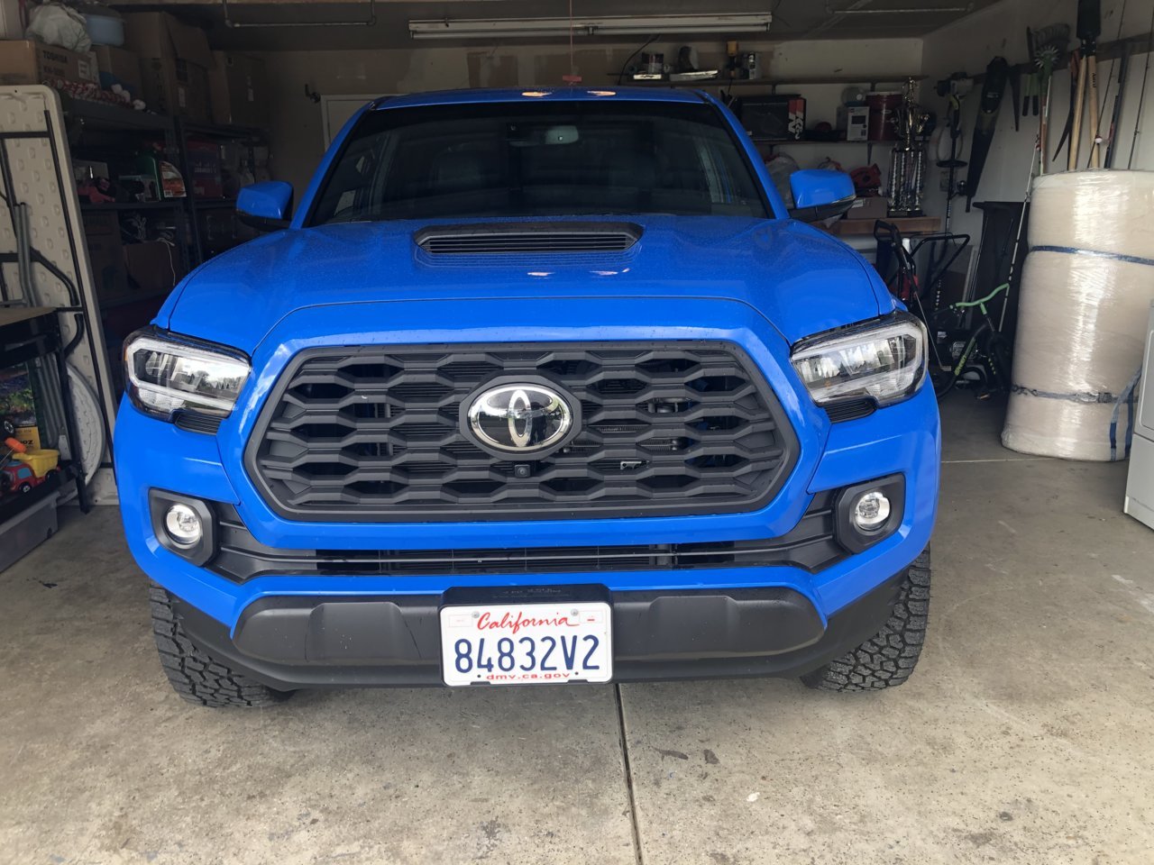

    The grill is grey in color. Although I did plastic dip the grill to get it to be black.i don’t have a part number. Here you go upload_2020-5-29_8-20-8.jpg

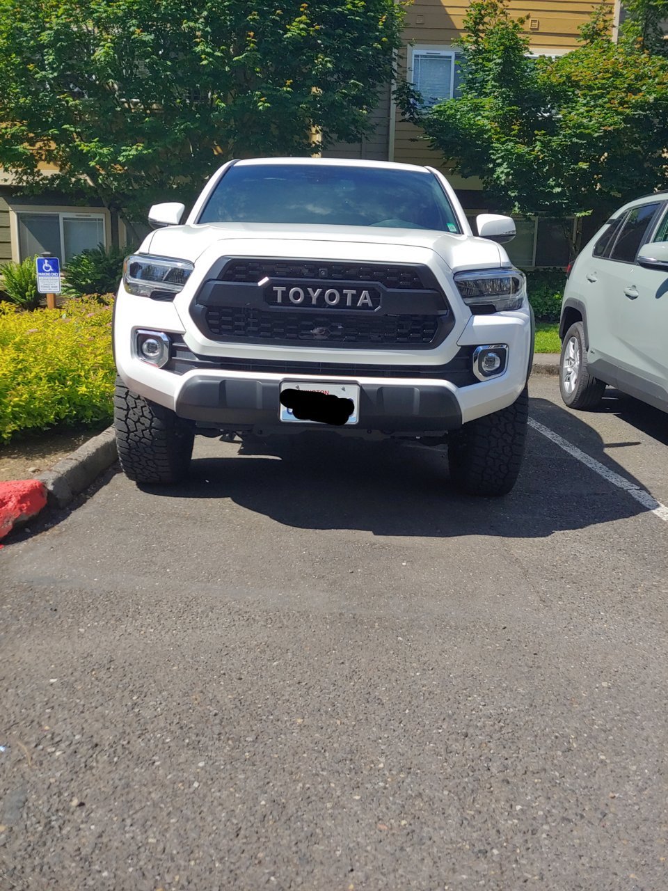

    Just installed the Pro grill with the help of this thread. For the camera, all I did was cut the bracket and bolt it up without any other support and seems to be very secure. I’ll still be waiting on a 3D printed bracket to use whenever someone decides to sell them. The garnish was from Amazon and it still works great, even though it’s not OEM. Everything else fit perfect and now waiting on a clear day to color match the Toyota letters.
