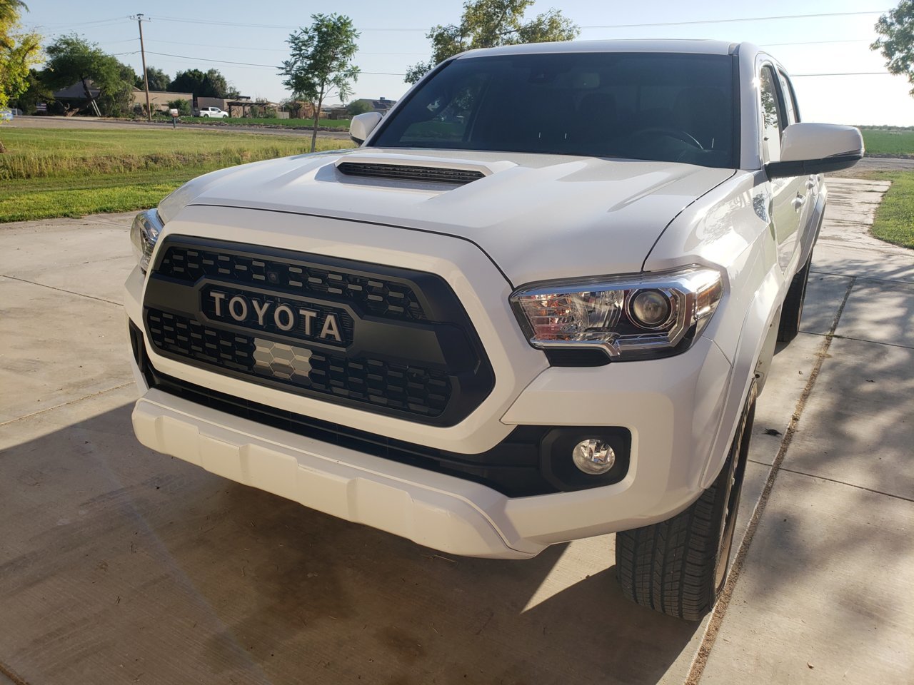

    2020 TRD 4x4
    Eibach Pro Lift - Toyo AT3's 285/70/17
    Just upgraded... I'm happy
    B22A likes this.
  9. Jun 3, 2020 at 6:26 PM
    #149
    B22A
    B22A Well-Known Member
    May 9, 2020
    #327492
    47
    Gabe
    Maryland
    2020 Cement Taco TRD OF DCSB AT with all the fixins...
    None. Yet...
    Well that just looks sexy. What garnish did you end up using?
    Azdvo[QUOTED] likes this.
  10. Jun 3, 2020 at 6:28 PM
    #150
    Azdvo
    Azdvo DuneFreq
    Apr 6, 2020
    #323949
    64
    Shawn
    Yuma, AZ
    2020 TRD 4x4
    The Taco Garage garnish. Cut the sport grill camera bracket in half basically and it ends up fitting perfect in the trd grill.

    Nice, I've ordered one from Amazon on recommendation from one of the guys in this thread. I'll install once I get around to ordering the grill. I'm sure the OR grille camera bracket is the same; you just cut the top portion off and remove the housing and it should drop right in. We shall see...
