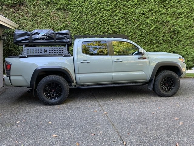

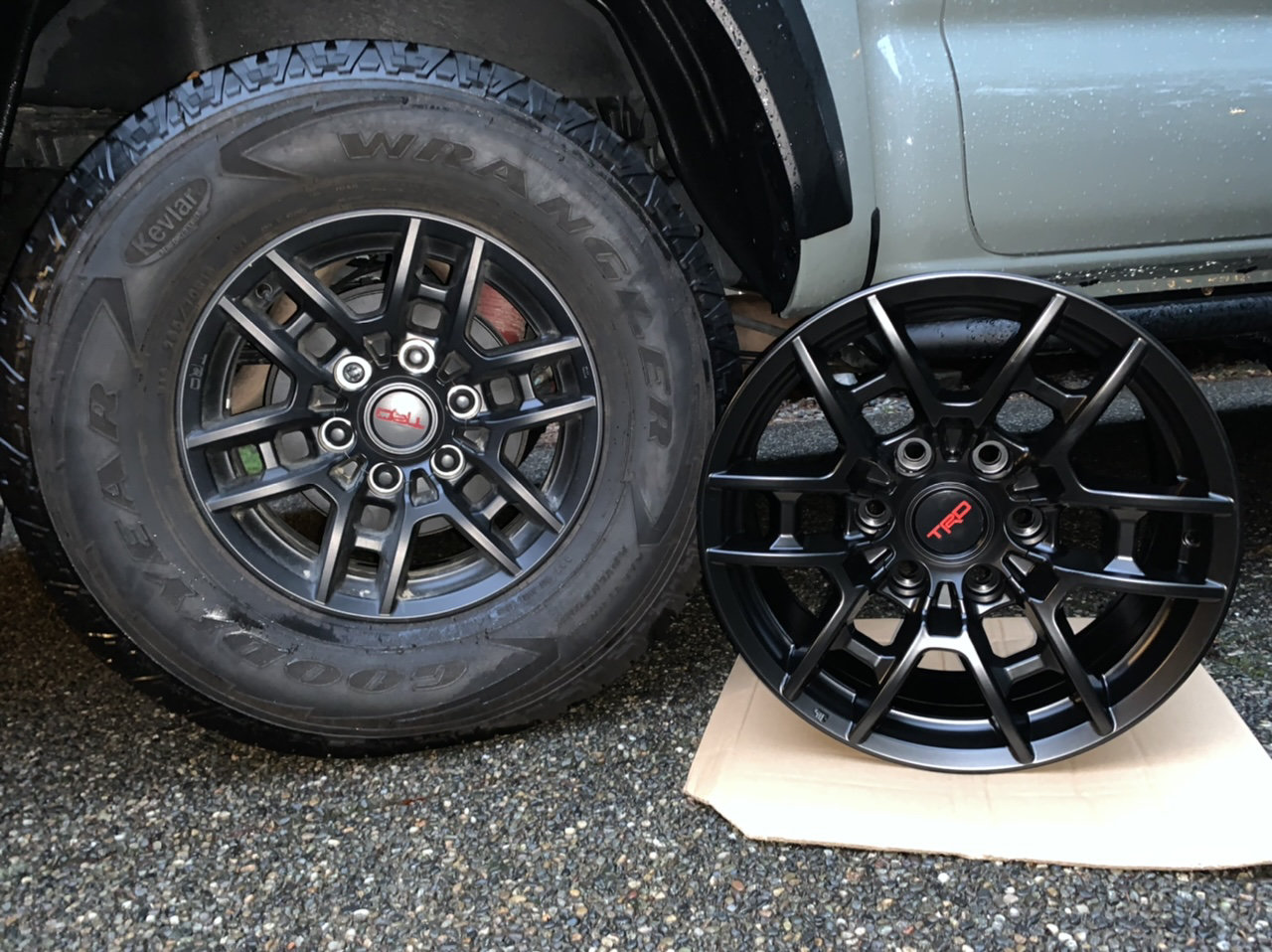

    Completed the wheel and tire installation yesterday. The 17” OEP wheels from WheelsCo are excellent and I doubt a casual spectator would think they weren’t original TRD wheels. Quick shipment and then local install of the 265/70/17 Falken Wild Peak AT3W 115T. They even cloned the new TPMS too. Stock lug nuts also work which saved a few more $$. Wheels and tires look and feel great. Thanks for the inspiration.

    Awesome wheels! Did you get a 17 inch wheel and tire for the spare? I did and will be using the 17's all year round with the KO2s.

    Looking great! The wheel weight doesn’t seem too bad either!

    I did get the fifth wheel and tire too because the originals are, of course, 16". While I'd like to get some more use out of the Goodyear Wranglers, I similarly expect that these Falkens on the 17" wheels will see far more time on the truck through the year. Longer term, I think I would plan to put a dedicated winter tire on the original 16" rims. Have the first long trip on the new wheels coming up this weekend so should be a good test. I have a friend with a Voodoo Blue Off Road just like yours who has the same rim/tire combo set for installation imminently. The pics of your rig have spurred him on.

    The stock 16" TRD wheel and Goodyear Wrangler 265/70/16 weigh in at 61 lbs. The OEP 17" wheel and Falken Wild Peak AT3W 265/70/17 weigh in at 68.5 lbs. Not bad at all. I think I can live with carrying another 37.5 lbs.

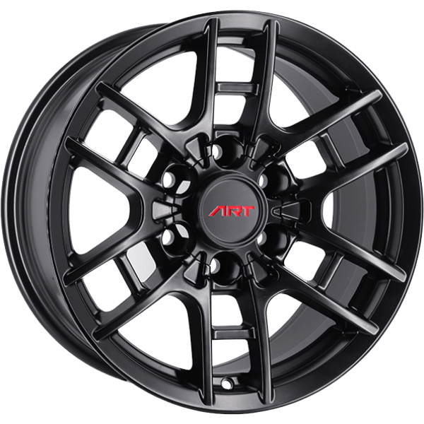

    I an patiently waiting on my new wheels.
    ART Replica 237's. Ordered from wheelwiz.ca and the wheels are Canadian made. I should have them by the end of the month. I plan on putting Toyo Open Country AT III's on them. Just deciding of I go stock sized (265/65R17) or step up to the 265/70R17's. I ordered then in July when they were on sale but backorder.. $167 a wheel.
    17x8, with +5 offset.

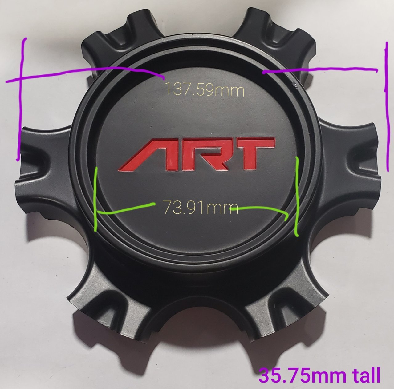

    Hey Speedfreak, remember to send me pics if you find TRD center-caps for these wheels :D

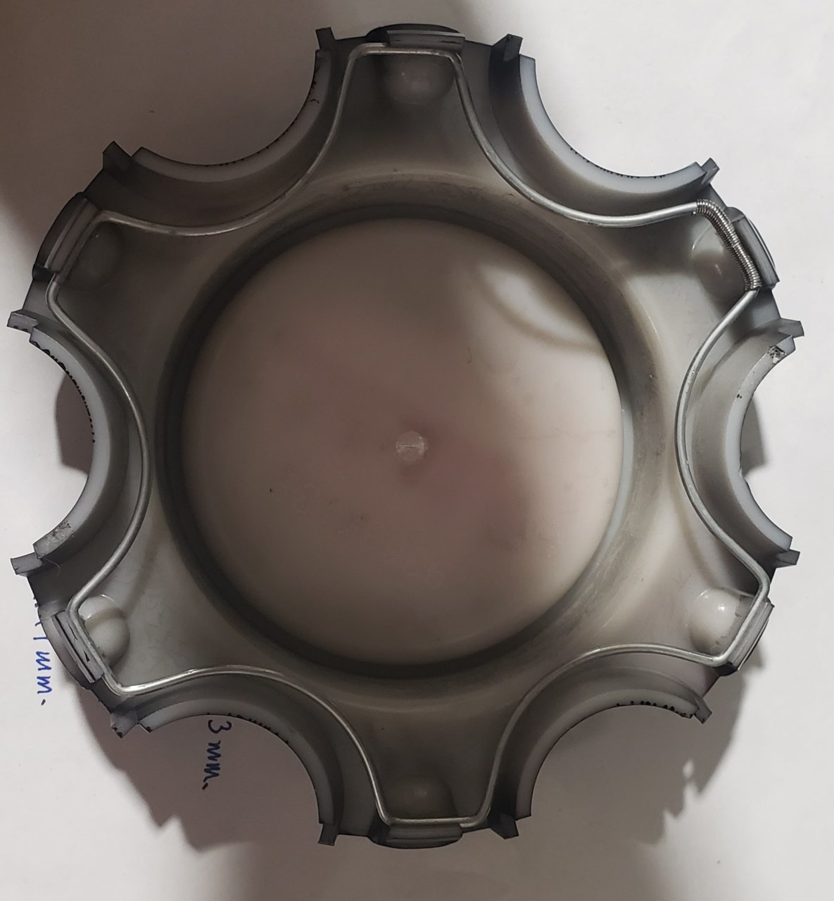

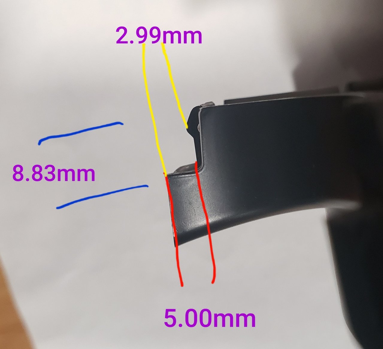

    @bigtrout , sorry... a little delayed but here are some numbers...20220321_073541.jpg 20220321_073357.jpg
    Sorry... I only had crayon when I was drawing out the lines:anonymous:
    Now if we could convince someone with factory TRD Pro wheels, in this style to measure their centre cap...
    Edit: added a photo of rear side of cap for reference as well.
