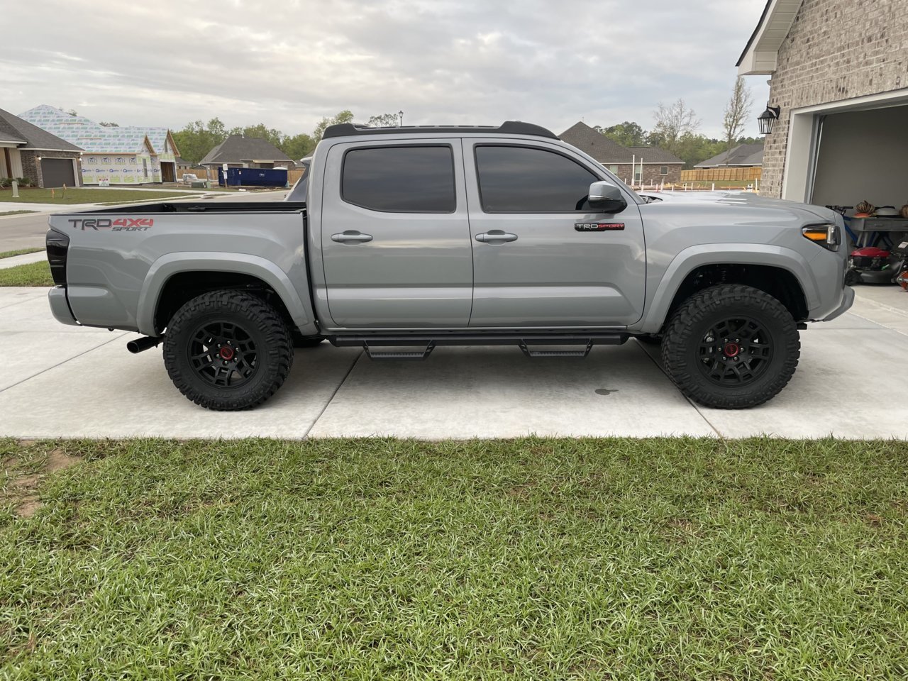

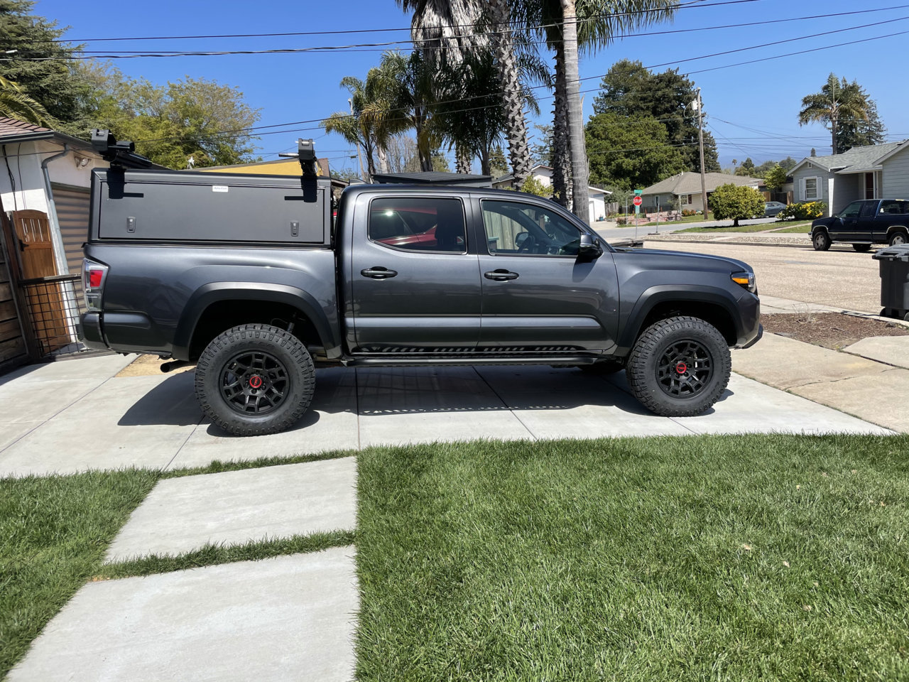

    Got mine! 265/70r17 Nitto Trail Grapplers with a 1” leveling kit

    now thats a good looking combo!

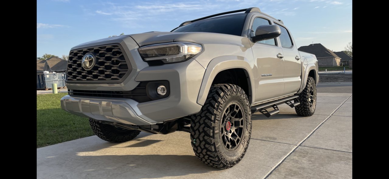

    I saw your YouTube video, nice looking truck! Did you experience any issues while installing the 2021 PRO wheels? Some 3rd gen owners are saying there is a tight fit at the rear and you have to remove the dust cap that covers the center nut up front to properly seat the wheel?

    That set up looks sick! Can wait to get my wheels! What size wild peaks are you running?

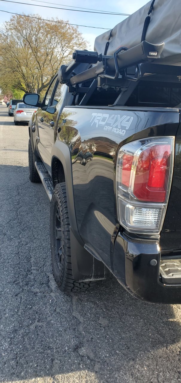

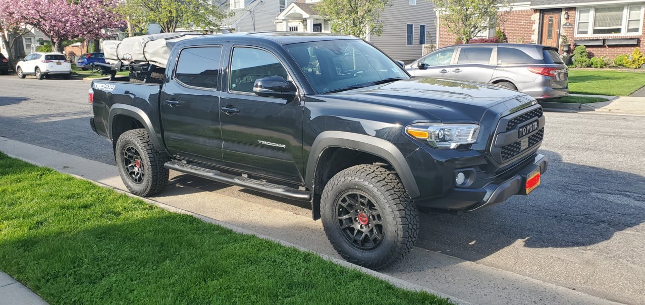

    I just ordered these rims and 265/70r17 wildpeaks. I saw in another thread that its necessary to machine the rim or grind 1mm off the rear hub. Im planning to grind the hub and I think that it will rub the front oem mudflap

    You may be OK with 265/70/17 not rubbing the front mud flaps. I run 285/70/17 and did minor trimming. I don't have mud flaps but the clearance needed with 285s was not much.

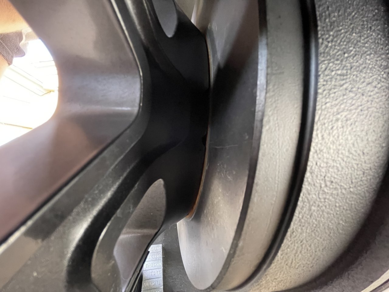

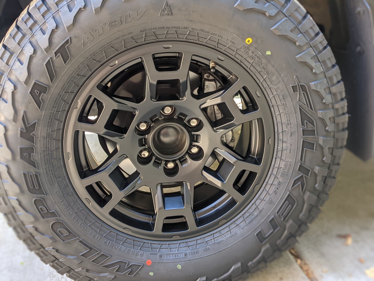

    My tacoma had the fitment issue on the rear. Its too tight and the wheel will get stuck. The shop grinded very little off the 4 wheels, just enough so it doesn't jam after being tightened.

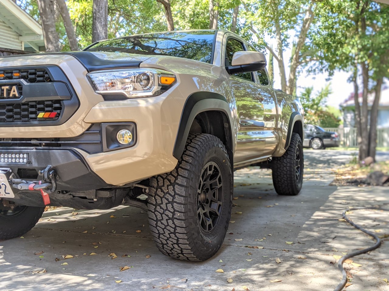

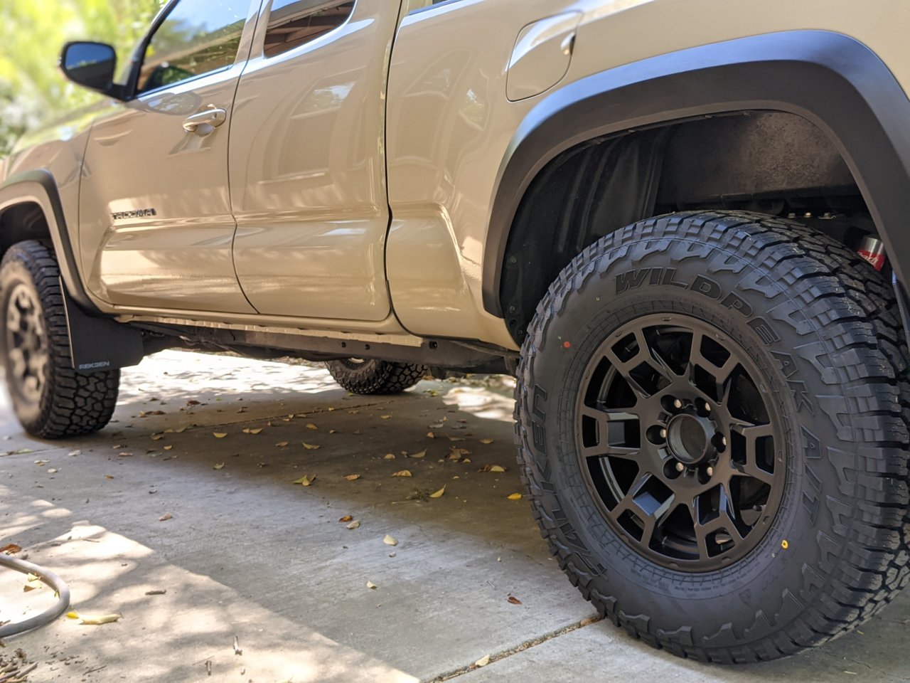

    Just got these through AGP wheels in Sacramento, though they do ship them to various shops across the states.
    The Toyota center caps fit on them, so I'm waiting for them to come in :)
    Falken Wildpeak at3 285/70r17

    What lift, if any? Looks good.

    Eibach Pro Coilover set. I run 1 1/4" blocks in the rear. The fronts are easily adjustable.
