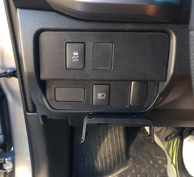

    So I recently purchased a 2021 SR5 (upgrade from my 2010). Nice that they have the hookup for the electric brakes for my trailer. Unfortunately no convenient place to mount the controller. (Current location smacks my knee every time!) I'm wondering how difficult (or possible) it would be to move the Auto Headlight button to the upper area and modify the lower area to accept the electric brakes. Photo attached. Looking forward to some input.
    An alternative mounting location would also be welcomed. Thanks.

    You're probably better off moving the traction control down to the lower part and the brake controller in the top part, there's just more room behind the top part.
    Custom Meso panel would be the ultra best option.
    That panel just pops out the front, so pop it out and see what things look like in there. The switch positions that are the same size you can just put the other switches in them. There are some keyways that might need a (very small) amount of trimming on the sides of the hole, but it's reasonably obvious once you get in there.

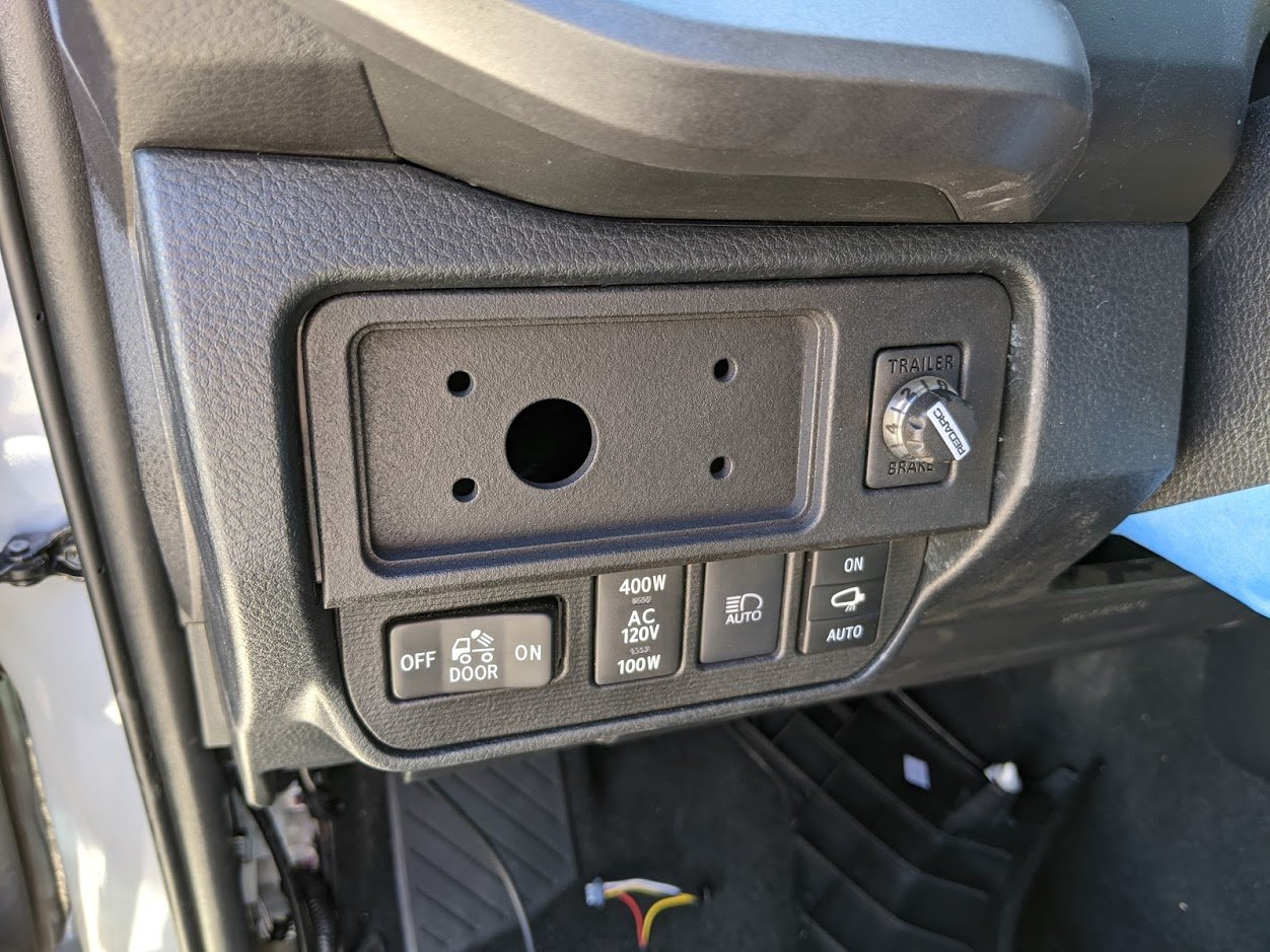

    [​IMG]Untitled by chris tsay, on Flickr
    The brains are 3M double sided taped up underneath the dash.
    This is the switch blank I used (for the "tall" cutout): TPSI-007
    Plug and Play Harness: TPH-015

    This is roughly what I did as well. I was able to find a hole to throw a bolt through under the dash and I used the smaller switch location plate though.

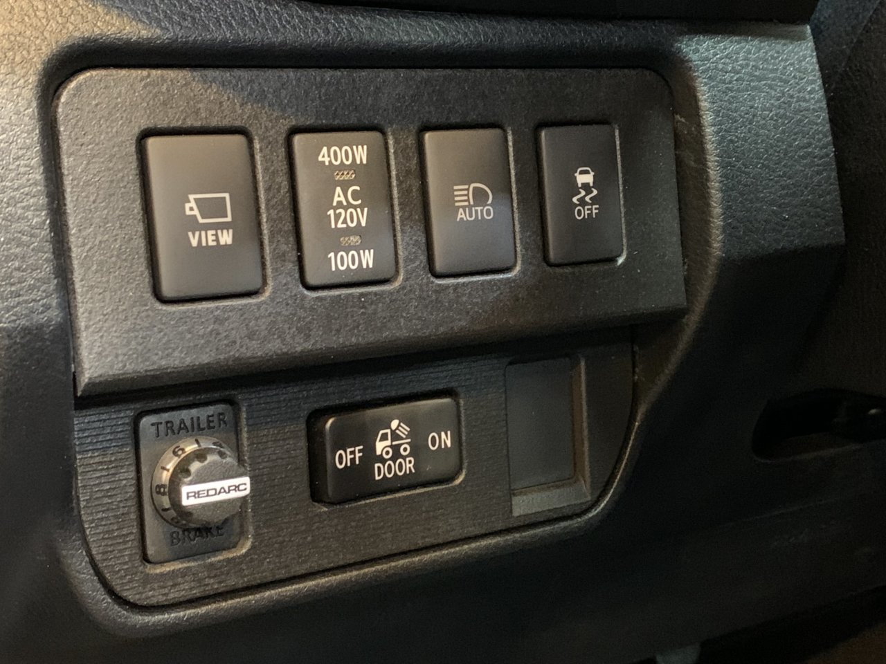

    Another satisfied Redarc customer with the help of a Meso panel

    Thank you all for the great advice! The Meso Customs was pretty exciting, but then the Redarc controller is just $30 bucks more and soooo clean an install. I do believe I will go that route. Also going to order those pry off tools! Thanks to the community for all the options and pictures.
