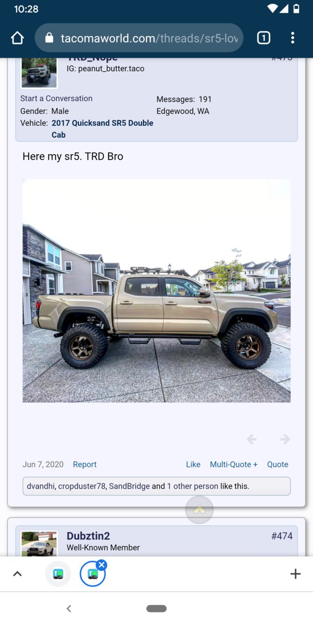

    Looks like you can do it a fellow forum member TRD_Nope did.Screenshot_20210504-102813.jpg

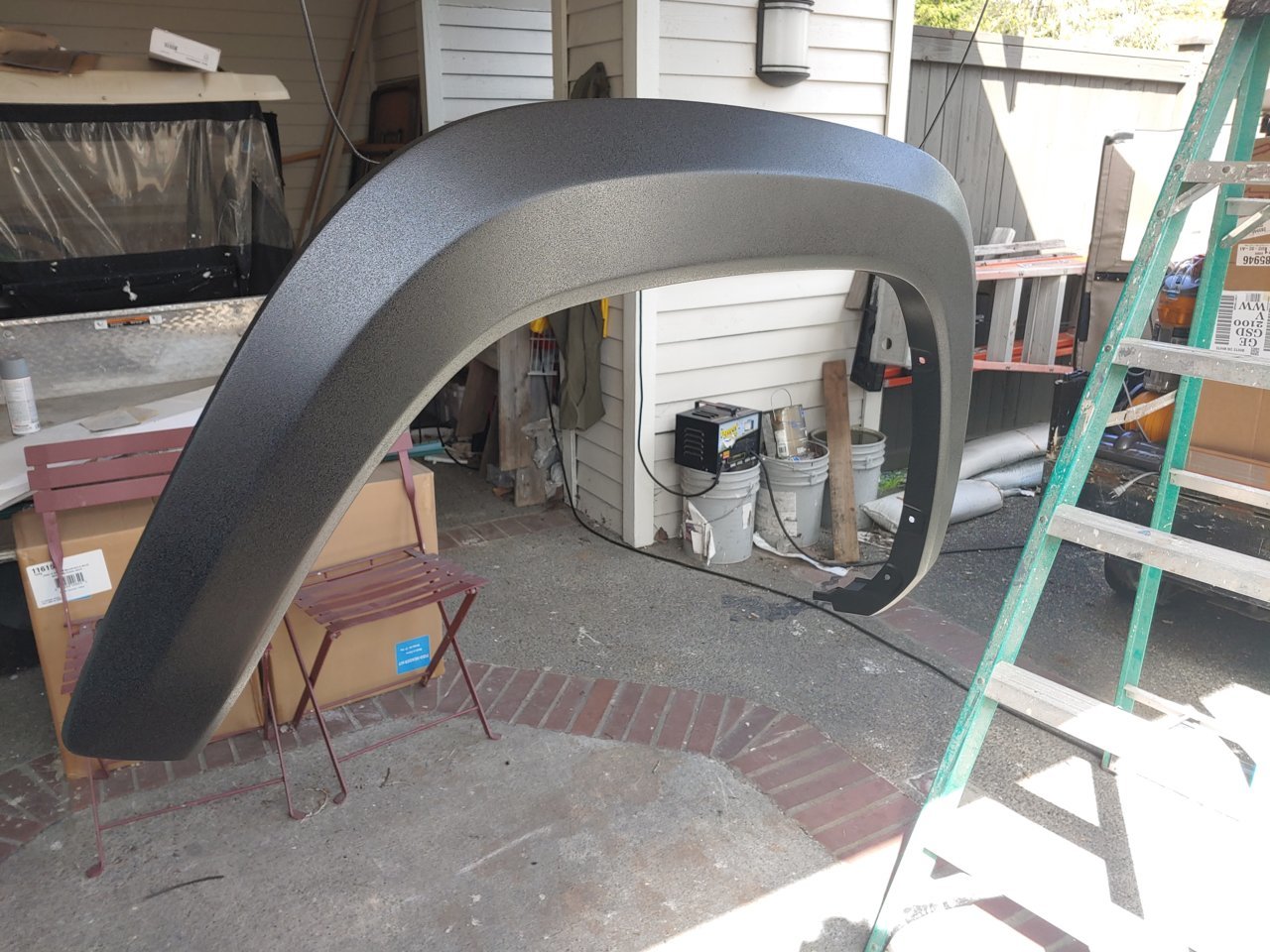

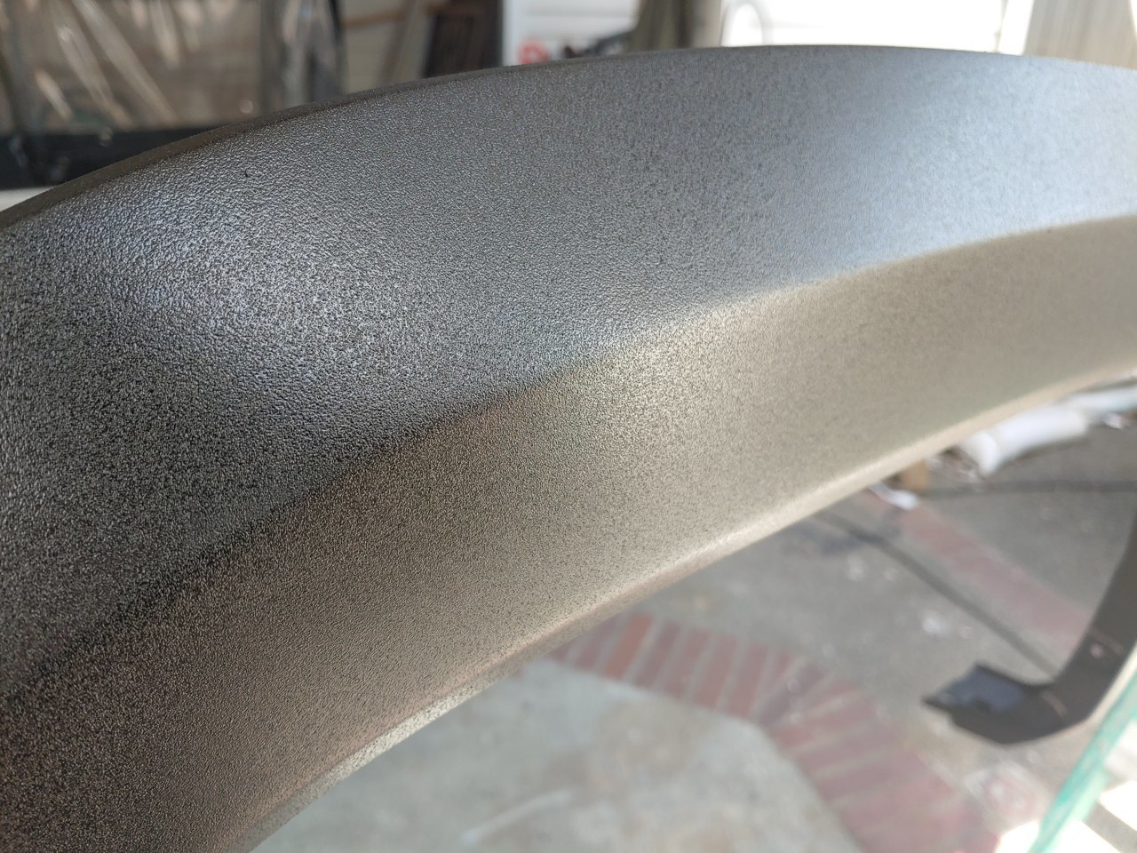

    Im going down this rabbit hole currently. I bought a used set of flares off fleabay, I think they were 250shipped for the set. I've spent somewhere around 50-75 on paint and sand paper. I used a Rustoleum sandable primer and their truck bed liner in the aerosol form. The texture isn't as overbearing as most liners seem to be but enough that it looks pretty good, afterward I put a few coats of some SEM trim paint. Haven't had time to install them on the truck yet so not sure on that.0502211544.jpg 0502211544a.jpg

    Those turned out great, you should take some pics on the removal of the painted ones. Im curious to see how much 3m tape they used and what pita it would be to clean up.

    From what I've seen in other peoples vids its used along the entire piece. Removal of the tape shouldn't be too bad, just use a heatgun. I'll probably polish the area up cause my ocd will get the better of me.
