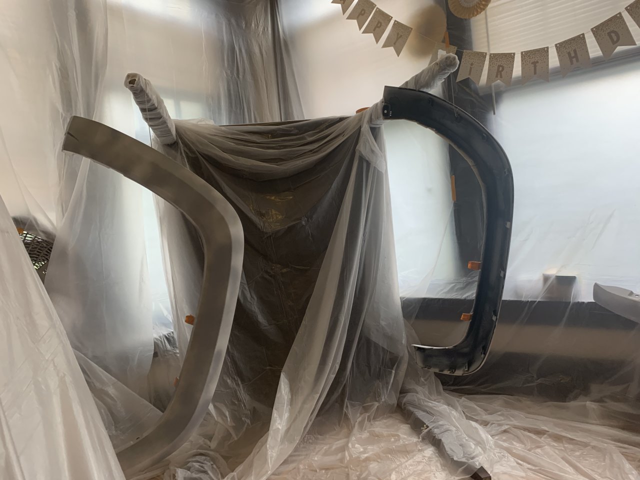

    I did mine last Summer. It’s incredibly easy if you prep correctly. I used Rustoleum primer and bed liner. Gave the fenders a textured look and protection from rock chips which is why I didn’t like the color-matched flares in the first place.
    I would suggest buying new fender clips on Amazon. I broke several trying to remove the flares. You can also buy the OEM adhesive which runs along the entire perimeter of the flare. I found this to be easier then using a roll of adhesive from your local hardware store.
