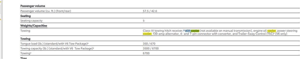

    Anyway, I was responsible for making the T-Day Chicken - only 2 couples ...
    I had a 2006 4L Tacoma 5 Sp, Auto Tranny Pre-runner and saw the Tran-oil cooler mounted in front of the Main radiator.
    On the material for the 2021 it says it has an 'AT Cooler'
    I open the hood on the 2021, 3.5L Auto Tran, 6 sp TRD Sport to check, and I expected to see the 'AT cooler' in the same spot . Its not there.
    Is something missing? Is this how it is now?
    Thus, the reason for my question.

    So, from my readings Toyota says in the literature that there is an ATF cooler included, but the external cooler is not there.
    The postings from the suggested thread on pgs 38-44 (
    https://www.tacomaworld.com/threads/missing-transmission-cooler.671079/) indicate that its not included.
    I bought the truck relying on the fact it had the cooler - since I tow our camper ( 1500 lbs) here in AZ and wanted the same ATF cooling as I had with the 2006 Taco, V6, 4L Auto tran Prerunner.
    1) Are you saying that the current dealer set up can give me the same cooling as before?
    2) If not what to do? a) return it to the dealer and explain the situation?
    3) Add an additional external ATF Cooler? ( which seems to be what the threads indicate)
    Truck is only 2 days old.

    I looked into this extensively. Adding an after market cooler opens you up to Toyota denying a warranty claim.
    I chalked it up to the idea that Toyota would not jeopardize their reliable name on a $50 part. There is a video out there (half way down on this page: https://pickuptrucktalk.com/2020/08/missing-transmission-oil-cooler-2019-2020-toyota-tundra/), where a Toyota Engineer explains why the external cooler was removed.
    Another consideration is that these trucks come with a 5yr/60k powertrain. As long as you don’t modify your powertrain (for example external cooler) you should be covered under warranty. As another level of protection I purchased Toyota’s premium 7yr/100k warranty

    I guess you missed this post in that thread? https://www.tacomaworld.com/threads/missing-transmission-cooler.671079/page-9#post-23573270
    There's a water-to-ATF cooler at the bottom of the transmission. You can see it if you looked under the truck next to the bellhousing on the passenger side. That would be what your truck's option sheet is referring to. This thing didn't exist in 2nd gens:
