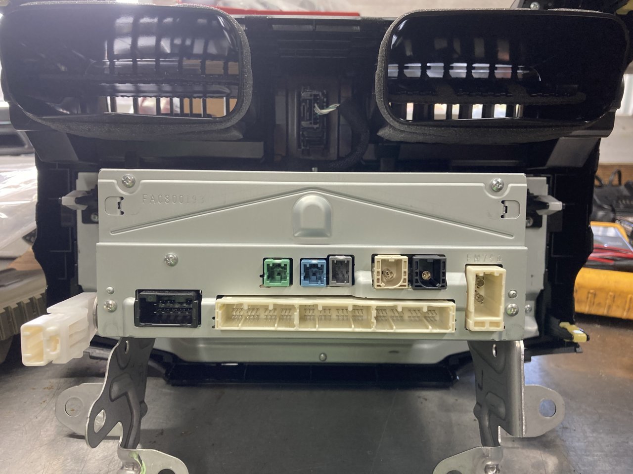

  12. Oct 31, 2020 at 7:08 PM

    Verify if this is or is not what the back of your stereo looks like.

    Green connector is missing, white connector seems to be relocated to left, the same PCB as the little blue and grey connectors

    The black connector is all of your speaker outs. You’ll need a male/female pair of that to run a T harness. You may also need a male/female pair of the long white connector on the left in that group of 3 to get a remote turn on.
    IMO you don’t need clean sweep, just something that will give you more EQ than the factory stereo that accepts high level inputs.
