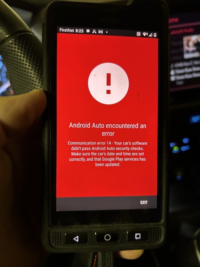

    I plugged in an android and the phone displayed this:
    So, I’m guessing the head unit needs and update? Need a dealer visit for that?

    You can update it yourself but I’d be surprised if the update does anything to enable CarPlay. Last time my 2021 head unit got an update was in early 2022 and that update didn’t do anything to change CarPlay in my experience.
