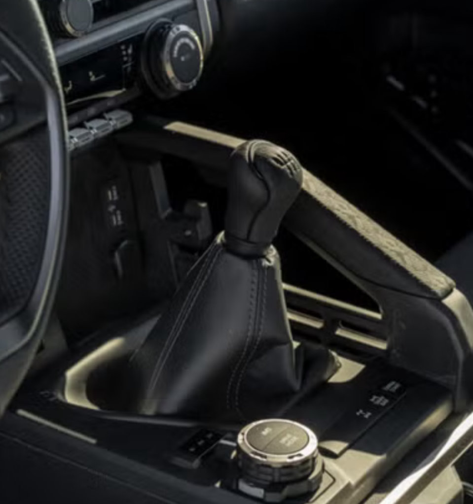

    Anyone know if the black ring under the knob shown here on the 4th gen would fit?

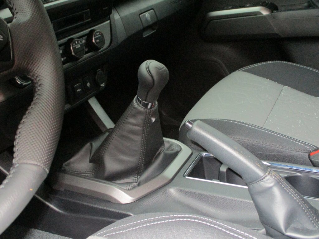

    I hated the padded gearshift on my truck --

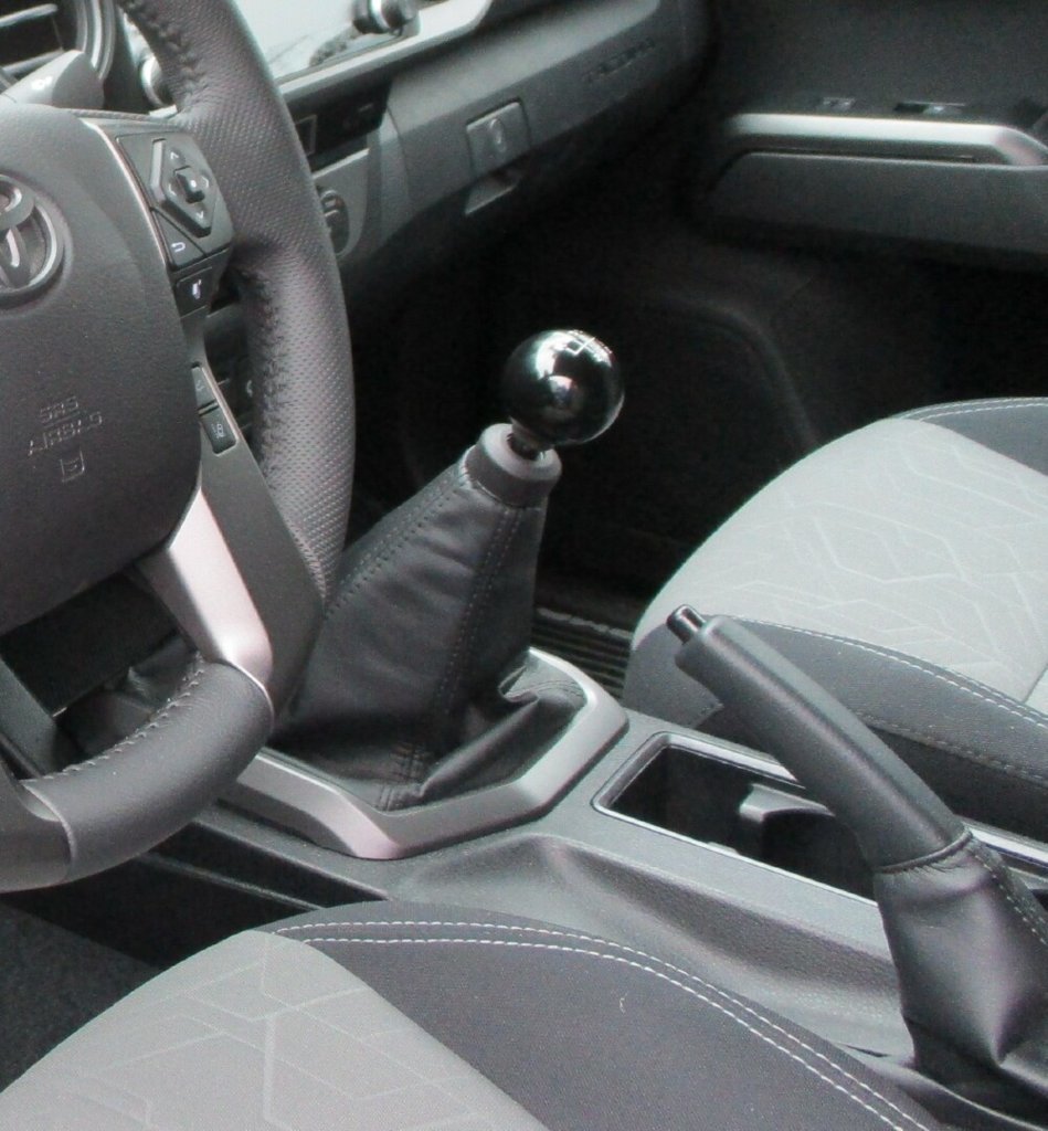

    Replaced it with this --

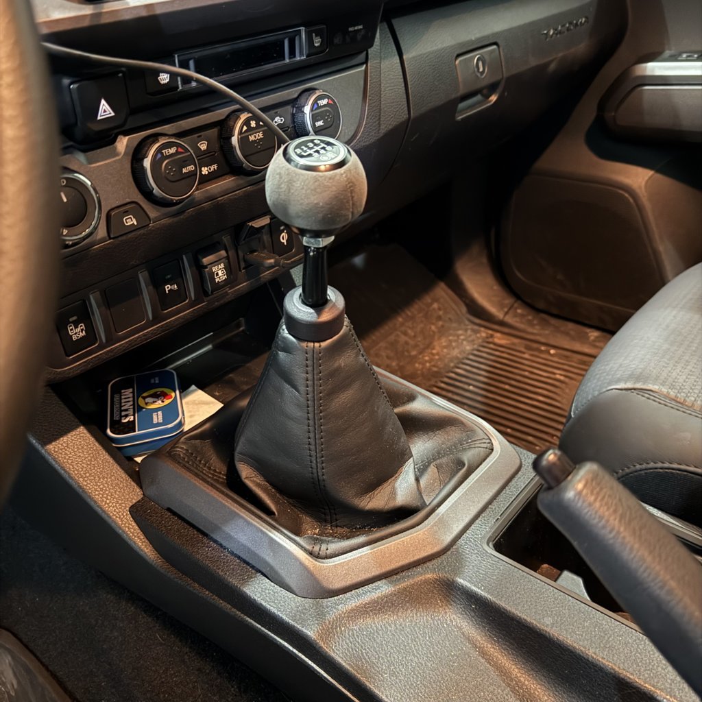

    This is my current knob:
    It’s not horrible to use, but the black locking collar at the top of the boot won’t stay put and it drives me crazy. That locking collar is something I got from eBay that’s 3d printed. Not a huge fan of having to use a jam nut on the bottom side of the knob itself either. Looking forward to getting something that fits and functions better.

    That collar looks just like mine. I got mine from the seller/maker on Etsi. I also had problems with it at the beginning, but I solved them by doing two things: First, I put an O-ring inside the collar, at the top. This eliminated the side-to-side play, plus it doesn't slide down the shaft as easily. Secondly, I turned the collar clockwise until it really locked into place. This took a moderate amount of force. You may think that it's locked into place, but it isn't.

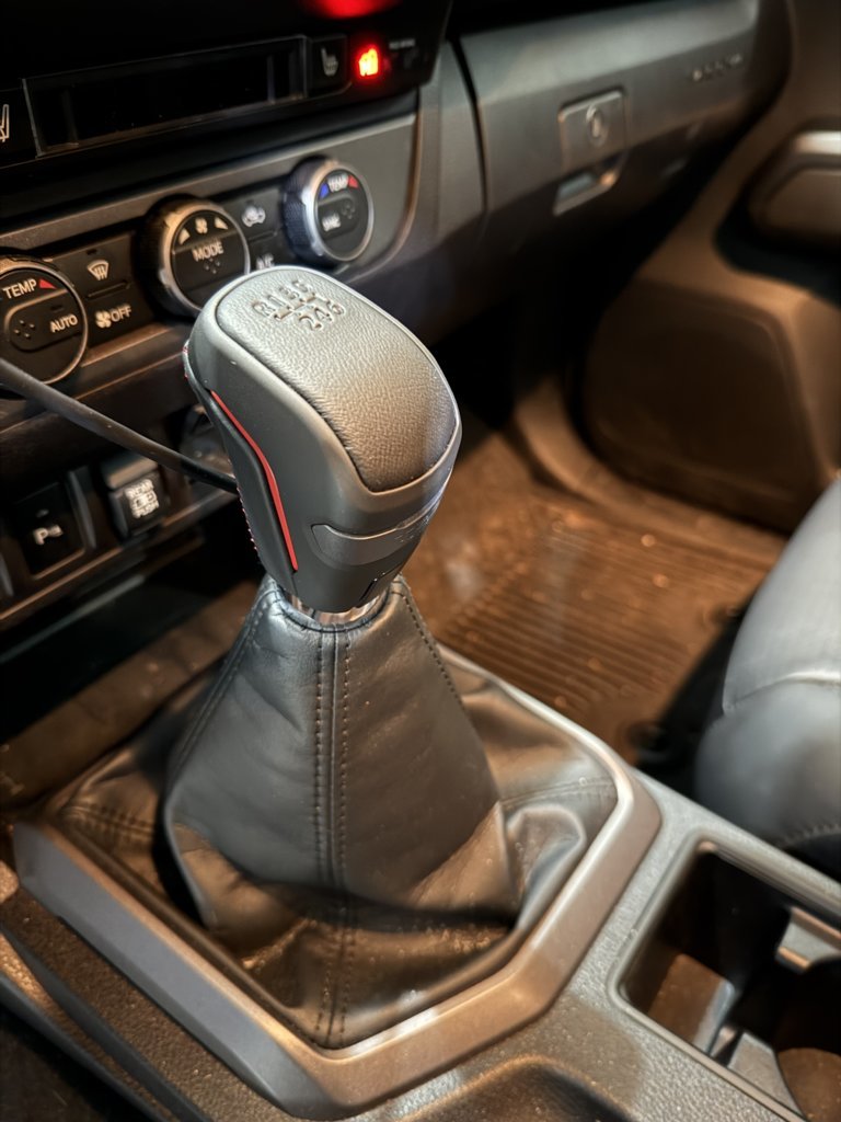

    Got the TRD Pro knob installed today! Wish I would’ve gotten it sooner!
