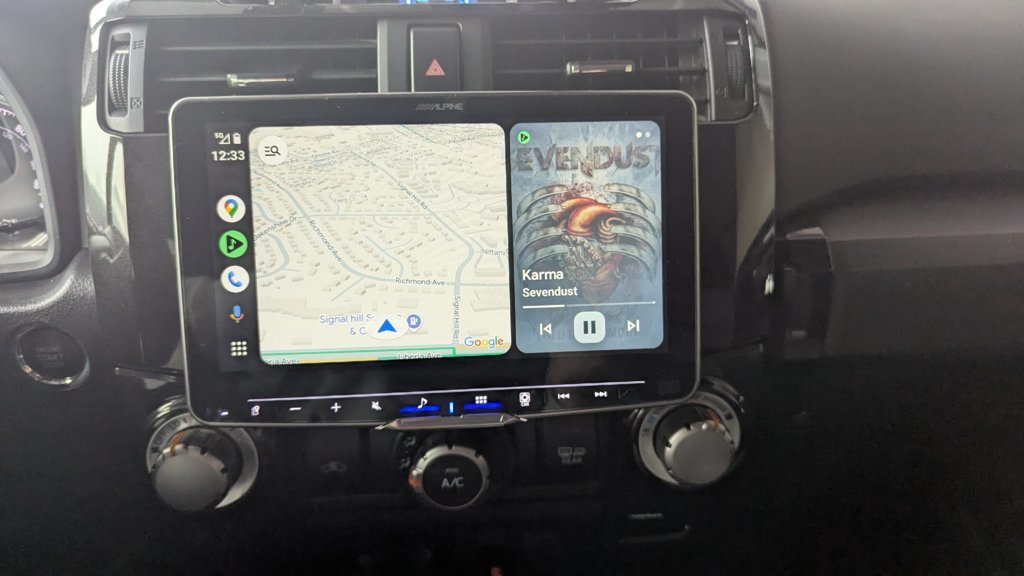

    Roof rack on. Headunit in. I have a replacement front bumper for my trail boo-boo. I'm going to Raptor Line it, but I know it'll have to be cut for the front bumper install. Not sure how wheel Raptor Liner will hold up to the heat of a death wheel.

    Decided to finish out the audio with Trail Grid's Alpine under seat sun and amplifier. Easy install. Sounds pretty good. Good enough for the 4runner.
