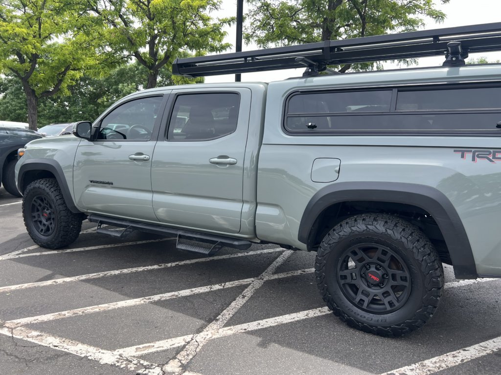

    4R TRD Pro rims, 265/70/17 ridge grapplers
    I have a 2021 TRD off-road with the 17” 4Runner pro wheels and run 265/70/17 ridge grapplers. I have never had any alignment adjustments made, and have never rubbed on anything. I had stock mudflaps initially, and now run tufskinz, and also no rubbing. Not sure why someone is feeding you lies about that size tire, plenty of people run that size with zero issues

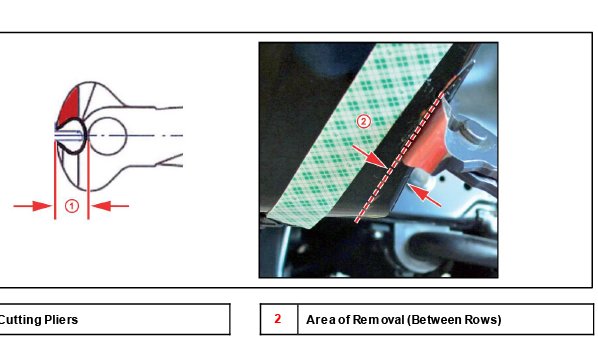

    Hell, even some 4Runner TRD Pros with 265/70-17 OEM tires rub the bumper cover, so Toyota issued T-SB-0070-19 to trim a corner off. The fender liner is also trimmed with two new mounting holes drilled, to tuck it higher: https://static.nhtsa.gov/odi/tsbs/2019/MC-10162789-9999.pdf Evidently Toyota didn't do enough fitment testing before coming up with the port-installed Pro package.

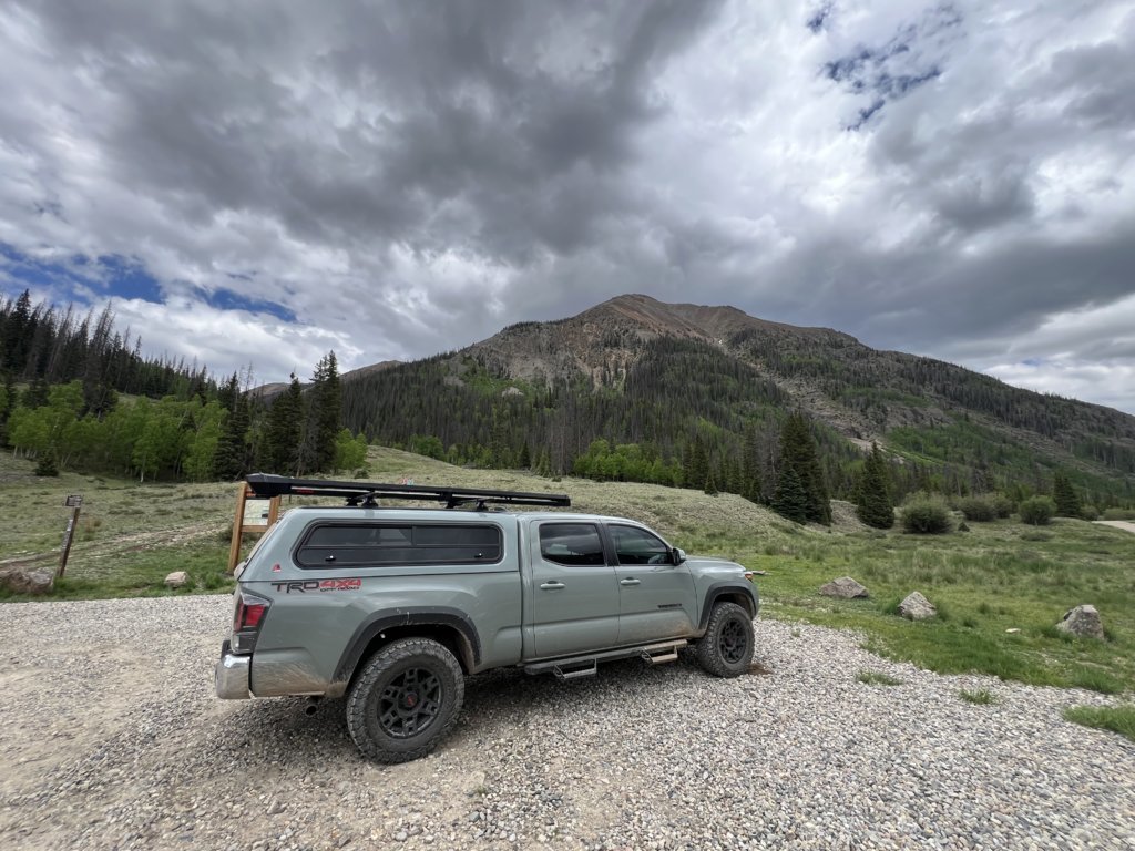

    265/70/17 BFG K02. No mudflaps and no rubbing!
