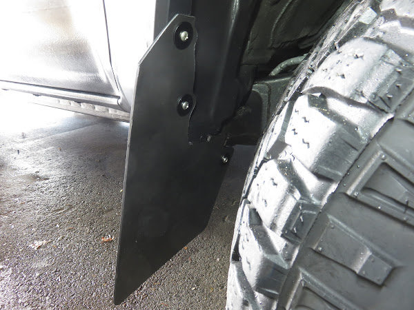

    You may still scuff the lower part of the fender flare plastic going up curb ramps or reversing, but the instances will be greatly reduced.
    If you want the road spray and gravel protection of flaps, you can get RokBlokz XL flaps. These go below the flare and attach to the cab mount with an L-bracket for max tire clearance:
    AP1GczPvCASXznfiEmP79ah69Cn2eiuQUI3G9P65_362bddd538482217c23100e8702634d73e6bb471.jpg
    By the way, which 4Runner wheels do you plan to buy, the TRD SEMA wheels or the newer TRD Pro wheels? The latter requires grinding the hub register on Tacomas.
