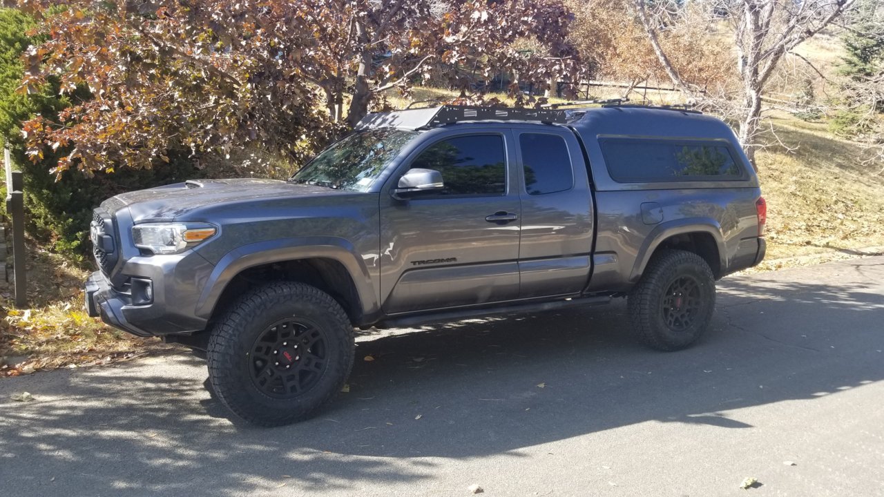

    19 Taco TRD-Sport
    Mobile Mechanic in Denver Insta - "Jfriday123"
    I'm located in Golden, CO and I can do a side job if you need someone to install your lift. Here is my 19 with Bilstein 5100 all around: 2 inch lift in the front/Back on stock front springs, and add a leaf plus a 1/2 spacer in the rear. Along with 33" Wild Peak Skinny 10 ply. No trimming or rubbing with the wheels.
