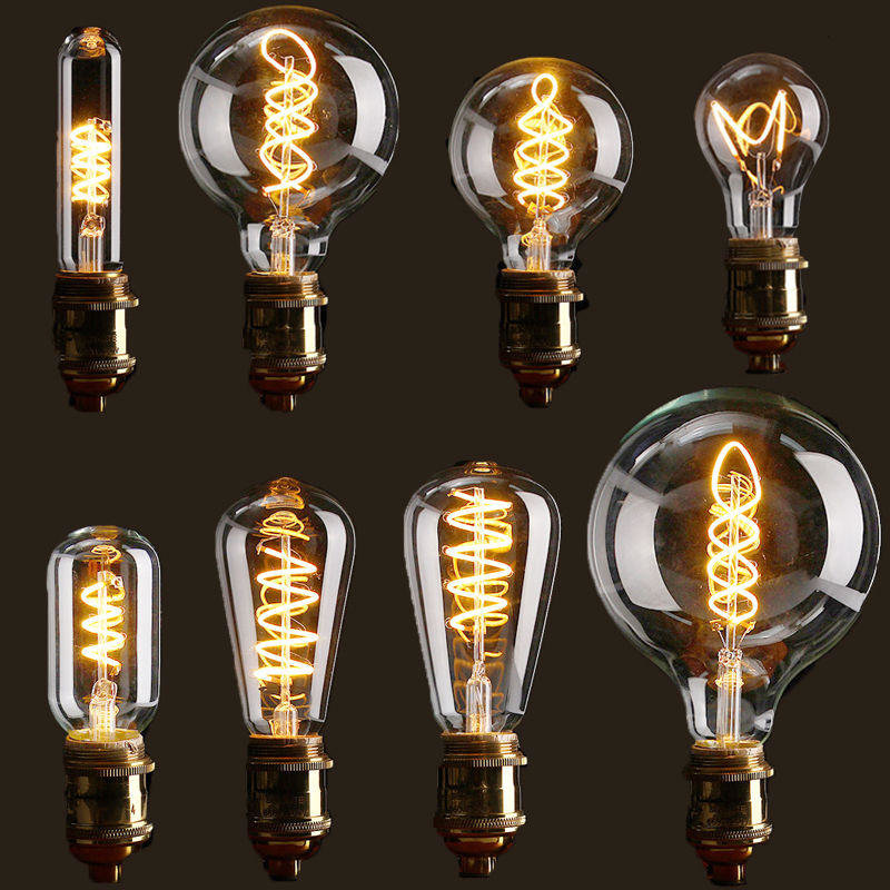

    If you look at some residential LEDs, they’ve come up with a way to emit 360 degree light from a coated wire, similar to an incandescent bulb. I’ve thought that developing this for replacement automotive bulb use could maybe get to the point of actually replicating a halogen bulb. However the output intensity performance isn’t there in the technology currently to match the needs for an automotive headlight.

    Yes, we see this in building flashlights (my other hobby). There is big discussion that happens around various emitters and intensity numbers. For the longest time the emitter that had the highest throw had relatively low output. Since the output per emitting surface was higher than other emitters it could push light out farther than other emitters, even emitters with ten times the output.
    There are some tricks to increasing intensity, unfortunately not anything that can translate to led bulbs. I wish I could get my hands on a busted oem housing as I have some ideas...

    I have the decorative wire type GE relax LEDs for my ceiling fans, as you say these are generally low power. These particular ones are 2700k, 300 lumens, 4 to a fan fixture and provide a nice warm ambience.
    House has been all LED for a while but I’ve began replacing the cheaper LED bulbs in my enclosed ceiling fixtures with CREE 60W equivalent 2700K 815 lumens CRI 90+. They are expensive comparatively but provide superior lighting and should last longer in my enclosed fixtures.
    I replaced the 4ft fluorescent lights in the closets with “Toggled” brand 4000k leds, I really like these, 120V, ballast deleted so no more failed starters or bulbs and come with wiring/sockets needed or can reuse existing if desired (just have to rewire using supplied twist on connectors).
    For the garage I bought an adapter kit to replace the 2 8ft fluorescent bulbs and starter with 4 Toggled LEDs. Garage ceiling is 13ft high and tired of replacing fluorescent bulbs and starters!
    Wife is sensitive to bright lights so no 5000-6500Ks for me, few years ago they retrofitted our office with these and I hated them as well.
    Please excuse the off topic talk but I was an early adopter of LEDs and pretty much converted the other engineers in the office to using appropriate K rated LEDs for different applications in the home, was a bit of a passion lol.
