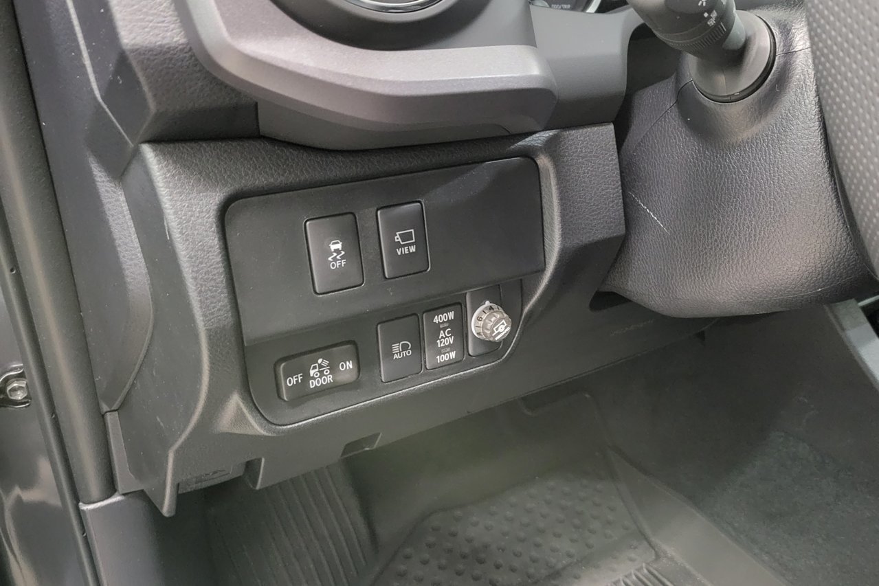

    I have a 23 TRD OR and installed the Redarc Liberty Pro and it's great. I tow my 4000 travel trailer easy as long as I keep the revs up to like 3k when going up hills. There's several YouTube vids on the install. I like the Red Arc because it works fantastic and looks factory. You don't need the RedArc Elite unless you plan to tow an off road trailer.

    Check out my build thread linked in my signature for pics, some towing lessons learned, and other stuff and be sure to check out this post for pics. You will see where your brake controller will need to connect to.
