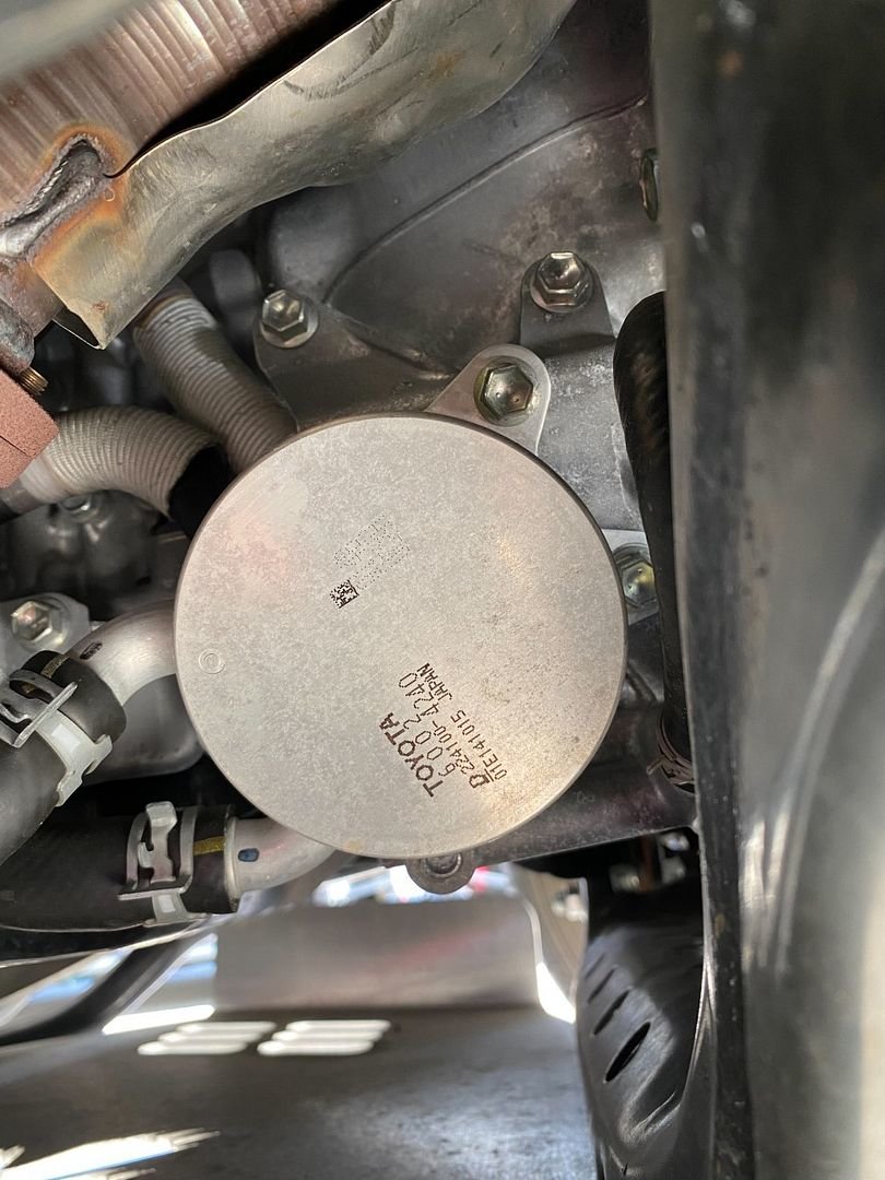

    This was done on a Tundra as described in this video (Cooler Install):
    Can you see the two white tubes coming out of the thermostat? (outlet & inlet) at 15:40. They are the same ones on this photo from my Sport:
    I just have to follow that tube to see where it leads to find the Trans Cooler portion.
