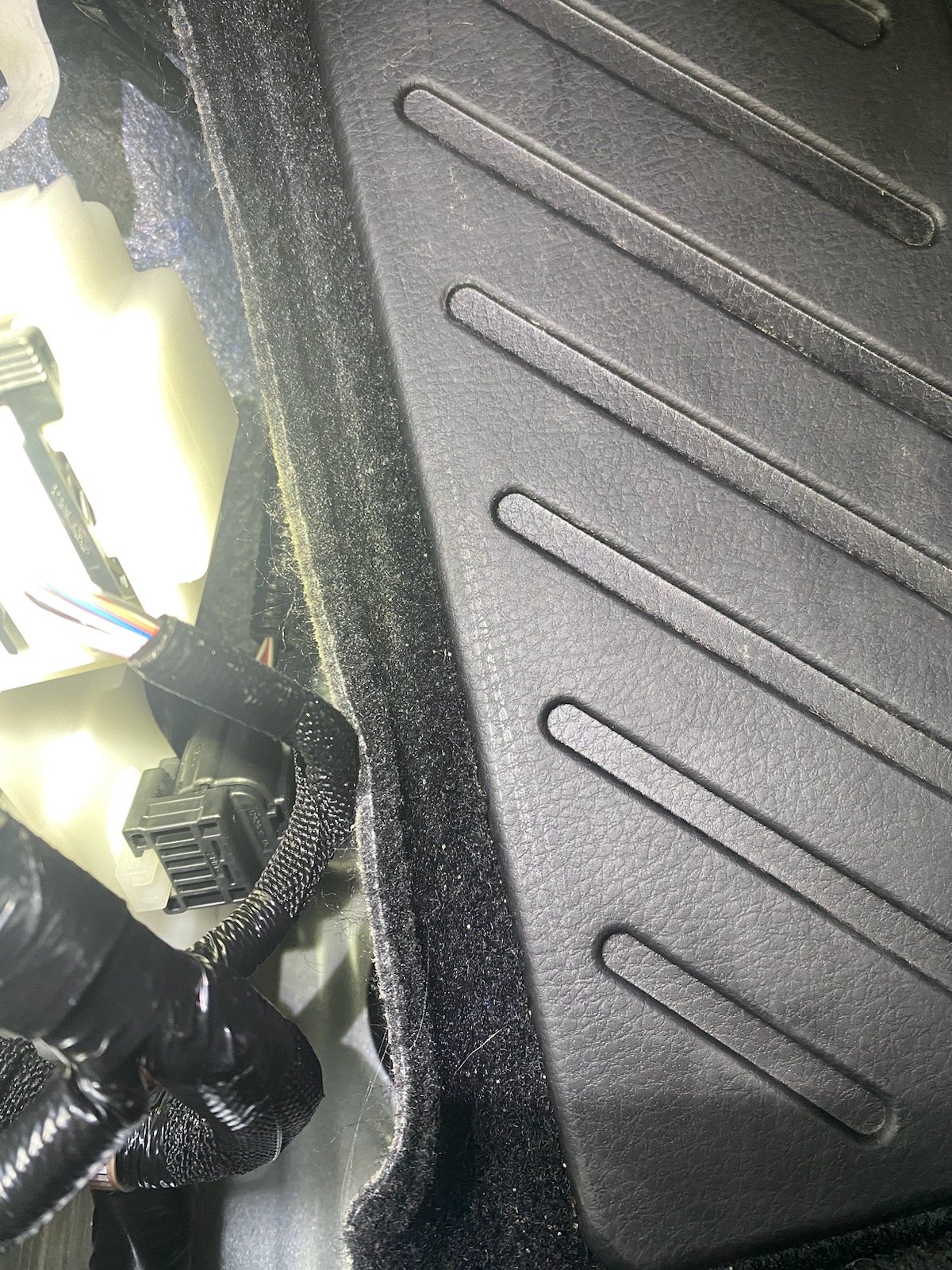

    Has anyone checked a truck with a factory brake controller to see if they could follow the wires? Here is my kick panel. There is a wire here that plugs into nothing.
    PUMPKINKING likes this.

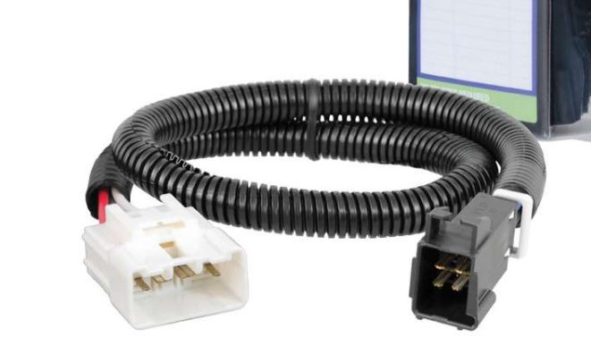

    If Curt is to be trusted (they say this works on 'select' 2024 Tacomas), the wiring harness will be rectangular. Unless there's a harness that plugs into the connector in your photo that has a rectangle output.
    The Curt harness:
    Trailer Brake Controller Harness (Packaged) SKU #51456 for $16.1 by CURT Manufacturing (curtmfg.com)
    PUMPKINKING and PDKTaco like this.

    PUMPKINKING, Williston and PDKTaco like this.

    I think that’s just the switch, there’s probably another part for the actual controller. And then Toyota would likely need to enable that feature.
