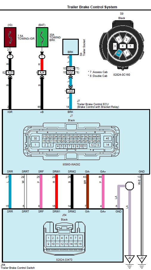

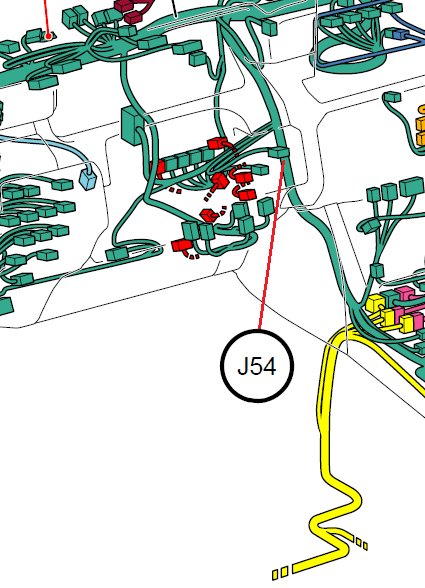

    upload_2024-8-2_19-14-32.png[​IMG]
  17. Aug 2, 2024 at 5:56 PM
    #37
    Polish Viking
    Polish Viking New Member
    Jul 6, 2024
    #452837
    2
    Dave
    2024 Tacoma TRD off-road.
    Is j54 the plug for the brake control wiring harness?
  18. Aug 2, 2024 at 6:25 PM
    #38
    caribe makaira
    caribe makaira Well-Known Member
    Feb 13, 2011
    #51121
    11,782
    Caribbean, Puerto Rico
    05 PreRunner TRD Offroad AutoTrans
    Hood Struts, My version Fogs always ON, Map & Overhead Light Mod,
    Brake control switch on dash.
    Dirtsifter likes this.
