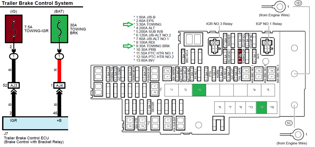

    This one is a done deal, all Taco have it. Fuse Block with multiple terminals.
    If Taco has the J7 OEM Trailer Brake Control ECU, Redarc can tap these wires.

    Instructions??

    Where behind the dash is the J7? Right side, left side?
    Would I have to run wires to through the cab to the battery too?

    Left side of steering.
    No wires to run, if you have the J7, those are the wires required to tap into.

    Right. Yeah. Makes sense if I have the J7. Not sure how to tap into that ECU

    You'd tap into the wires, not to a ghost ECU.:rofl::rofl::rofl:
