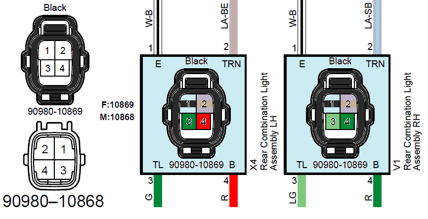

    Problem with turn circuit on 2024 is that they behave like the towing turn & stop circuit.
    B = Backup/Reverse
    TRN = Turn
    TL- Tail/Parking
    E= Ground
    daveeasa likes this.

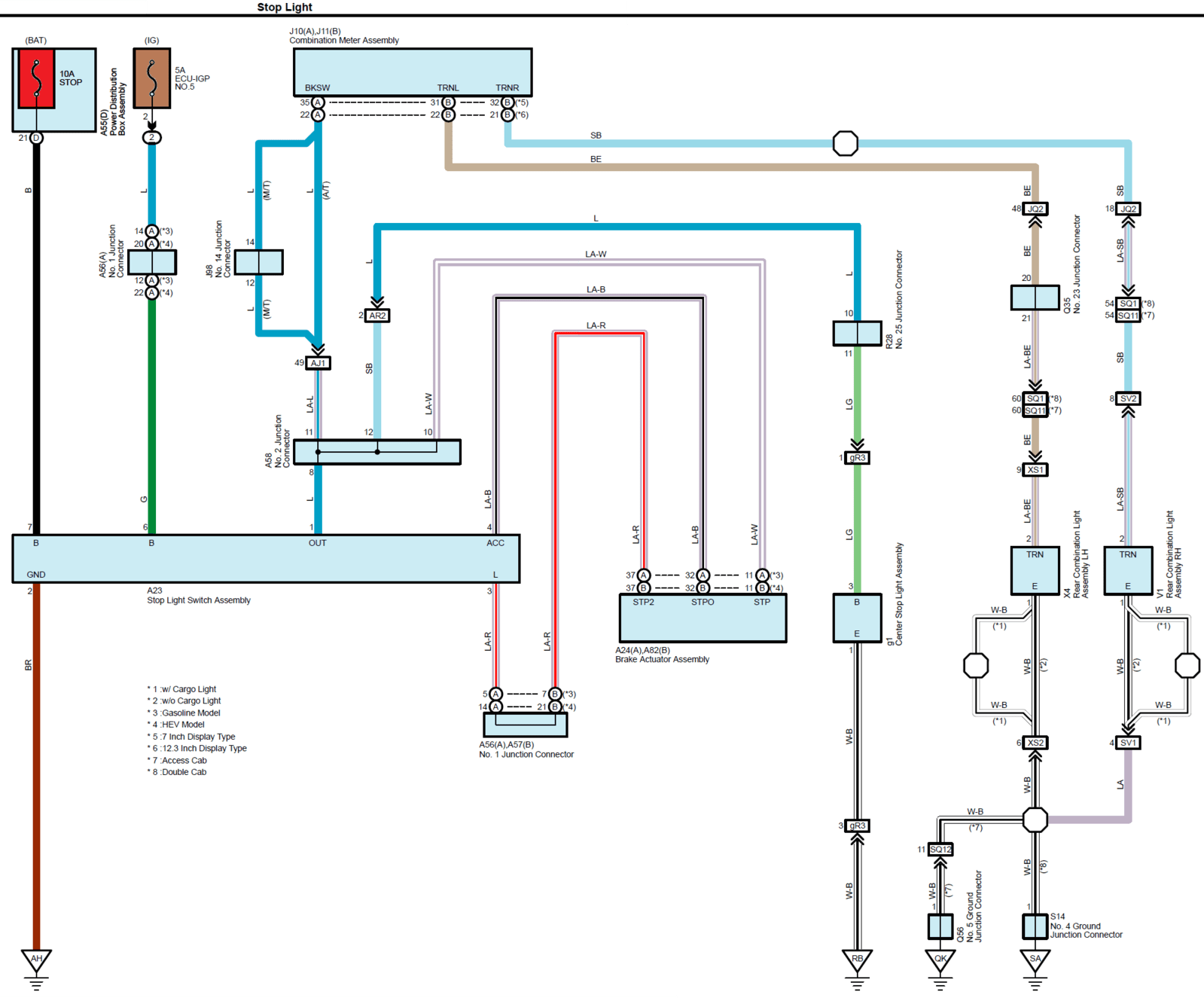

    Stop Circuit:
    Notice that the Combination meter assembly mixes the turn & stop to rear combination lamps. Only Center Stop light assembly is isolated.

    I’ve done taillight T harness pairs for one guy who did a module to extract a brake signal from the combined stop + turn on each side. Kind of a hassle.
    Then I have connectors for a cab 3rd brake light T which is an easier path but requires dropping the headliner and then routing wire from cab to bed. I need someone willing to test and prove that solution like @brhodea did for 3.0 Gen Tundra here:
    https://www.tundras.com/threads/truck-cap-3rd-brake-harness.147874/

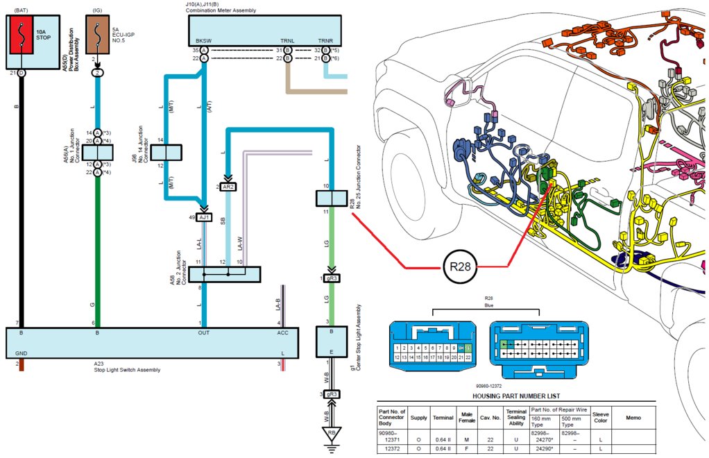

    Ok, so, step 1 is confirm wire colors and connector are a match to this spec. If so I can send you a T w 60" leads and you can button it up and test it out. So, drop headliner enough to visually inspect and grab a photo showing wire colors and connector.
    https://www.corsa-technic.com/item.php?item_id=969
    Medium Blue == This should be the brake signal. You don't really have to probe this but we want to confirm it's in the middle spot aka the 2 spot.
    White w black stripe == ground. This should be in the 1 spot so one of the outer positions.
    Light Green == This should be the cargo light signal. Again you don't have to probe this to confirm but it should be on the outside in the 3 spot.
    Technically these signals do exist in the driver kick panel as well but they are together with a lot of other stuff so much harder to identify and I don't have the connectors for any of that right now. If you want to muck around there you'll need to probe and take photos and count positions in the connector and be super clear and then maybe I try to find connectors but sometimes those are super difficult to source.
    You're effectively proving my theory before I send you something and proving you know how to take the headliner down without breaking your truck. Should be easier the 2nd time and you don't have to buckle it up tight if you don't want to. Follow the general steps here, noting that is a Tundra so an entirely different truck. Take your time and stop before doing anything you aren't sure of and ask questions, nice new truck so don't snap a piece of plastic trim by mistake.

    The 7 pin is stop + turn. For your 3rd brake light you want clean brake signal only without turn. Hence the cab 3rd brake light is the lone clean source. Or a “smart” module which can de-multiplex the two signals.

    Between cab panel.
