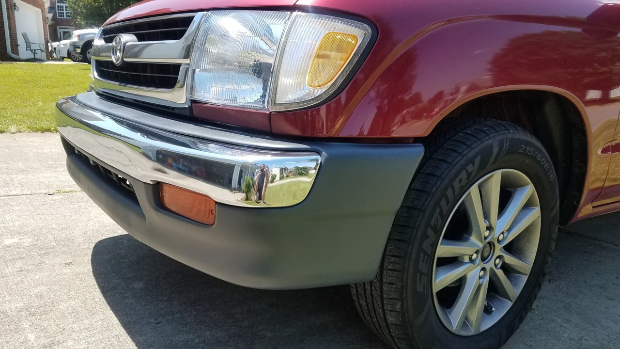

    So I ended up just keeping 14s and going with some Optimos at the stock size. now my steering wheel isn't conked from having 4 different tires in 2 different sizes! I also replaced the original shocks/struts all around to KYBs. That made a huge different in ride quality. I will be tackling the upper and lower BJs here soon, I already bought the parts from Toyota. Maybe one day I will upsize, but for now the 14s seem to do fine and were very cheap which is never a bad thing! :)

    I know you stuck with the 14s for now but in case you up-size later, I currently have 215/60R16 on Hyundai Sonata rims from ebay. Tires are less than 1/4" taller than stock 14" tire. Suspension is original and probably a tad lower than when it was younger and it doesn't rub. I have an extra cab but can't imagine reg cab would be that different. I think these wheels weigh around 20-22 lbs and it did make a slight difference in acceleration and MPG (lost about 1 mpg average) but I'll trade that any day to get rid of the hubcaps and 14s!
