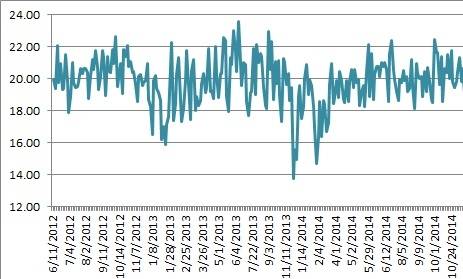

    Join the club...my MPG took a big hit last winter...
    In additiona to winter gas, lots of idle warm-up time and lots of 4WD is what I figure:
