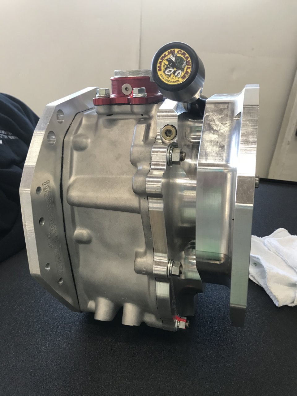

    Still need to work on the cross member support for it but we're under shelter in place orders and I'm pretty certain the steel shop is closed.

    @hoverlover did your crawl box come with the right adapter to a manual trans? Looking at trying to keep my stock transfer case with the crawl box.

    Yes it did but my crawl box is kind of a bastard. It's an Inchworm case, Inchworm marked adapters made by Trail Gear and Marlin gears. If they offer you one, don't take it. The case quality sucks and the adapters don't seal worth a fuck. I'll have to break it all the way down and seal it up properly.

    Just so we're clear, this adapter does not interface with the toyota case in any way. It connects the crawlbox to the trans. If you want to keep the tacoma transfer case from a manual and use it with a crawl box, you need to swap the input shaft on the tacoma tcase from an FJ case. Same thing you'd have to do to put an FJ case in a manual tacoma without the crawlbox. It's not difficult to do, it just involves splitting the case.
    As far as the spline adapter, it sounds like you should be able to get everything directly from Marlin now at no extra charge. Unless they run out of adapters and you find yourself in my position, it'd be pretty silly to spend the money with me. I'm here if you need me but hopefully you don't.

    I can call the shop and have either part made whenever but I do not keep these on hand and never will.
    Do your wallet a favor and call marlin first if you need one. I am not sure if they sell the separately, but it's worth a try

    Finally got my crawl box in. The adapter that came with it is a 22 to 23 spline adapter.

    Funny thing about that is that my understanding is that trail gear sold their last box of old inchworm couplers to marlin. :notsure:
    I am happy to help anyone who needs these, but I am going to encourage you to call marlin first because I think they'd sell you one of the inchworm ones cheaper than you can have them made. You're paying for a lot of machine setup time to produce small quantities. If you go that route, you can work with my shop directly as I dont need to be the middle man.
