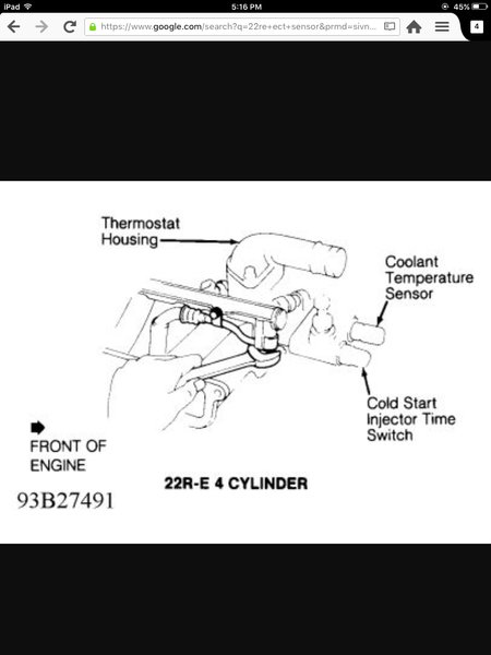

  11. Mar 8, 2017 at 4:27 PM
    santa4x4taco
    santa4x4taco [OP] Well-Known Member
    Jul 25, 2016
    #192859
    88
    Where is this ect seonsor?..also ive pulled the tps and idle just goes higher.

  13. Mar 8, 2017 at 5:17 PM
    Pickeledpigsfeet
    Pickeledpigsfeet Well-Known Member
    Sep 19, 2013
    #112813
    1,198
    Foothills, CA
    Right below thermo neck. Shown as CTS in this pic.
  14. Mar 8, 2017 at 5:20 PM
    Pickeledpigsfeet
    Sep 19, 2013
    #112813
    1,198
    Foothills, CA
    what codes do you have?
    It should be showing a 22 if it has failed.
  15. Mar 9, 2017 at 9:03 AM
    santa4x4taco
    Jul 25, 2016
    #192859
    88
    Not sure..havent jumped it to read the codes yet. And thanks for the pic
