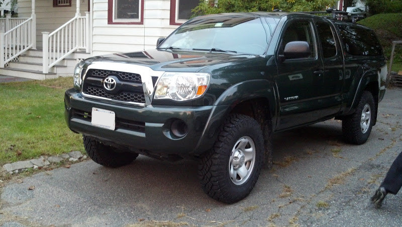

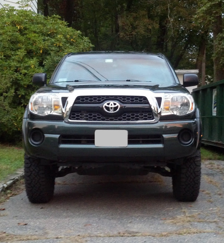

    Just got these put on yesterday. DuraTrac 235/85/16 with 5100s in the front @ 1.75 and as of these pictures, nothing in the rear. She is in the shop now getting the rear leaf TSB done which should level it out, but there is no rubbing at all in the front and it clears everything by a wide margin, so I can't see this size being a problem with the stock setup.

    That looks amazing! I drive my old hilux with 235/85/r16 in snowy crappy weather and the skinny tire does amazing! I will definatley be putting a set of dura tracks on the new Tacoma. And you get less road noise, and better fuel economy. Win win win!
