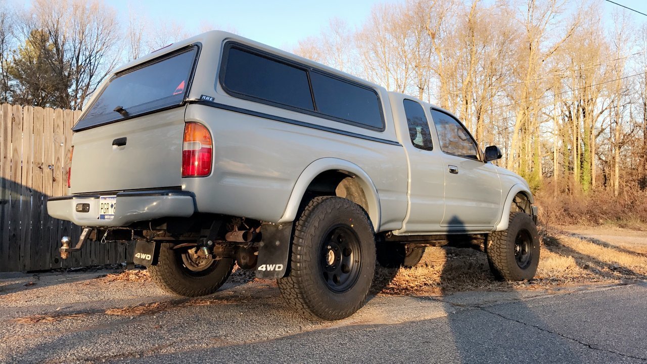

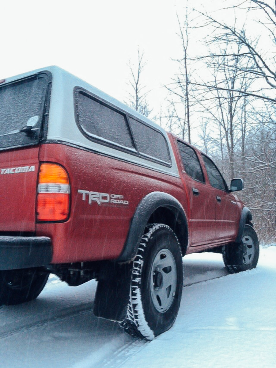

    Snagged some winter tires in that size for my PreRunner and I'm sold on this size from now on. They are E-rated but at 42lbs/tire they're actually a little lighter than the D-rated 31X10.5X15s I had on over the summer.

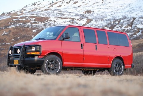

    Need a lift to run 255/85's, my toyos measured 33.5" new!
    For my family rig I've got a "lifted" GMC Savanah (Chevy Express) that has been running 235's and I have nothing but praise!

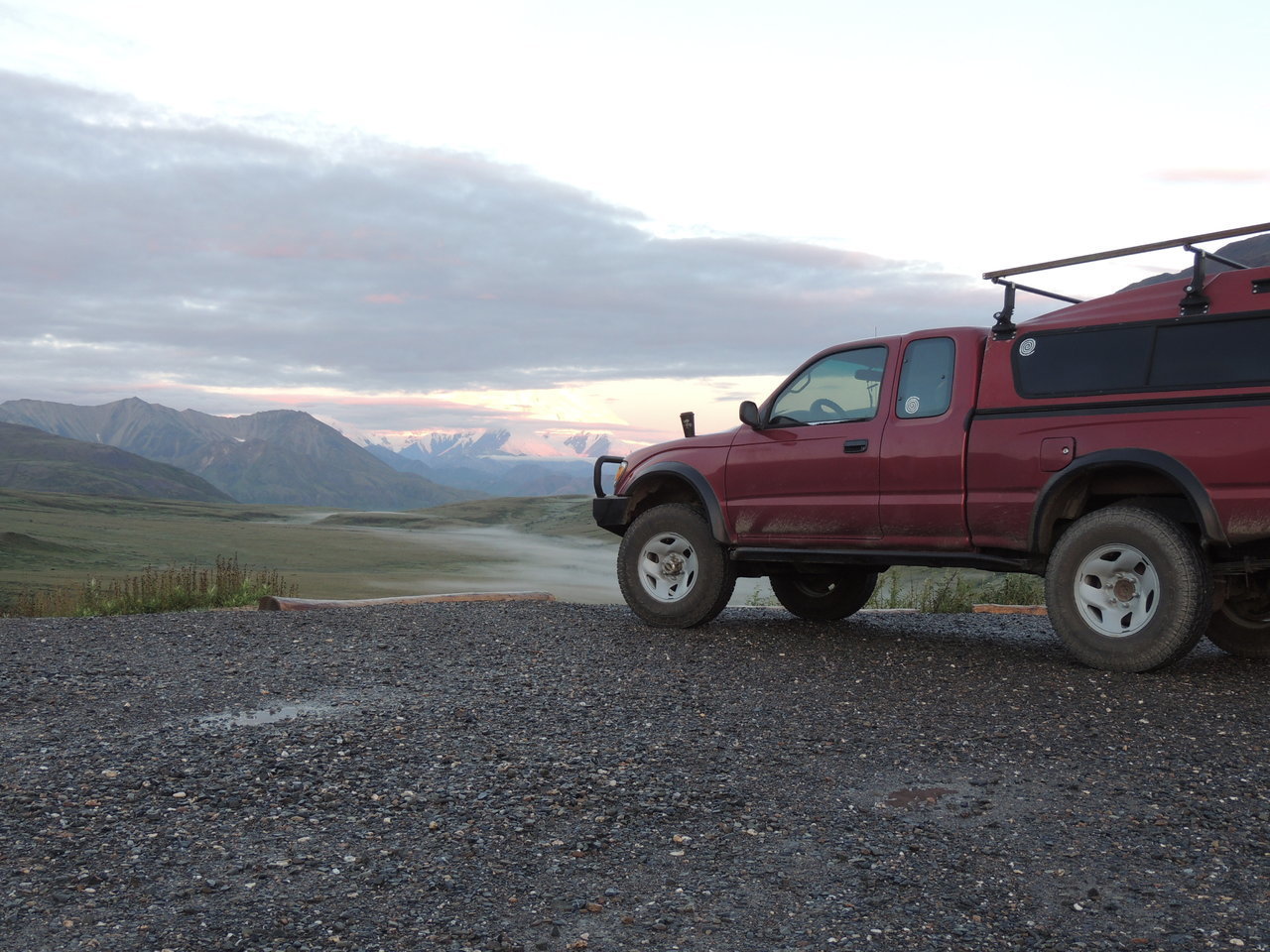

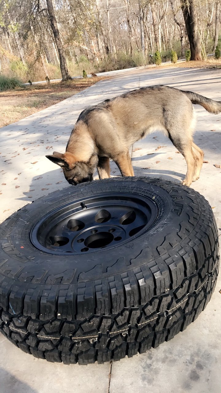

    These are 265/75/r16 falken wildpeake AT3's i just got for my taco. look really awesome!! drive smooth! i dont hear any noise from them at 20-80 MPH

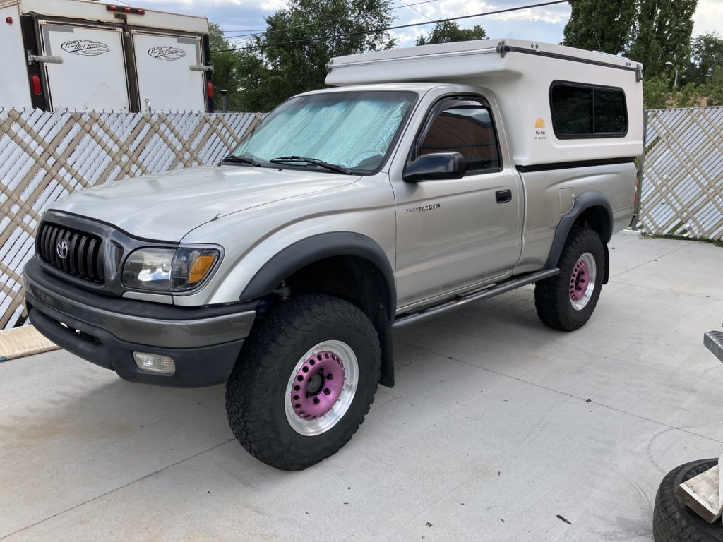

    All day long! On 6.5 wheels, 0 offset.
