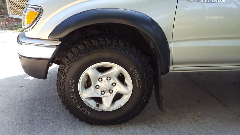

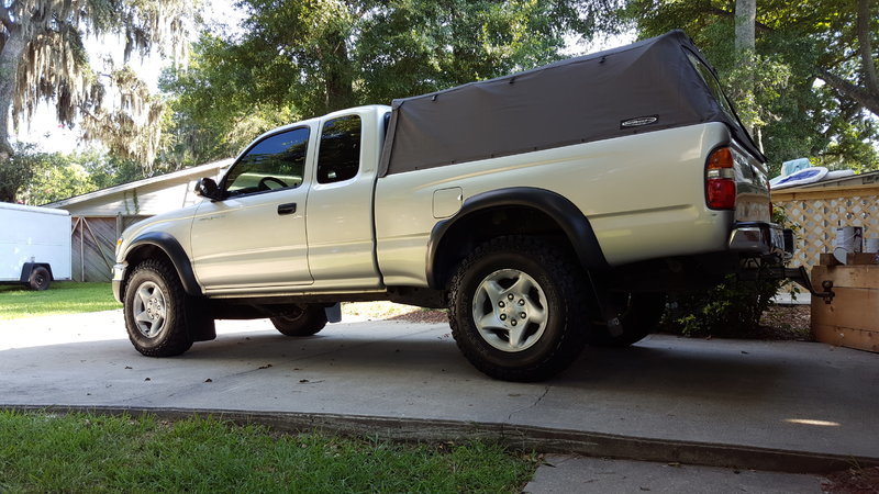

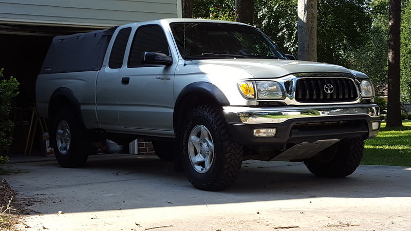

    Iv searched and iv come up with very few people who have done this set up and who could post pictures so I just wanted to show everyone what it looks like with 235/85 r16 on completely stock Tacoma. I went ahead and pulled the trigger on buying these tires and so far I'm happy. still in the works for setting proper tire pressure
    Kenda Klevers MT E rated 235/85 r 16. EBay 550$ shipped to my door.

    Do they rub any?
  3. Feb 13, 2016 at 2:00 PM
    guzzytacoma
    guzzytacoma [OP] Member
    Feb 13, 2016
    #178053
    16
    Alex
    2004 Tacoma SR5
    daily driving it, no. hard bumps during a turn yes. I'm planning a lift though. but right now the most it will see is a dirt road

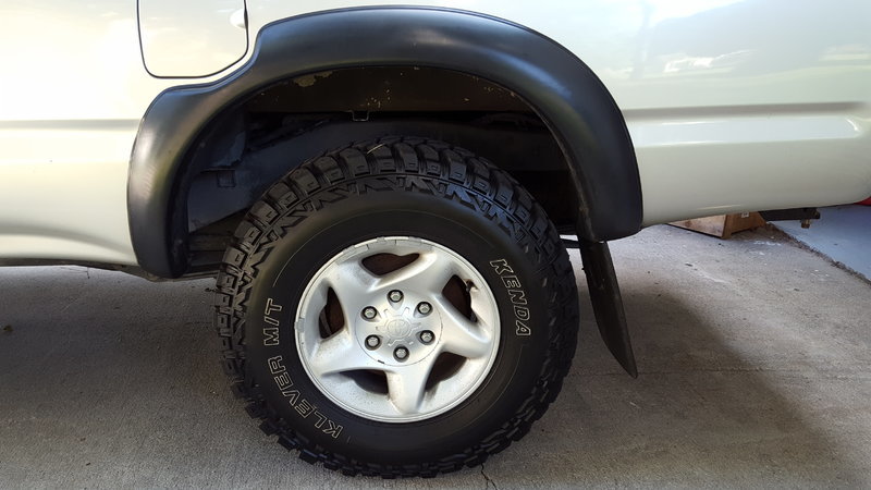

    you can see how close it is to the fender here

    starting with the front: center of hub to fender 20 and 5/8 inches. rear: 21 and 5/8 inches. hope this helps. 20160726_171418.jpg 20160726_171834.jpg
