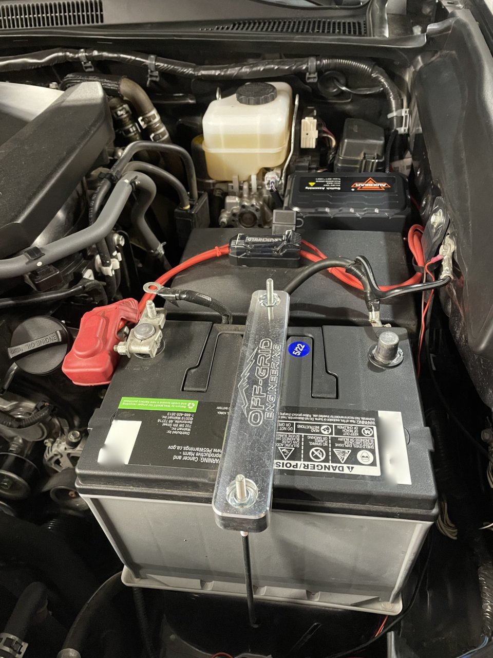

    I went through this same battery research debacle. You can spend $300 or more or do what I did.
    I've got a 24F Everstart AGM from Walmart with an off grid engineering battery strap. It's 710CCA and plenty of juice for an aftermarket stereo system, lights, and other accessories. They're around $170 and that includes a 4 year free replacement warranty. I don't think you'll find another AGM with those features at that price point. Noco Genius 10 keeps it topped off about once a month.

    615
    2018 TRD OR ACLB AT
    Just replaced my 24f with interstate 27f and Toyota 27f tray after the OEM 24f failed.27F is a Lighter weight, larger battery with more reserve and more CCA. I refuse to install any battery that’s heavier than the stock one due to the cracking sheet metal heavy battery issue some Tacoma owners have suffered with.

    Is that the factory tie down or did you have to swap it for a different size?
  18. Jan 8, 2023 at 10:28 PM
    #38
    Benny22
    Benny22 Well-Known Member
    Jul 28, 2022
    #402333
    265
    20Tacoma
    Factory. the 27f is only a bit wider.
