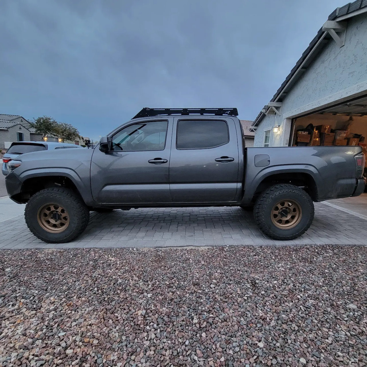

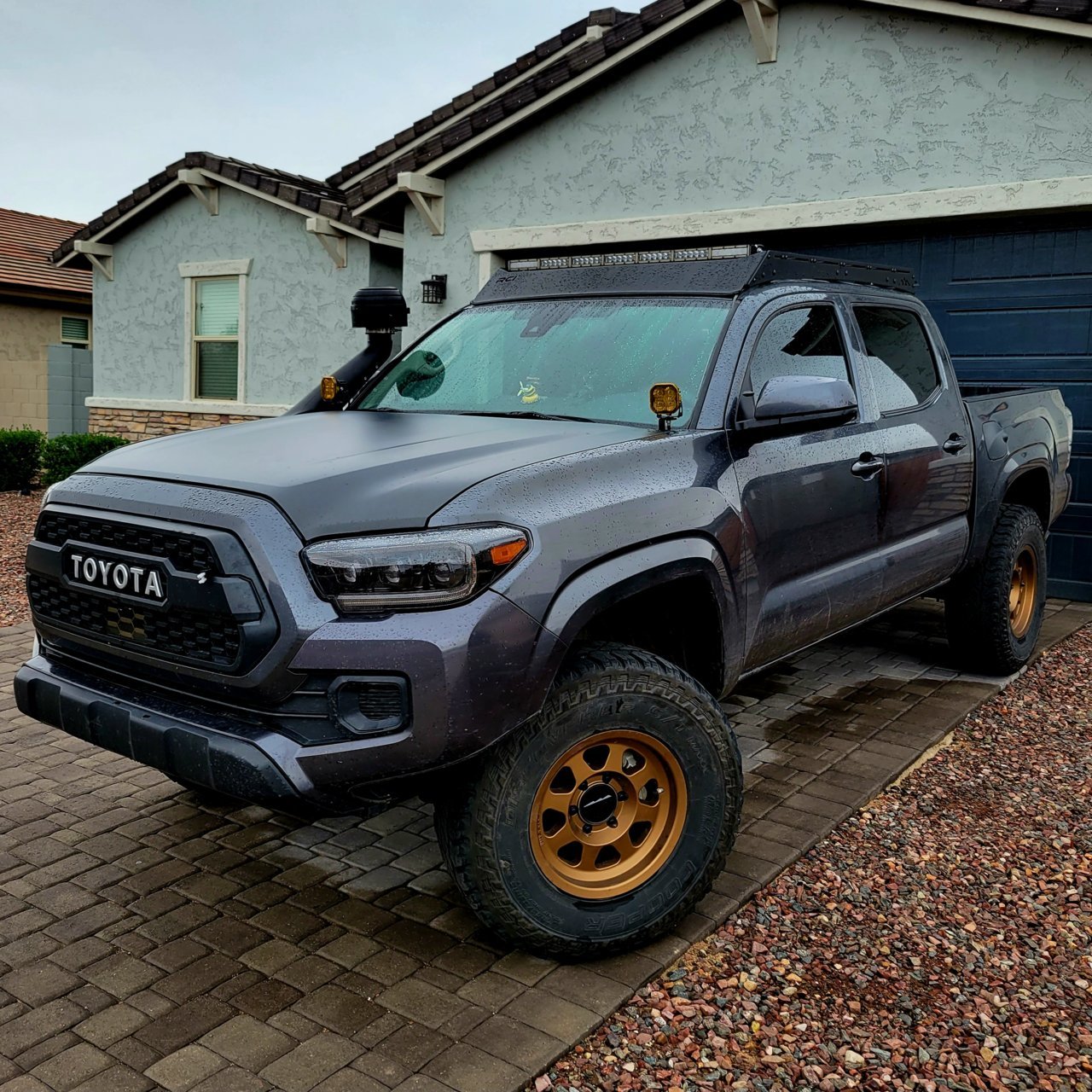

    255 85 16, 6112/5160/Icon AAL, 701's. Great set up, very happy with it.
