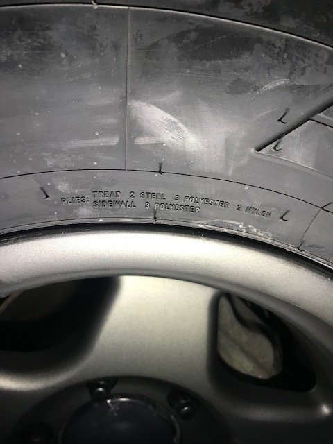

    I just got my ridge grapplers installed today. I have been a typical lurker on TW and never posted but hopefully this helps you guys out wanting to know about the sidewall plies.
    My tires aren't pizza cutters but pretty close. LT265/75/16 with SCS F5 16x8 -25.
