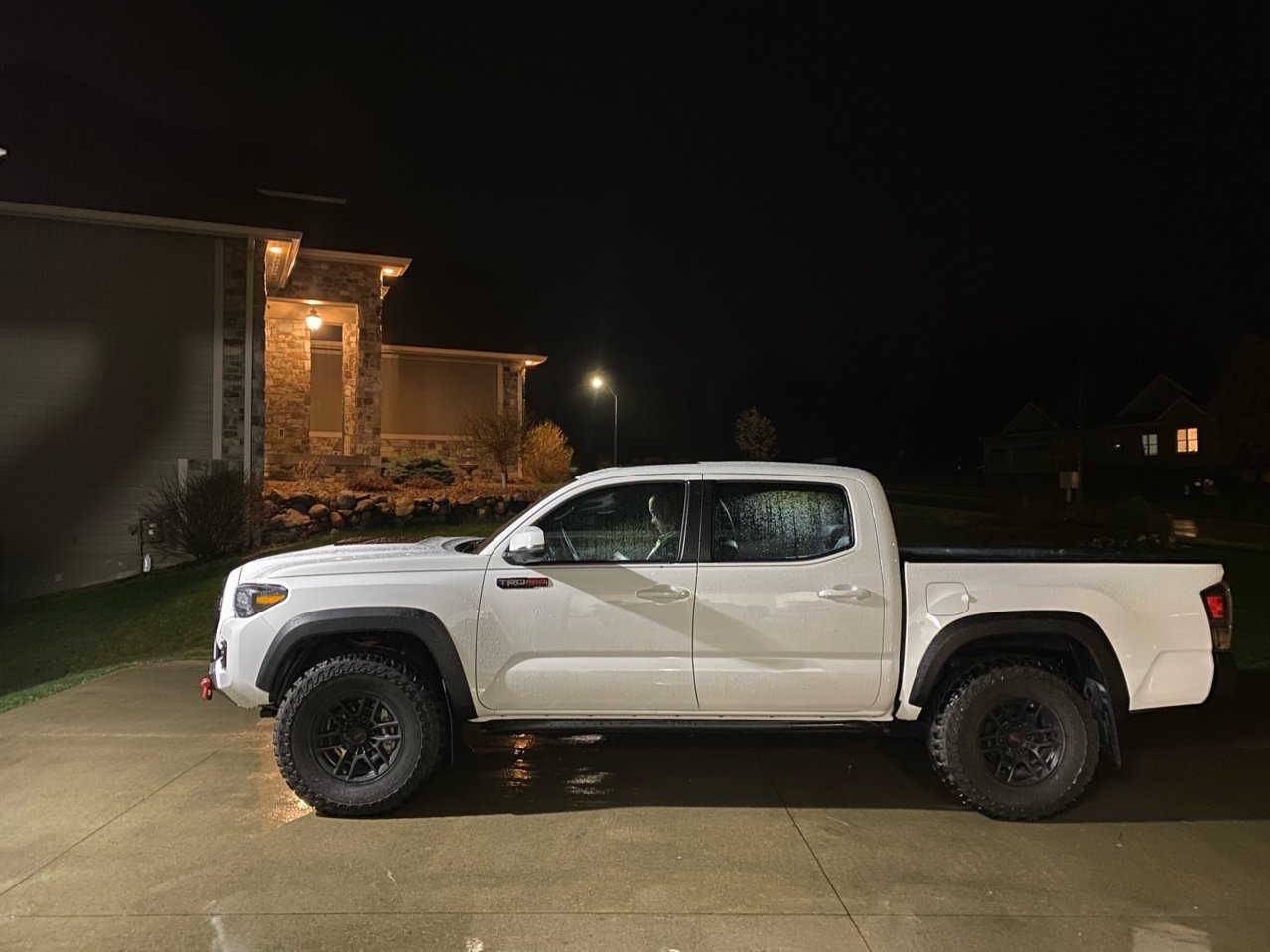

    Any side pics?

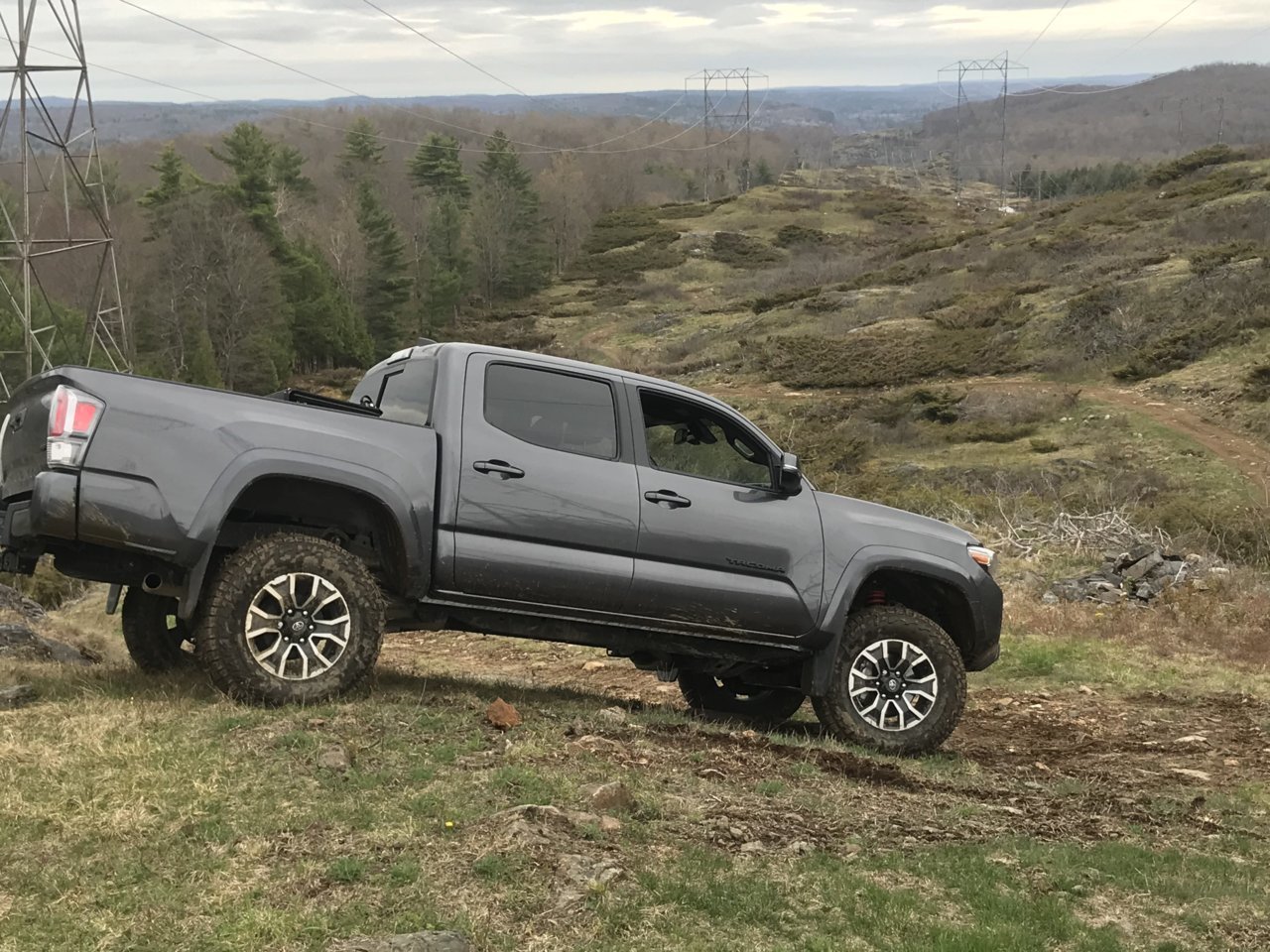

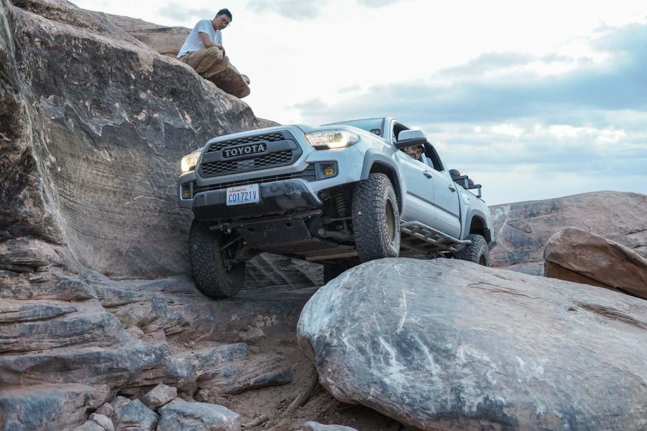

    I ran my 35x10.5 on a 8.5 wide wheel for a week in Moab at 10 to 15psi. Folded the tire over the wheel a couple times, bottomed out the wheel a couple times rallying through the desert, and grinded the wheels on every rock there. Never debeaded suprisinglyPSX_20210503_184802.jpg

    Much thanks and looks great! I have a coworker that is practically giving me his TRD Pro suspension, and I am seriously considering ditching the OME setup I have to go back to "stock". Wanted to see how my 255s might look on the Pro suspension.
    Edit: Is your suspension completely stock (no AAL or spacers)?

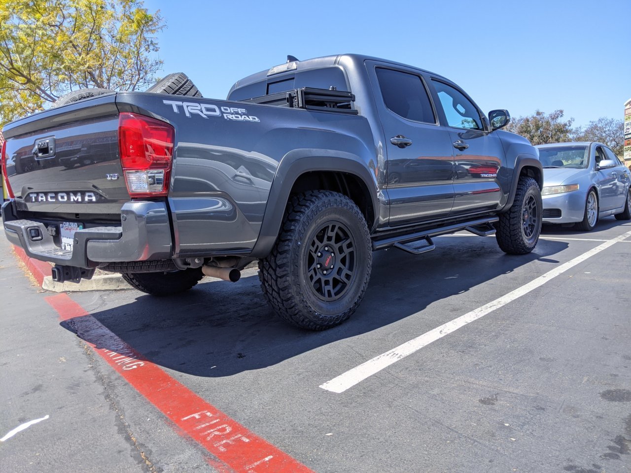

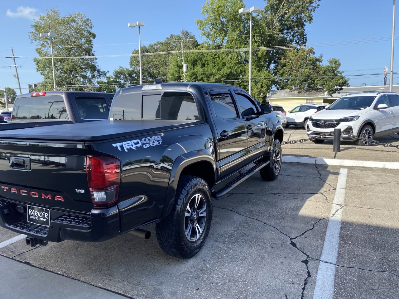

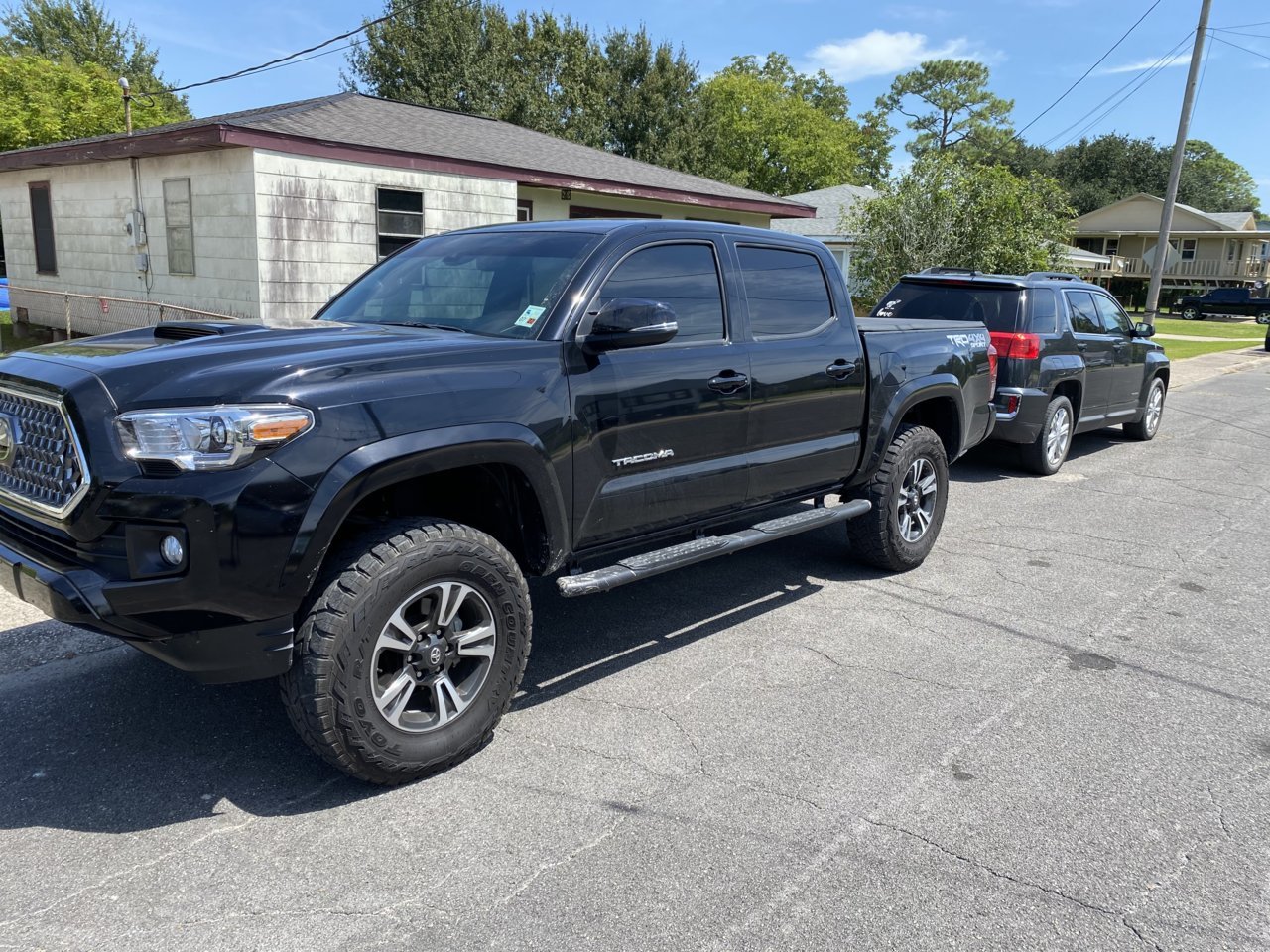

    No rubs on city driving 255/80/17 Coops, T4R TRD Pro rims, stock OR suspension.. just paying it forward

    And what about desert driving ? When the wheel is fully cycling up down constantly + turning?
    I quickly realize how full of sh*t (not saying you) every tire thread was when anyone said; "X,Y,Z tire clears". I think it's coming from people who's suspension never ever gets close to bottom out (street use / lifted ) or if they do off road it's the typical turtle off roading where "flex" matters. So even then you rarely fully bottom the tire for extended periods of time. The most difficult situation for tire clearance is desert trails with lots of suspension cycling. From my experience the biggest tire you can clear with no rubbing is 265/75r16. I want to run these tires but I'm sure it will hit the inner fender at turn and cycling through woops.

    I completely agree with you, there are folks on here that post don't rub but don't specify in what scenario which can lead to false information then you're down the drain a few grand with something you probably didn't want. This is why I underlined "city driving".

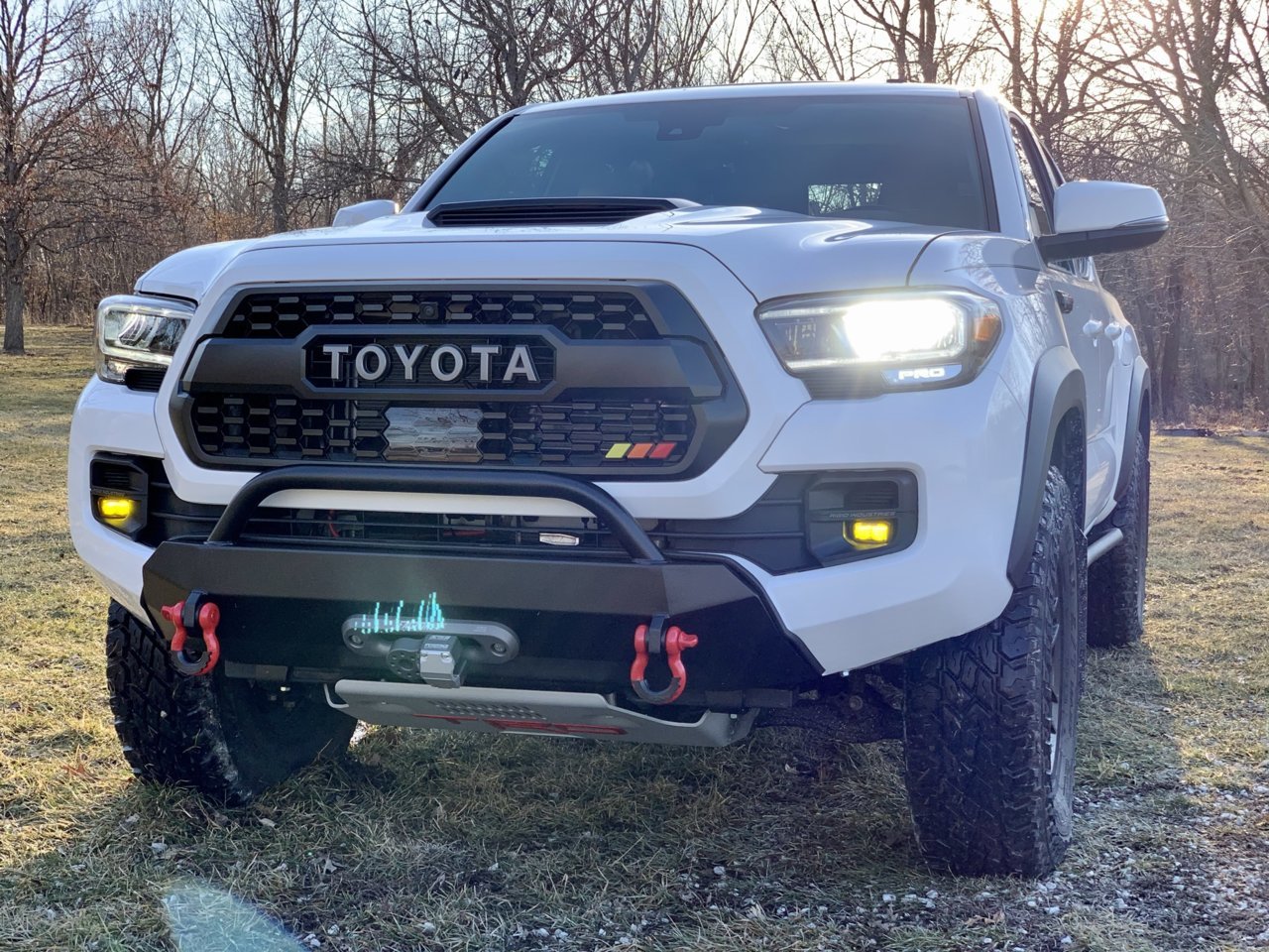

    Thanks, yes suspension is fully stock. Would consider the lift with heavier springs from Eibach if they ever produce it. My front is down about 5/8” due to steel front bumper and winch.
