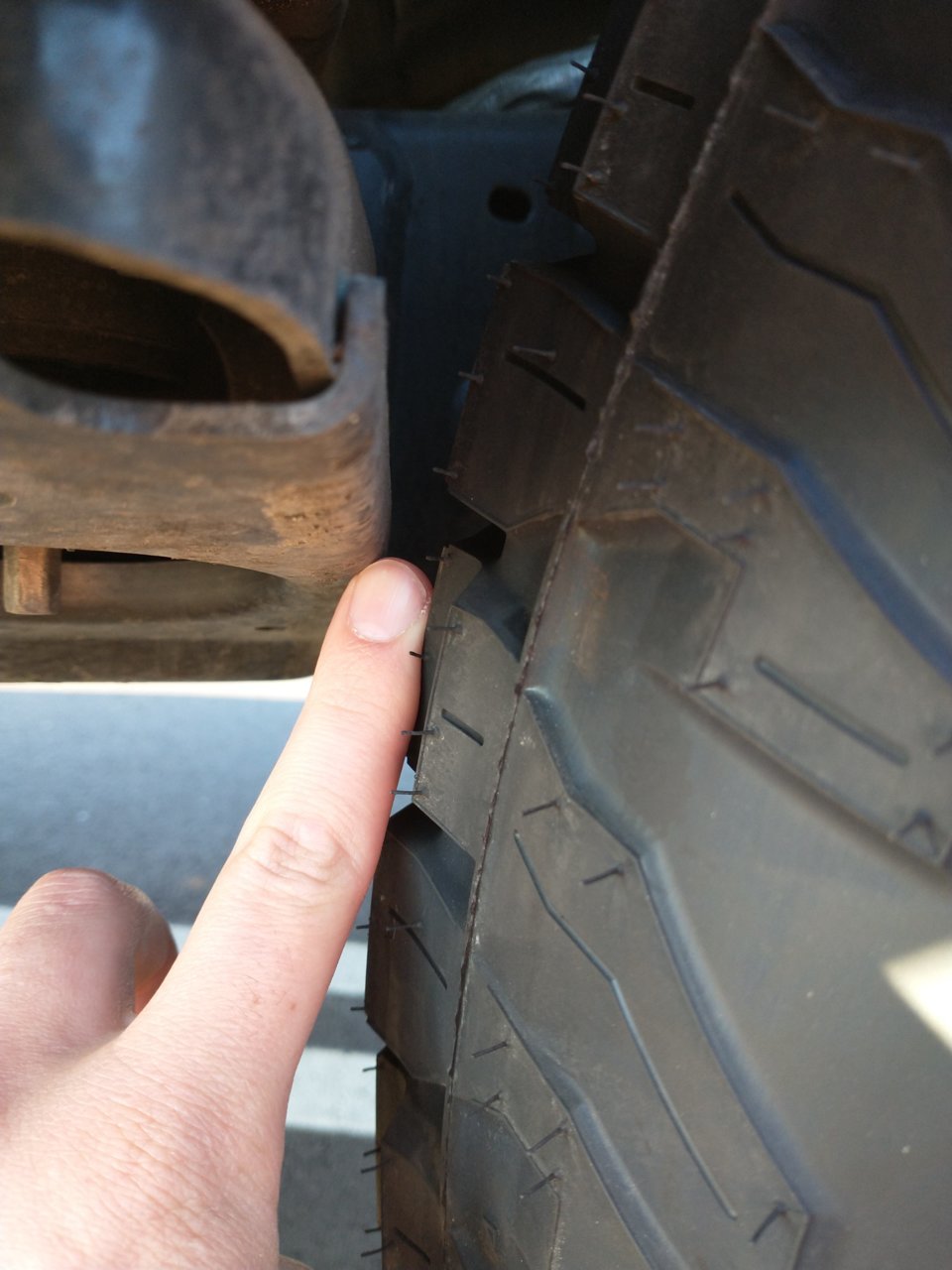

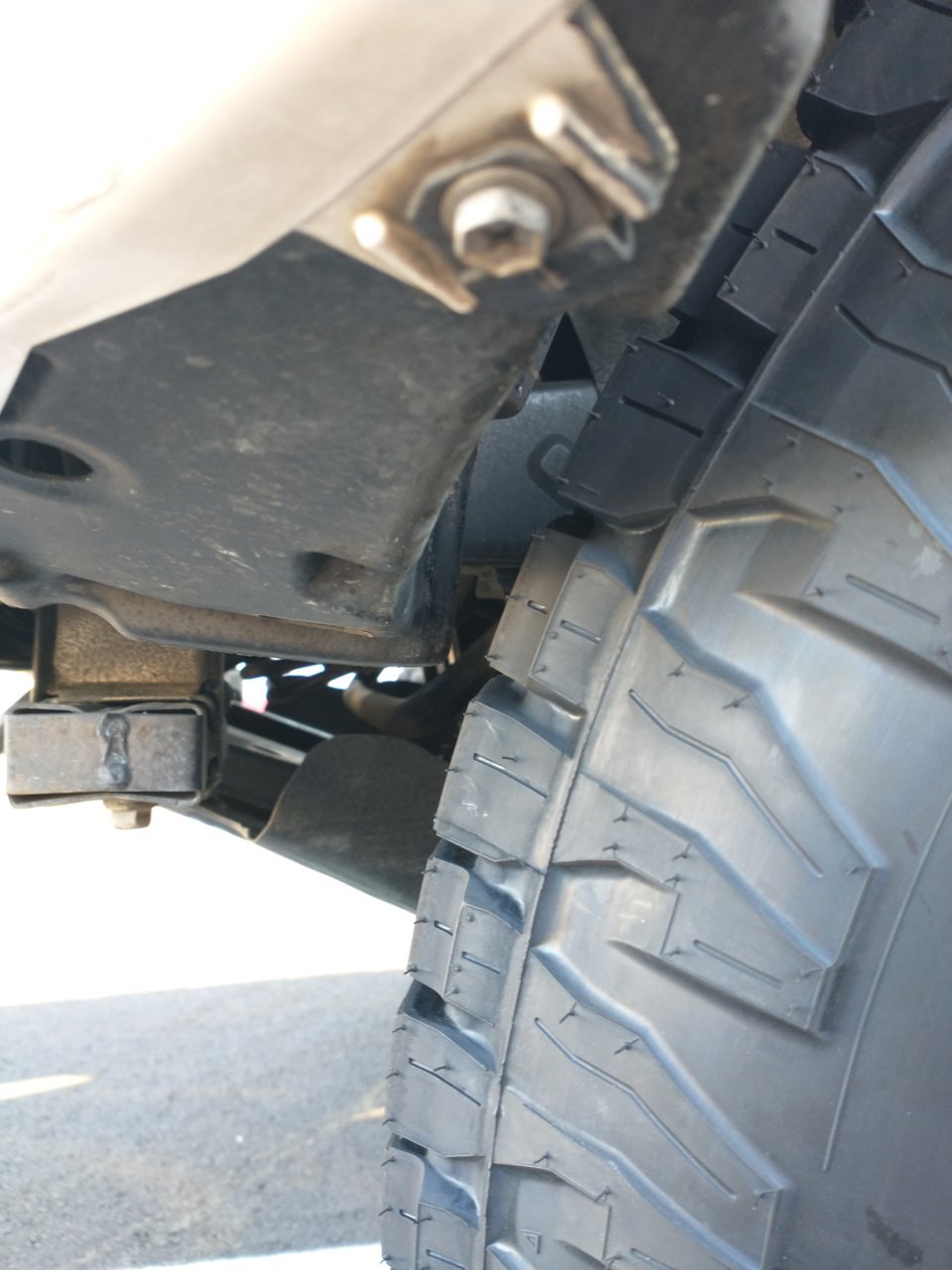

    Now that I have 10k miles on my 255/80r17 Toyo AT3 Tires on 4 runner SEMA wheels I figured I'd share my experience.
    Truck specs:
    Bilstein 6112 lift (2.5")
    5160 and AAL in rear (level with front)
    SPC UCA
    0.75" spacers on the front wheels
    Factory alignment specs with high caster (3°)
    On road/daily driving:
    Rubbed on mud flaps in the front over driveways/bumps. Also at full lock. Not severe but noticable.
    Off road (fast open terrain/small whoops):
    No rubbing on front/back after mud flaps removed.
    top of tire hit the fender flares and liner on larger hits.
    Tires at full stuff:
    LOTS of rubbing for front tires on cab mount, fender flares, fender liners and a little on the metal fender (top and rear of tire)
    Rear tires rub a little on fender liner.
    Solution:
    Removed fender flares, cab mount chop, aggressive heat molding for fender liner (front liners only), smashed down pinch weld, and very minor trimming of metal fender near cab mounts.
    Before CMC trimming at full lock.
    (Rear of tire and cab mount area)
    Front of tire and fender liner
    Fender flares removed

    I got under my truck today and to check out the rubbing a little closer and cycle the suspension. The tire just touches the top of the wheel well.
    I think this is from the bump stops being worn. They are cracked and pretty squishy compared to what I remember on my previous truck.
    As for the track width I was about 1.25" narrower in the front than the back after my 3-in lift (which settled to 2.5").
    I measured this by placing tape on the ground where the tread contacts the ground on the outside of each tire then move the truck and measured the distance between the tape marks.
