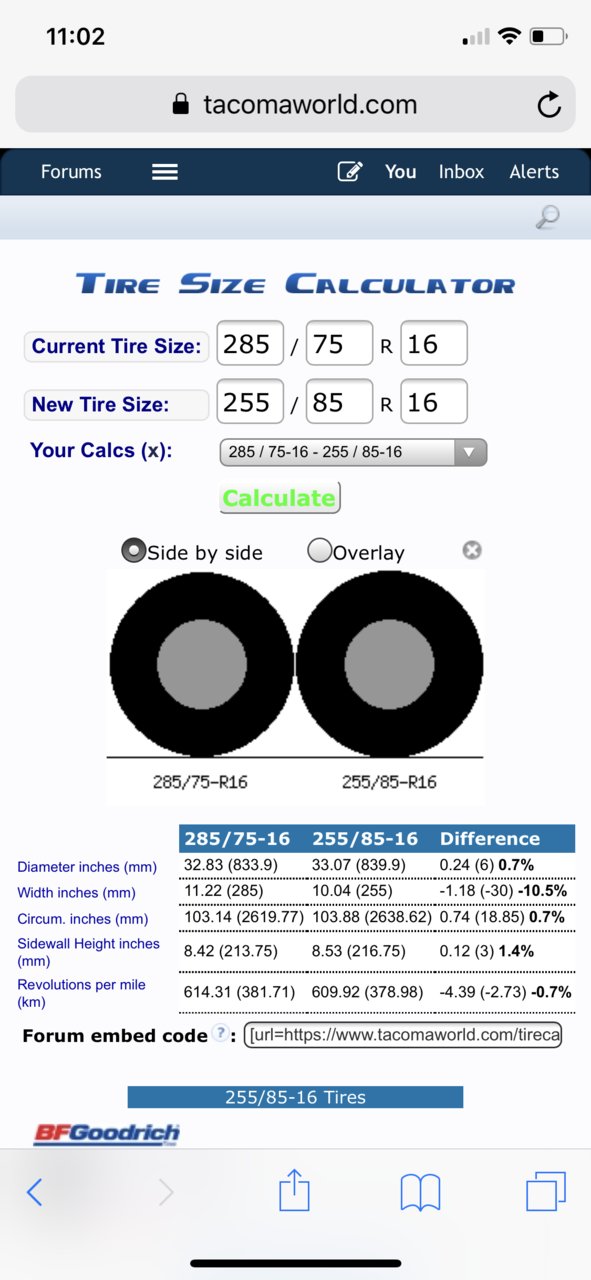

    Just goin by this

    All depends on the tire itself as true measurements vary per tire. You are correct that 255/80r17 is taller than 285/70r17 but when comparing two tires it's best to look at the manufacturers website.

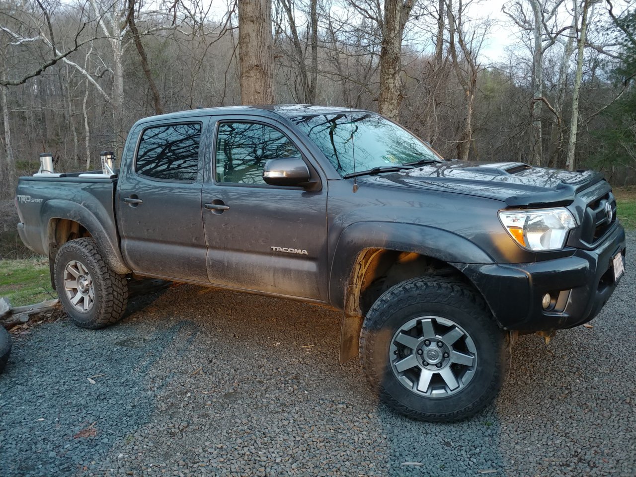

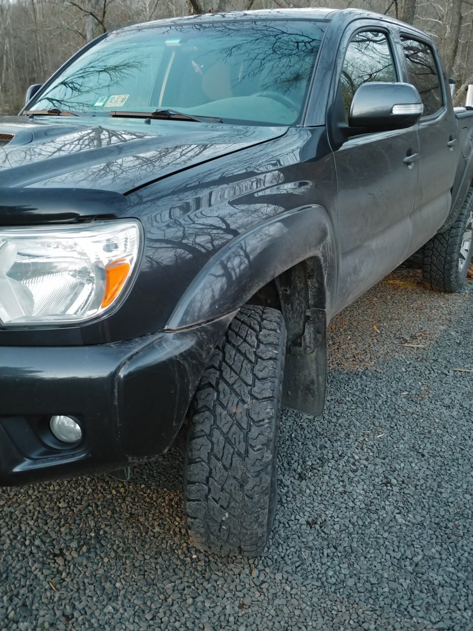

    255/80/17. On 4runner wheels, tires st maxx, just put them on and love them. No noticeable power loss, lost maybe 1/2 mpg from 16.3 to 15.7, but its quiet. 0330181941b.jpg 0330181941a.jpg

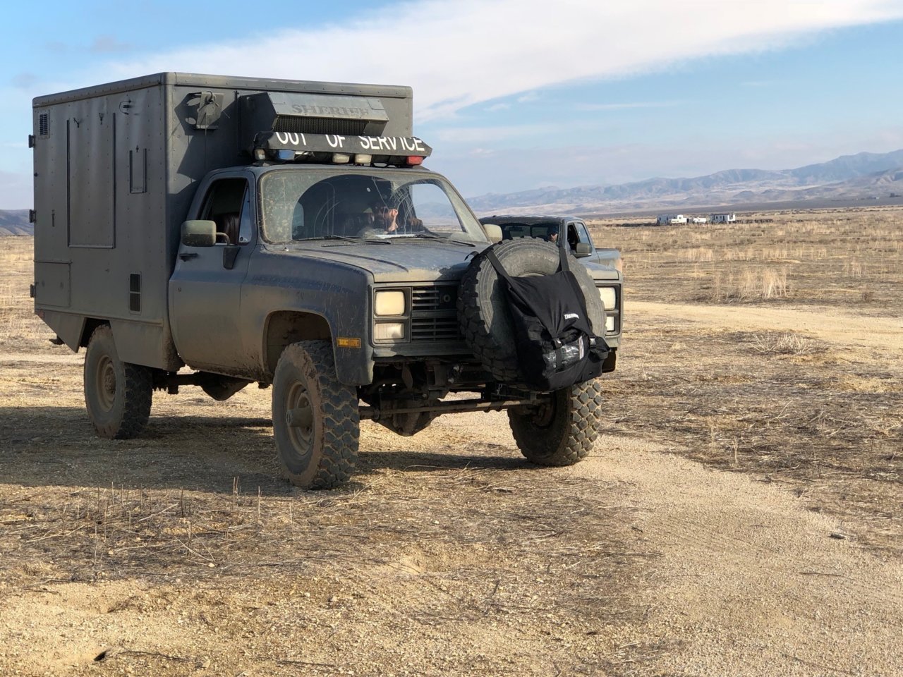

    I was looking at some Michelin 255/100r16’s but they are out of my price range. Would really like to see them on my truck though. Not sure I would want them, but they are super pizza cutters.
    36x10

    The XZLs? those things are wild, they're like tractor tires. I wouldn't use them on a truck that actually saw paved surfaces though - they're very soft, they leave rubber trails everywhere they go on pavement.

    My brother has those tires on his CUCV ... they are impressive. Not the best in the rain, but it only rains here for like two weeks a year. Considering some siping before next rainy "season".

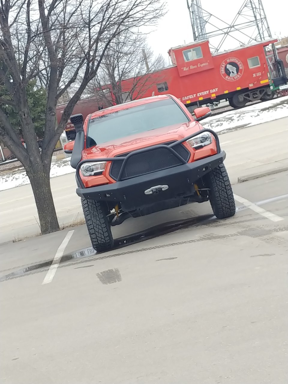

    255/80/17 st maxx o_O

    YOUR CAMERA HAS THAT TACO LEAN SETTING EH...

    Just a wee bit.
