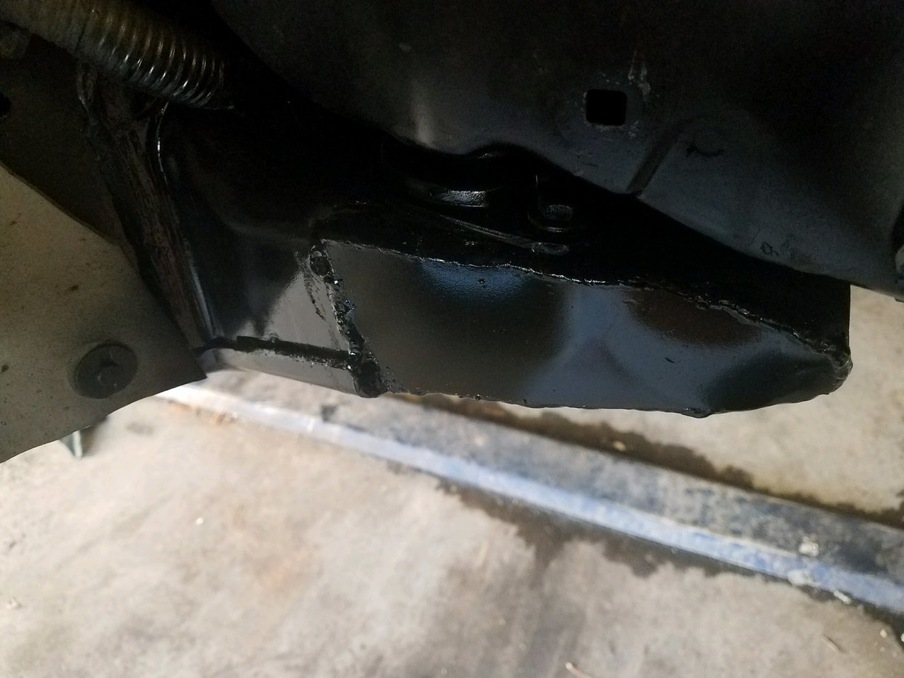

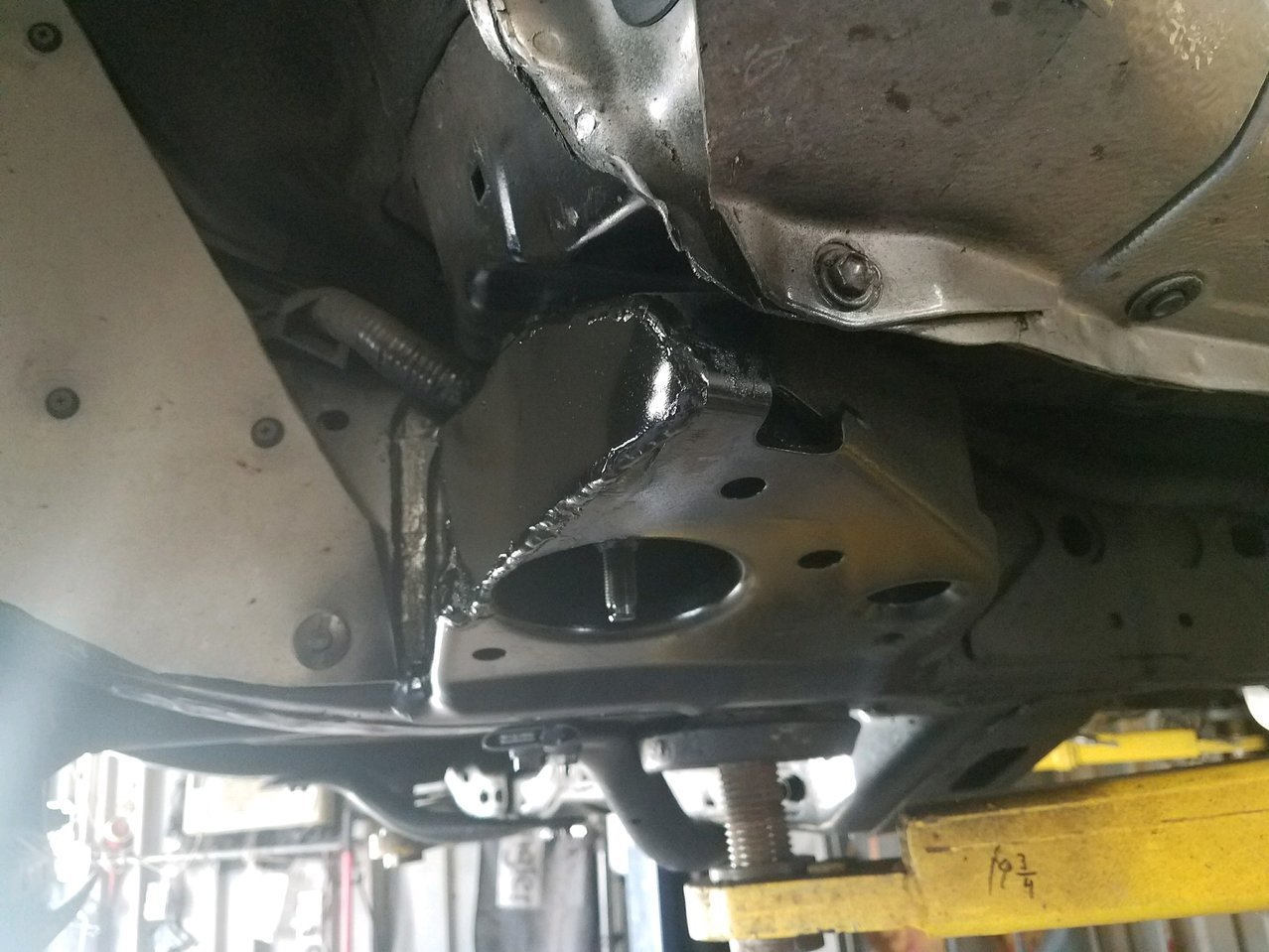

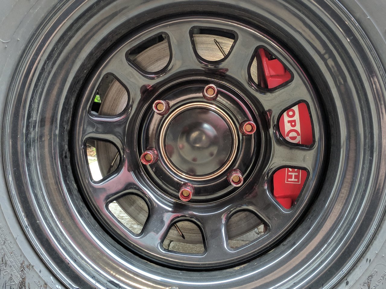

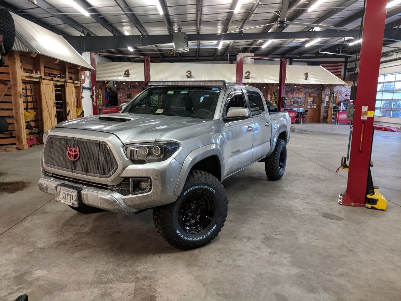

    And brakes from the back of the wheel. My brake fitment is tight in the front with the spacer in, wheel won't go on without it.IMG_20180128_121623.jpg I'm well versed on the subject, and it doesn't rub anymore after CMC 20180123_152840_01.jpg 20180123_152831_01.jpg

    I've got the same issis with the calipers. A lot of steelies need a small spacer.

    Yepp! I found that out the hard way... I was hoping that by ordering my wheels in a lower (more negative) offset would help but it has little to do with the offset of the wheel and more to do with the fact that alloy rims have a large built in hub for strength that sticks out from the rotor, whereas steelies are virtually flat and relatively very thin at their hubs. Either way, im happy now with the spacers in and ARP studs to support them!

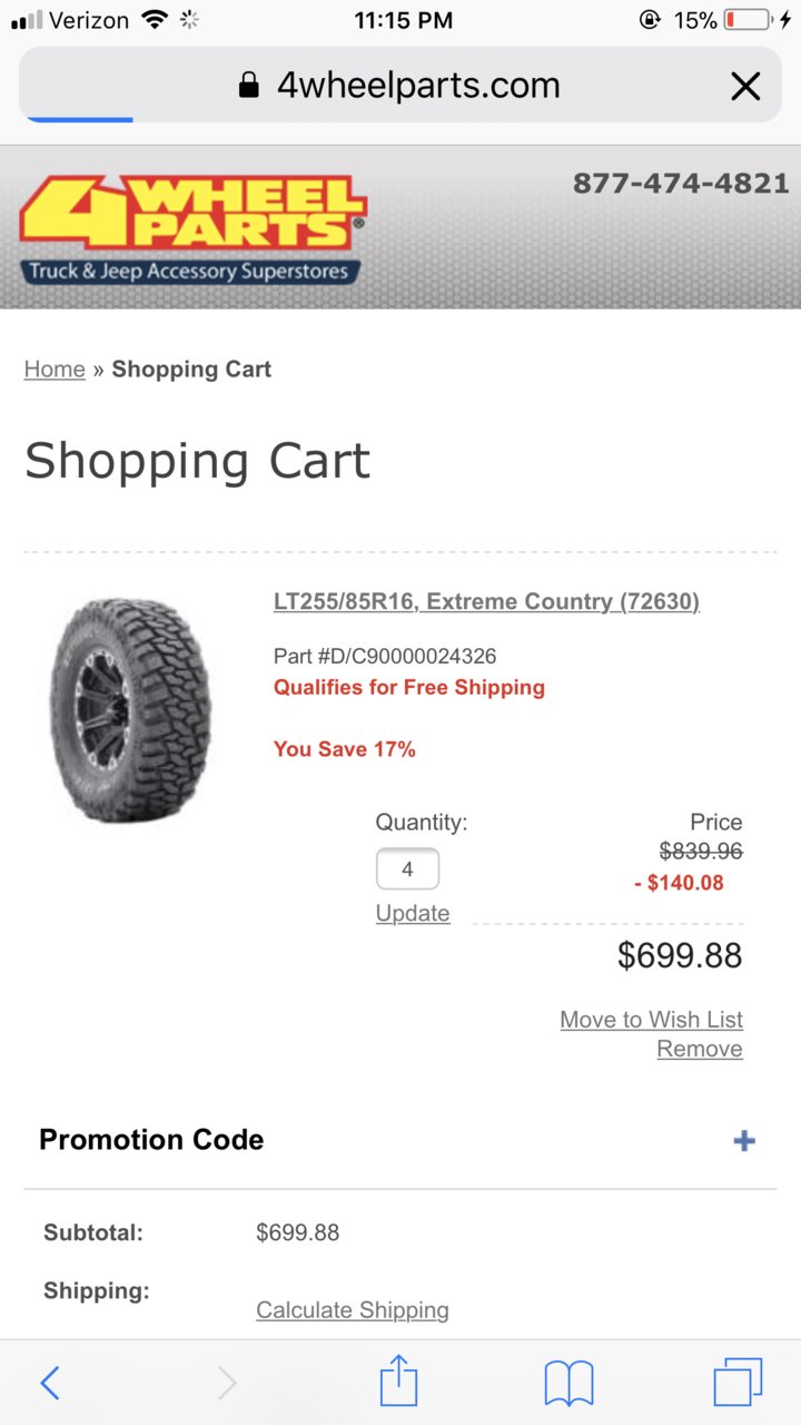

    Thoughts??
    Would I have any issues with rubbing while I’m without a lift? Or should I stick with 265/75/16?
