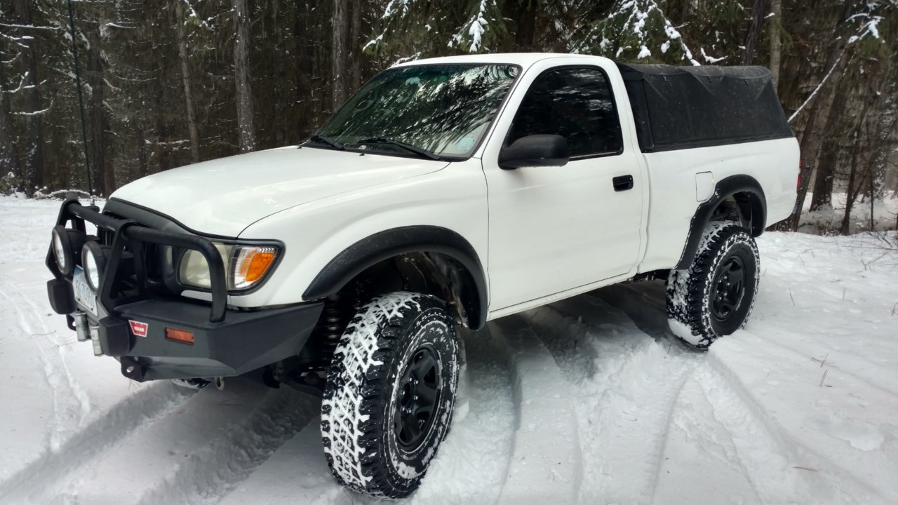

    Yeah I'm just holding out for the best here right now. Should probably just cut the dreams down and get 265/75r16 lol. Definitely planning on leaving paved roads. Thanks man

    You’ve got good taste in Tacomas, @Cell Block 726. Got any more photos of it with the softopper?

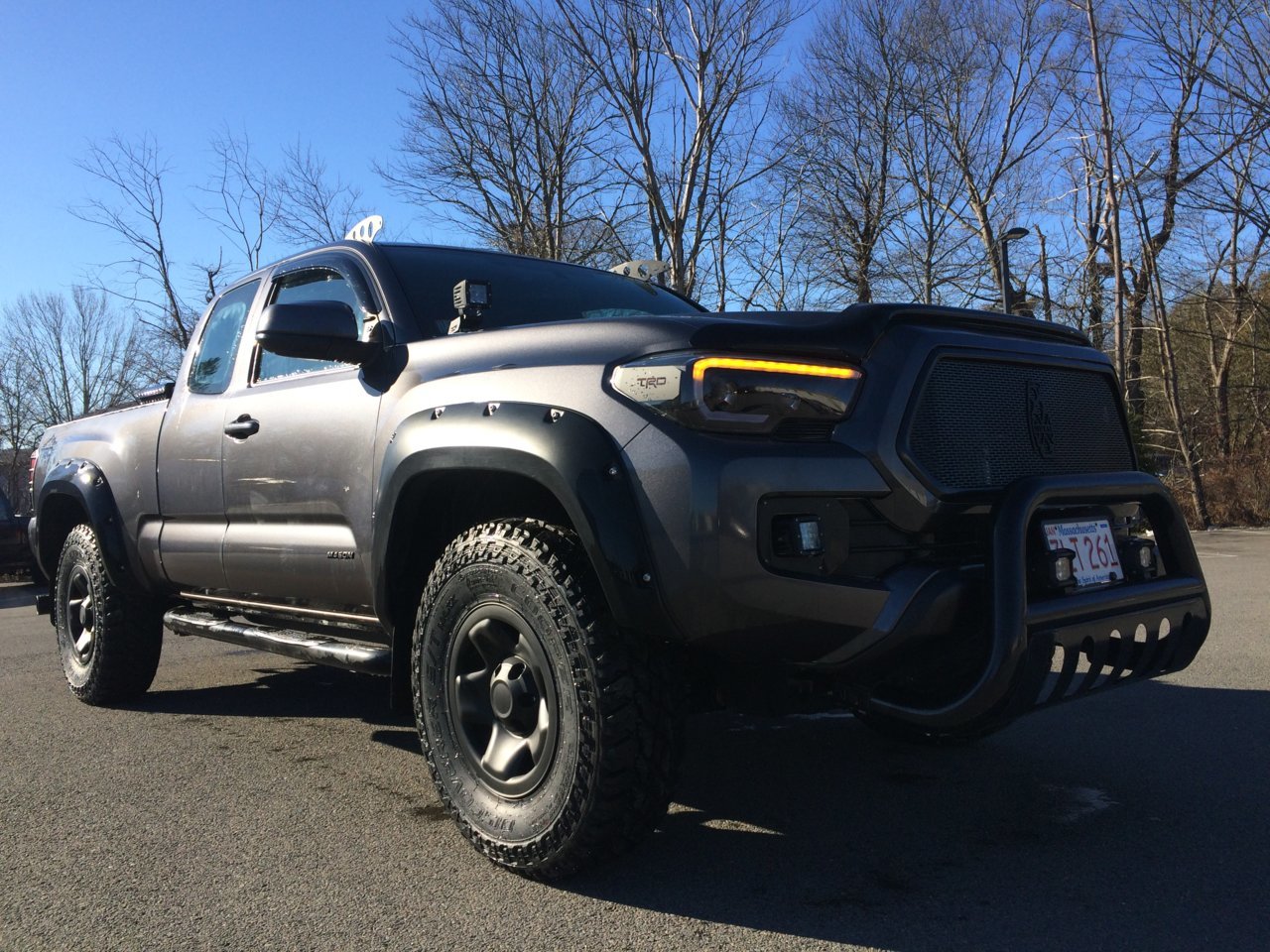

    2016 SR MGM ACLB 4x4
    255/85/16 Cooper ST Maxx 33s Midland CB Radio w/ A-Pillar Mount KB Voodoo Mid-Rise Bed Rack Bedrail-Mounted Headache Backrack OEMassive LED Sequential Headlights Tail Light Guards w/ VHT Niteshades Tint 50" Curved LED Cree Lightbar w/ MCM Fab Brackets 3" LED Front/Rear Lower Cube Lights (OZ Pods) 2" LED Fog Light pods (OZ Pods) MBRP Ditch Light Brackets w/ 2" OZ Pods Bushwhacker Bolt-On Style Fender Flares Rear EVO3 Bumper Guard Plasti-Color Flushmount Mudflaps Rear Cabin mounted Survival Bag/ Medical Kit Black 3" Access Cab Nerf Rails Black Powdercoat Fine Mesh Grill (Customgrills.com) Black Metal Grenade Grill Emblem Insert 2" Black Receiver Hitch w/ Pintle Hitch or D- Shackle Black Aluminum 21" Toolbox Interior Black Leather Seat Covers Weathertech Window Visors Weathertech Hood Bug Deflector
    255/85/16 on stock SR with Steel wheels. No rub at full crank or full flex.

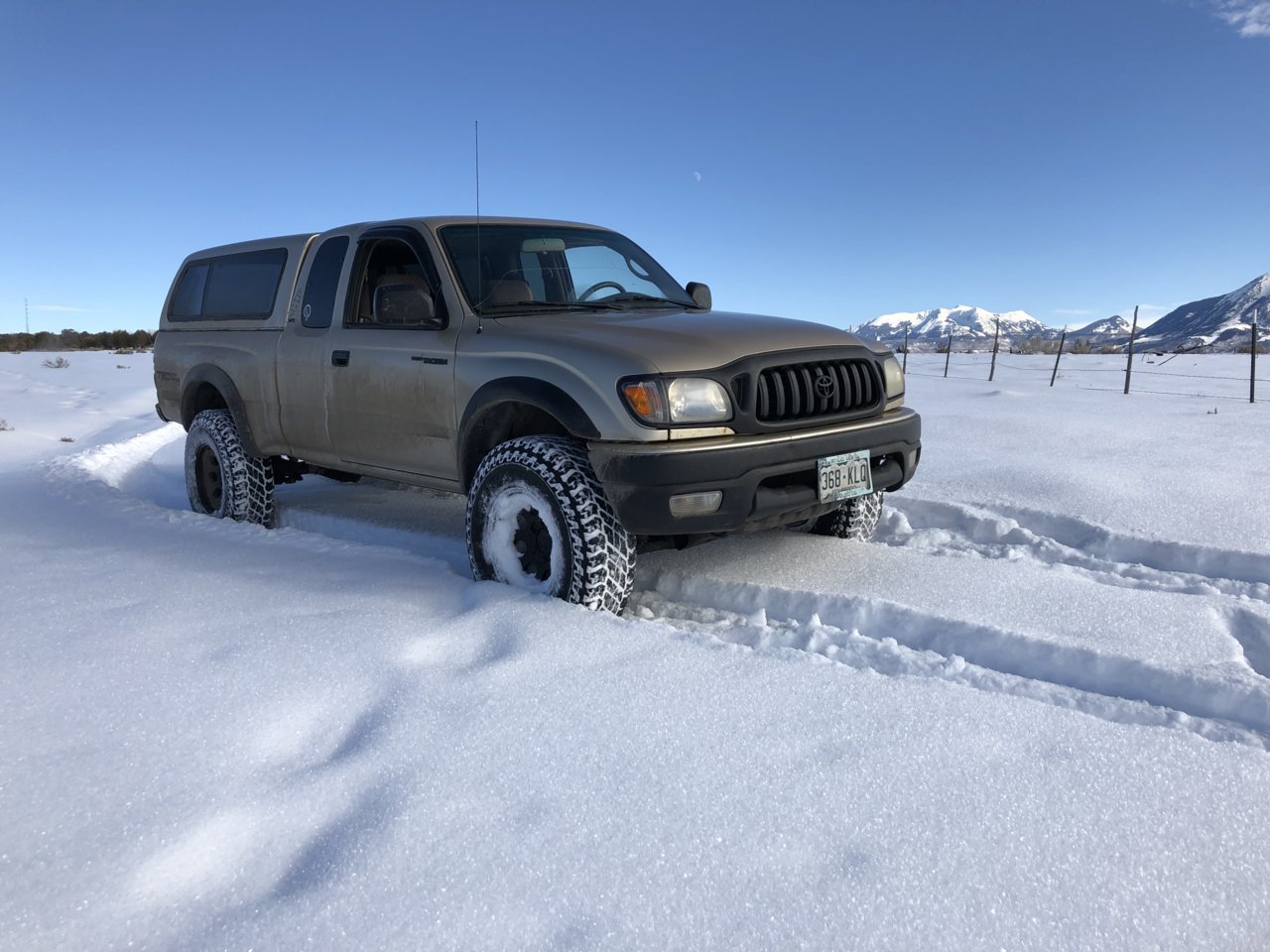

    2004 Gold Ext Cab TRD 3.4L V6 Manual
    255/85/16 BFG KM2's, 3" OME lift, Dakar's, Nitrochargers, Grey Wire Mod, ARB Bumper, ARB CKMA12 air compressor, WIts End Pacifier, Warn M8000, Uniden 520 XL CB, rear diff breather mod, full time power to aux 12V outlets, Rago Fab ditch brackets, Titan Rod Vault, Extreme LED's front and rear,
    gotta lift it
