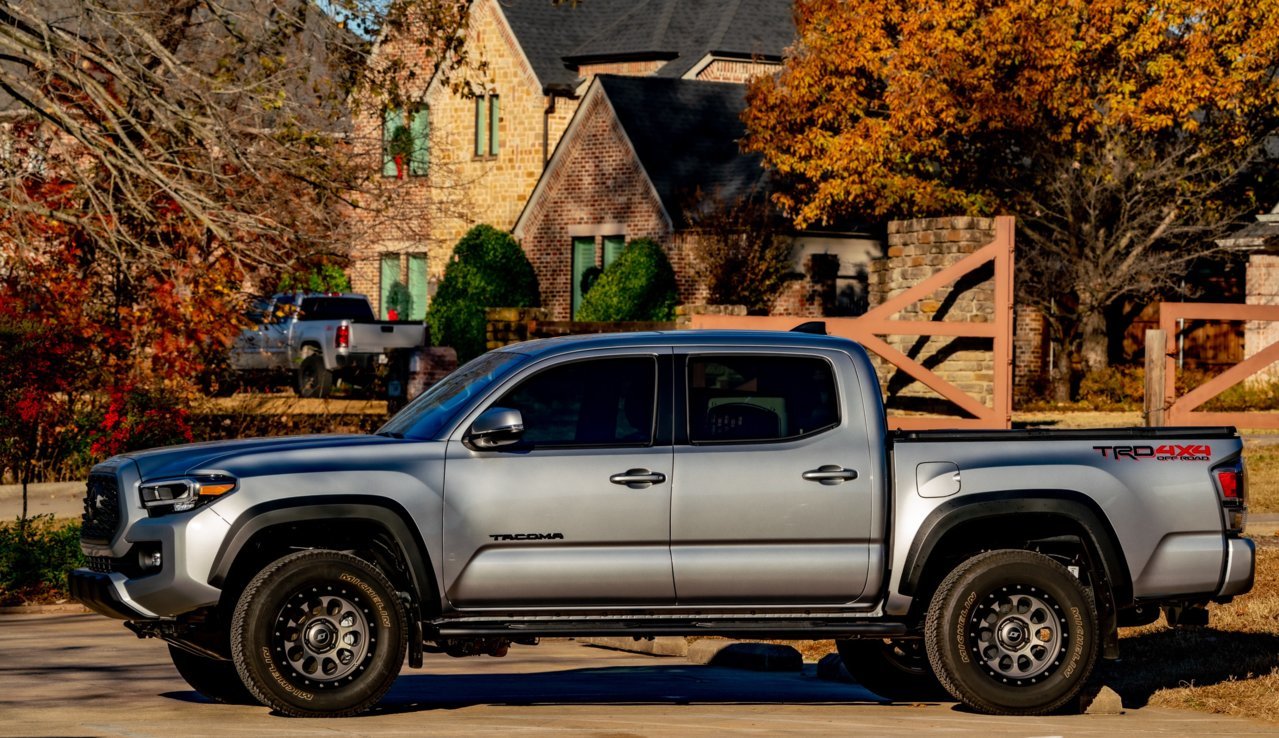

    Hello,
    Recently put some 17” Ray 10’s on my 2021 Tacoma Offroad. Stock shocks and height. Michelin LTX AT2 size 265/65/17 tires. I have the -10mm Ray 10.
    The front tires are rubbing slightly on the Weathertech mudflaps.
    I thought the 30.6” diameter tires weren’t supposed to rub.
    Thoughts?

    it's your wheel, the width and -10mm swings the tire at a longer arch, so rub rub .. basically too little of backspacing

    Generally speaking, you will always have to remove the front mud flaps to avoid rubbing.
