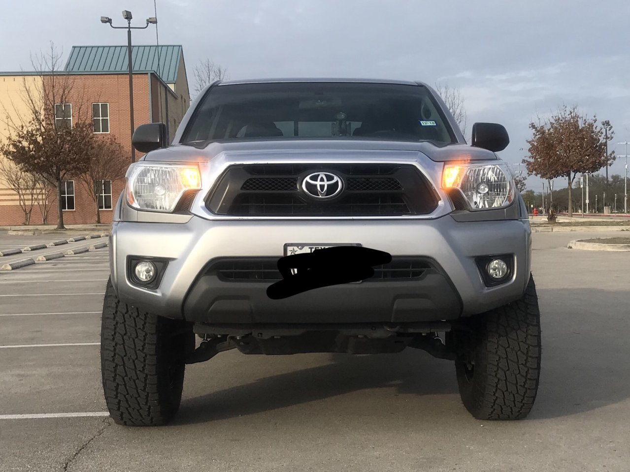

  11. Jul 16, 2019 at 8:30 PM
    #31
    gotoman1969
    gotoman1969 Well-Known Member
    May 30, 2018
    #254966
    7,015
    Steve
    San Antonio, TX United States
    2015 Silver Tacoma PreRunner
    3" ToyTec coilovers, JBA UCA's, Bilstein 5100's
    17x8.5 -10 offset. 285/70/178961ECCF-E561-4A99-9A9C-94A180123492.jpg
    98_3RZ_NIC, ItsJustJ and JRH_Tacoma like this.
