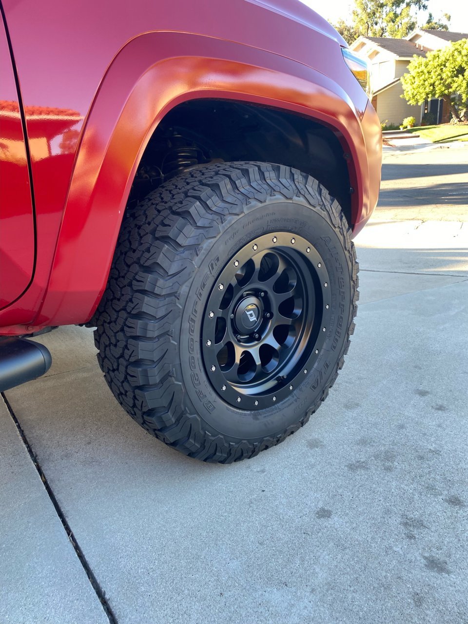

    Hello all! First post here but I've gone through countless threads to end up with the options I've went through so I'll go ahead and list what I've got. So after deciding on tires and wheels I wanted, I ultimately kept coming back to this specific thread to determine what my fitment would be like. I have an unlifted, stock 3rd gen 2020 TRD 4X4 off road with 265/70/17 BFG KO2 load range C for my four tires. The wheels I went with are the Method Race Wheels MR703, 17x8.5 with 6 on 5.5 Bolt Pattern - Gloss Titanium with a 0 offset. I knew going from the stock wheel offset of +25 to a 0 as well as getting about a .5 to 1 inch larger tire would change some things. From what I read, I thought I would be fine. For the most part I was. However, without messing with the alignment, this setup DOES rub albeit very little. I couldn't tell what or where it was exactly rubbing but it would occur when I had the wheel turned. This was simply fixed by removing the mud flaps, which I don't mind for the moment being but I do look to put them back on in the future. I was told by the people at discount tire to steer clear of messing with alignment because this could bring a whole other slew of problems. Also as side note, if you're looking to change the spare tire to match the new ones you're getting, you're going to need the same size wheel to fit under there and can't use the existing 16" steel wheel currently under there, as this wouldn't fit a 265/70/17 per say. Just a side note, because now I know I should have bought 5 wheels instead of 4 because that 5th would be in use with the spare to be put under the bed of the truck. I'm assuming this is how it works, but haven't done enough research to verify I could fit an aftermarket wheel onto the spare and store it underneath but pretty sure this is how it works. Leave any questions and I'll do my best to respond as I've learned this process of fitment, wheels, tires, rubbing, lifting, etc. is such tricky f'n business. I was not a car guy before owning a Tacoma too lol but I have a better idea of what could work and what probably doesn't just from researching threads here. Photos attached, know they're not the best bc I snapped them quick in the parking lot of my school. IMG_1693.HEIC.jpg Have a good one IMG_1691.HEIC.jpg

    Eibach Stage 1, 17x8.5 Ray 10s, 265/70-17
    Welcome to TW. You can run the same diameter tire on your 16" spare steelie if you order a 265/75-16. it will be the same 31.5 or so inches tall that your new 17s are. I ran into the same issue on my 19 OR with rubbing. 17x8.5 O offset KMCs on 265/70-17 rubbed on flaps most noticeable turning in reverse. I lifted it 2" a few days later no issues now

    Icon Alloys Rebound Pro 17x8.5 0 off set with Mickey Thompson Baja Boss A/T 265/70R17 (Load XL) Revolver X4s Tonneau Cover
    Dang, no matter how much I search I always miss a post already made. I went with Icon Alloy Rebound Pro's 17x8.5 0 offset and put on Micky Thompson 265/70r17's. I've noticed that when it's clocked all the way to the left and I hit a dip I rub I believe on the UCA. Normal street use i'm fine. Anyone else rubbing at all?

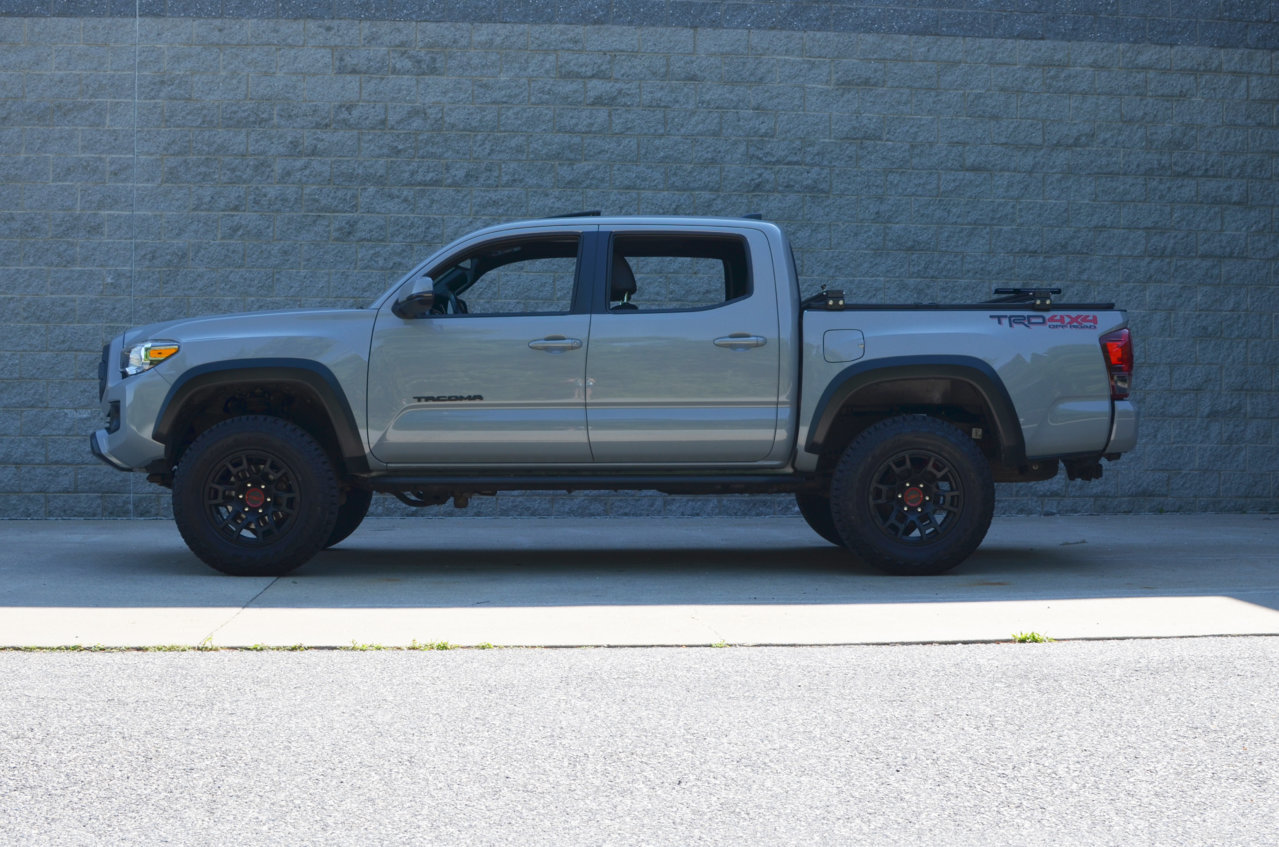

    17x8.5 +0 on 265/70/17 Goodyear UT's

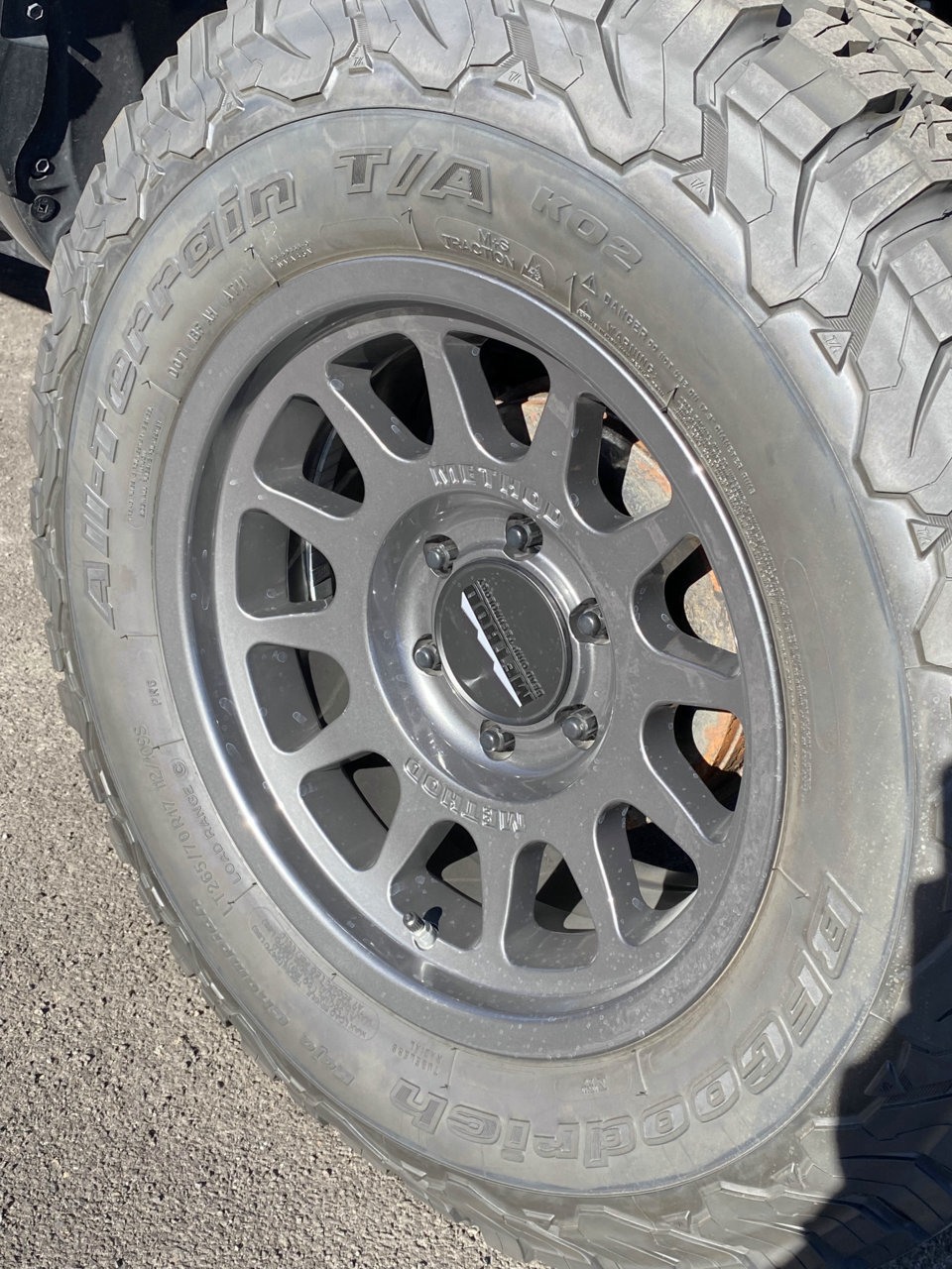

    [​IMG] Just ordered my Method 707s in a 17x8.5. Got in on the 15% off sale that ended yesterday. Any suggestions for best prices on KO2s?
