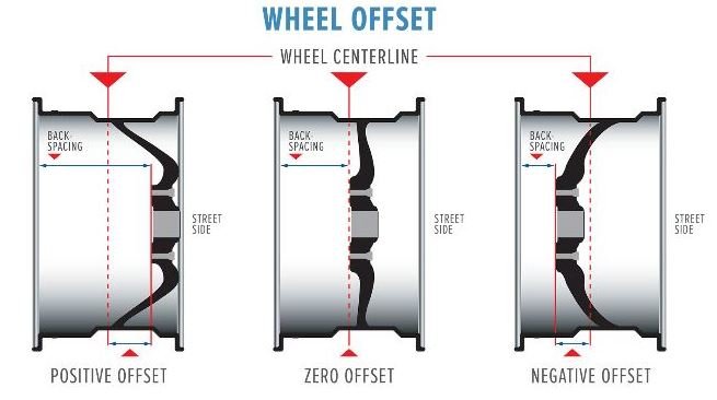

    This is a top view of what higher offset does...
    It puts more tire on the outside of the point on which your tires pivot.
    The blue(stock) and green(higher offset) represent the different radii of the arcs the outside of the tire follows.
    The larger radius follows a greater arc and thus more movement forward/backward in the wheel well.
    Skydvrr, Rainoffire, Junkhead and 3 others like this.

    Stay away from spacers! All they're doing is opening up a can of worms for your front end. Do a quick search on why wheel spacers are bad and you'll see why. So with the TRD wheels they have a positive 4mm offset with 4.15" of backspacking. Think of the spacer as being part of your rim now, you then add 1.25" of wheel spacer to it pushing your wheel out is now a HUGE difference. You've essentially changed your positive 4mm offset to a negative 27.75mm offset and reduced your backspacing from 4.15" to 2.9". So that sticks them out there quite a bit but now you run into the same issues as running a wider tire. You don't have the issues on the inside like frame contact or control arm rubbing but you do with the outside of the tire. Take off the spacers and either learn to live with how far it sticks out or buy wheels with a different offset would be my recommendation. I hope this helps!

    By moving your tire out you've increased the scrub radius when you turn your wheels. This means that your tire is further back in the wheel well when turning. I put 265/70/17s on a 9x17 -12 wheel and leaving the shop the rub sounded horrific on even small turns. I got home and got out a dremel, heat gun and a baseball bat (I like the shape and leverage of a bat for forming plastic). You can probably eliminate 90+% of the rubbing in 30 minutes.
    First, there is a hard plastic chunk/nub/corner at the bottom of the liner. Cut that off, it should only be like a 3 inch cut taking off about 1/4" of material. Next, grab the heat gun and evenly heat the plastic liner. Push it back with a 2x4 or bat or similar. You need to reshape that liner so that the form stays put and it gives more room. Finally, chalk up the inside of the liner and fender. Get it good a chalky. Then drive around the block making sure to turn and rub. The places the chalk rubs off are the places you need to continue to reshape.
    I imagine you will have a small spot on the fender where you need to decide if you are moving material or removing the spacers. Chalk (or mud) getting rubbed off is the key to finding your problem spots. You may also find a spot under the liner that doesn't reshape because there is a metal seam behind it. That is a pinch weld and it can be flattened if needed.
